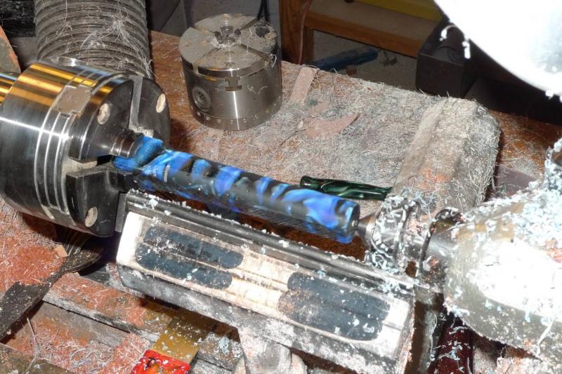

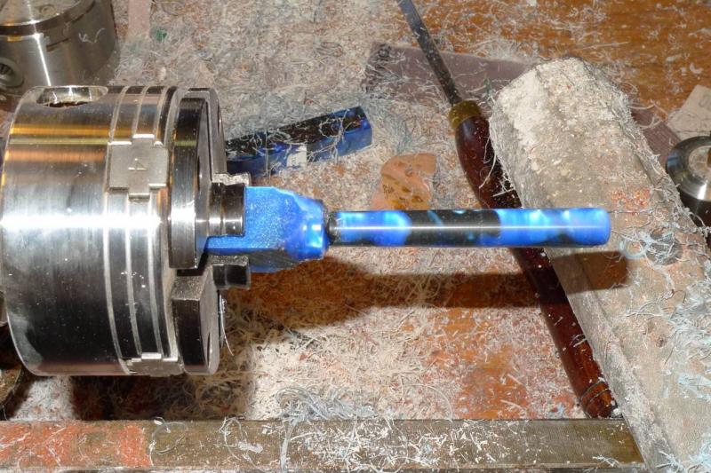

1.I chuck up my blank, turn to desire shape, sand, part off.
Then take to my drill press, use a #31 drill bit and drill hole for threaded rod.
Your center point is allready marked from the dimple on your tail stock.
Then tap a 4mmx,75 thread, these taps are readily available, not have to had custom made. epoxy rod in, make sure it is seated far enough in. Sand the parted end and buff.
