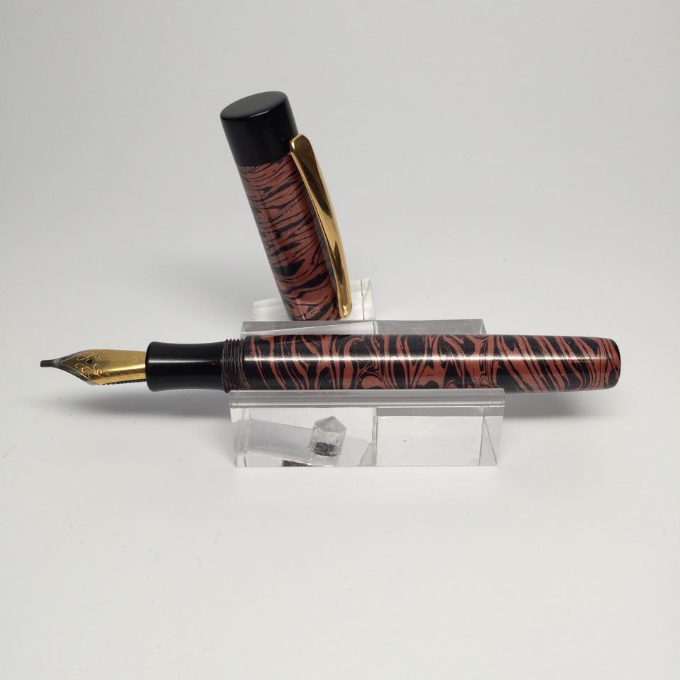

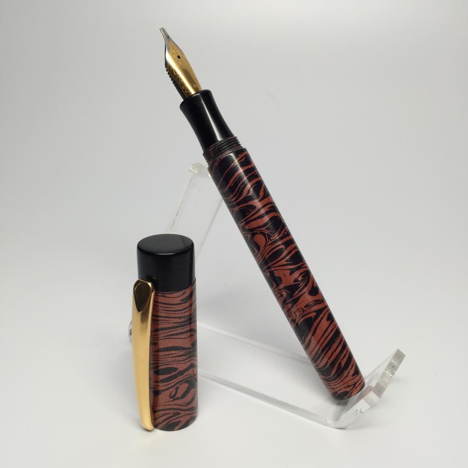

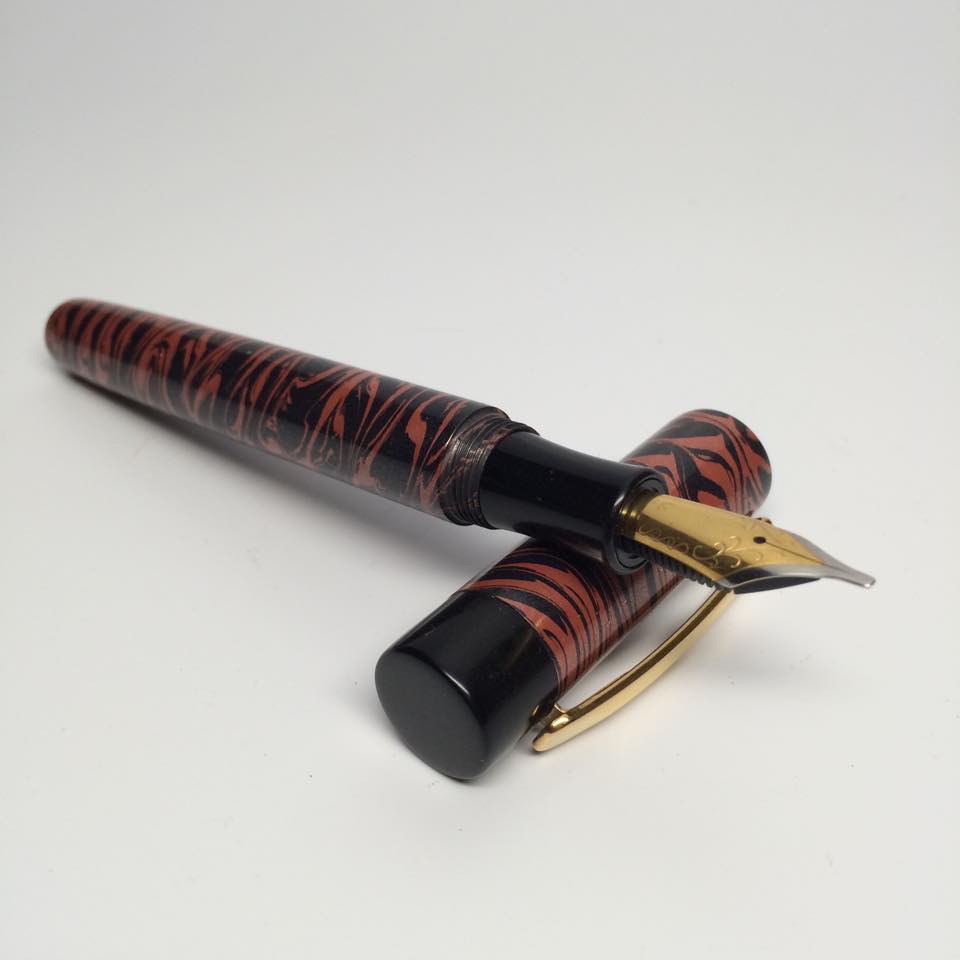

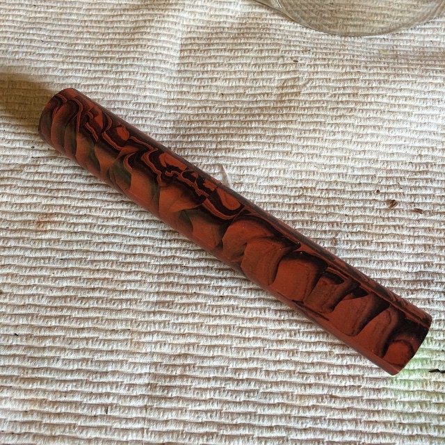

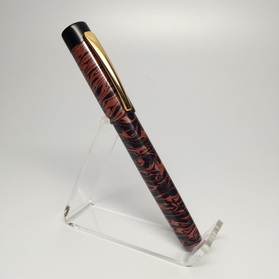

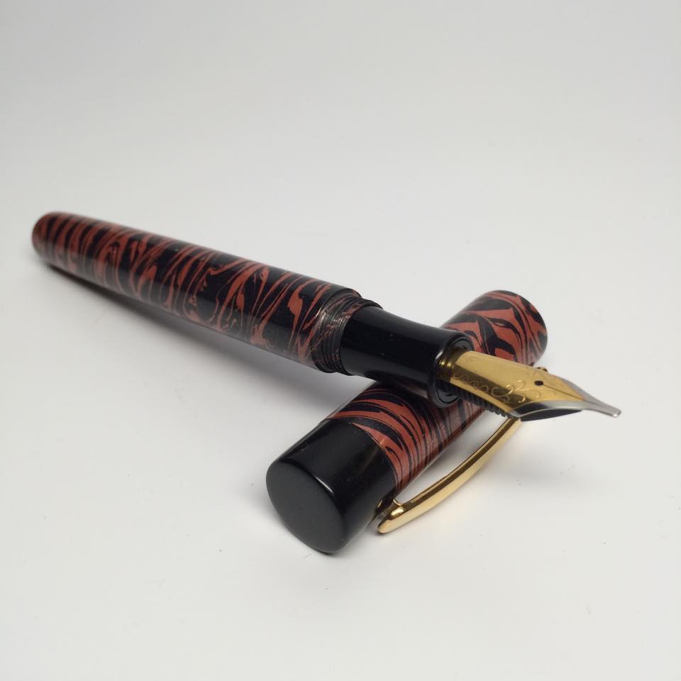

My first go with the new M3 Titanium Mokume material. This is the red/black although Chrissy keeps arguing with me that it was mislabeled and it's really pink/black. The blank is definitely red/black but it did seem to make the red a much lighter tone during the turning/finishing process.

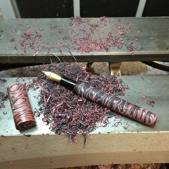

It turns very easy and finishes just as easy. Sanded with 400/600/800/1000 and then to the buffer.
The material takes threads very well although I'd adjust my next one to use a 9mm section thread with a 12mm body. The 10mm section and 12mm body left a 1mm wall thickness all around and instead of giving like alumilite would, it cracked with almost no pressure. So definitely keep a bit of wall thickness on your threads.
I managed to get a kitless out of a single blank but did have to use ebonite for the section and finial to make it stretch.
