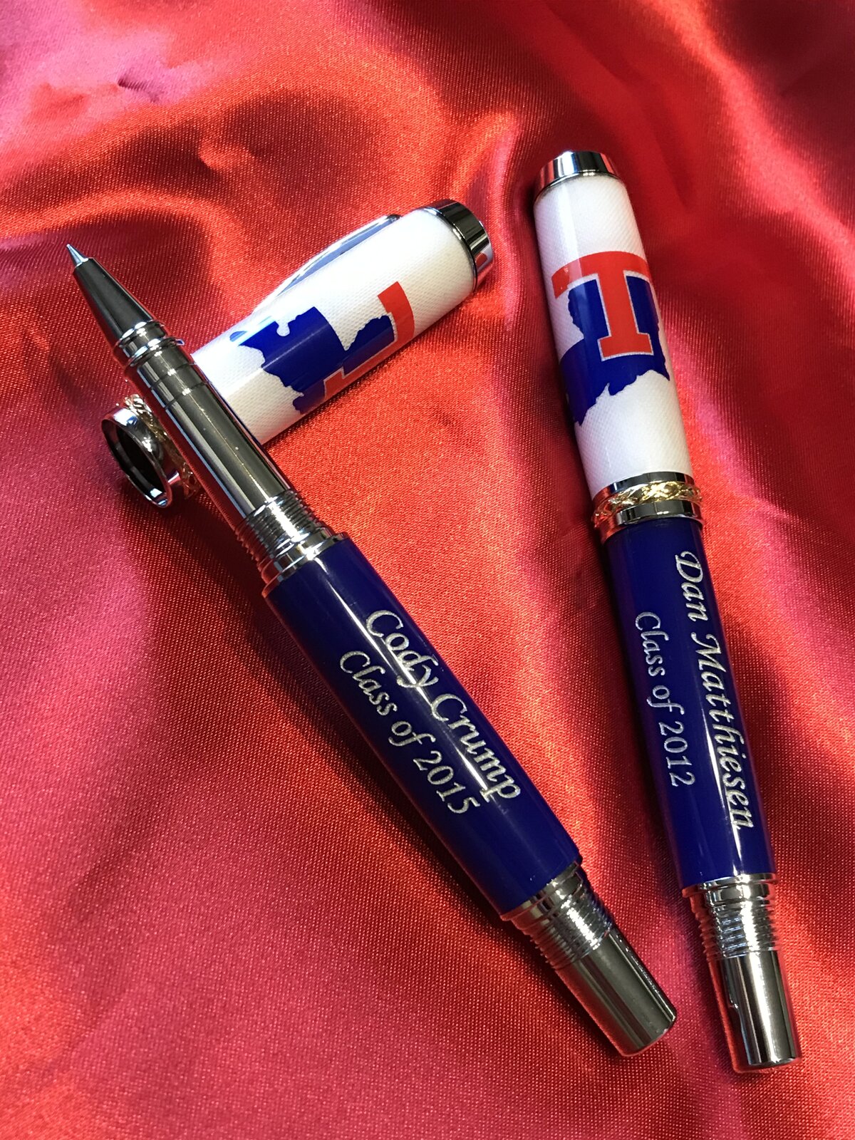

My son wanted these for som coworkers. Finally had a chance to get the engraving done and pressed them together. The cap is vinyl on cloth and the pen is a store bought acrylic blank. I'm surprised and pleased with the way the pen blank matched the blue vinyl in the cap. Questions and Comments Welcome.

slightly confused by "vinyl on cloth "? So is it an emblem that you then resin impregnate or spits coat/ soak with CA to finish?
Like the look and concept a lot. Colour match works really well

I like collor combination, looks great!
Ian. I use the same iron on vinyl that they use for tee shirts and caps. I have a Silhouette Vinyl cutting Machine that I cut the logos out with then iron it on cloth that I buy from the fabric shops. Then I'll wrap that around the brass pen tube and cast. I really like the look of the cloth over the paper.
