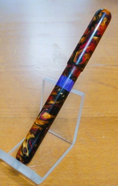

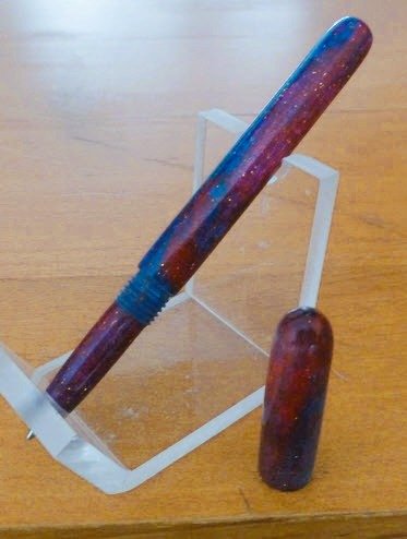

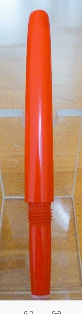

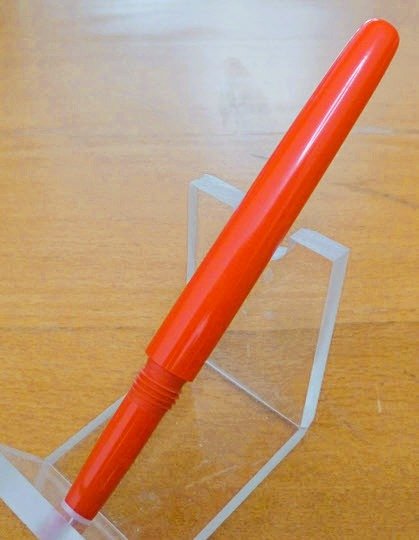

Finally a complete pen all from the same material. Since my last posting I have been trying to make a complete pen using Poly Resin. The upshot after using 20 blanks is that I have made several decent desk pens. I hesitate to say that anything is impossible, especially here, but Poly Resin is not user friendly for making bespoke pens for several reasons, which I am sure are well known here! It does polish very nicely. So, I switched to Acrylic, and attached is the completed pen. The 2 sizes that I used are M7 and M10 to create a fairly slim pen. I am not completely happy with the alignment of the cap and body, which is no doubt to some extent due to not using a tailstock die holder. Will need to negotiate with the "home boss" :). I am going to try some Alumilite next, which I believe is quite user friendly for this purpose.

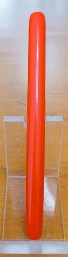

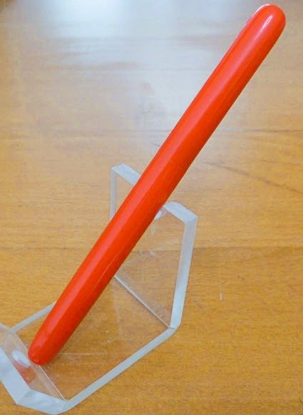

First kitless Alumilite turning using a home made blank (see attached). It uses a Cross style refill. I noticed that many kitless makers use their own blanks. They are typically round and 8.5 to 9" long. Otherwise you need 2 regular sized blanks. Âľ" sched 40 PVC plastic pipe makes a good mold. I made a couple of plain color ones by way of an experiment, ie. can I get the blank out after "cooking" in the pressure pot. Although the urethane mold release basically did its job, a spot of BF&I (brute force and ignorance) was required to get them out. Flush with my success, I made a more elaborate blank mixing 2 different colors and some "sparkles". When you make square blanks in a mold, mixing is fairly simple, but not so simple with a tube. Basically, I just guessed, but I would like to be a little more "scientific" in future if possible. I watched some utube videos but none so far have given me a warm and fuzzy feeling that some science was employed. If anyone has some "magic", I would be grateful for the technique. Of course, I could make 9" long square mold and use that, but starting from round is a great time saver.

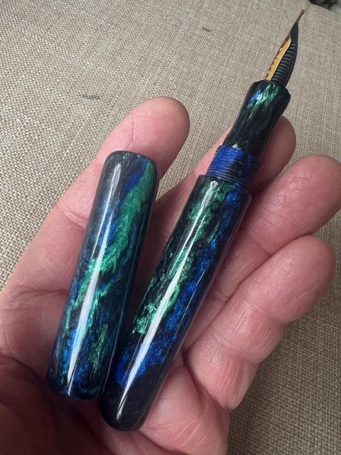

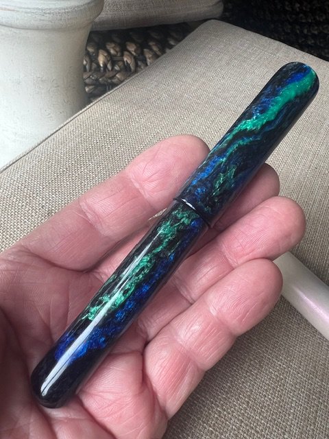

Here is one of mine in Alumilite

I pour my own blanks for my custom pens - I use a couple different resins depending on a few factors. Alumilite is not the greatest for its tolerance to UV light - it yellows a bit faster than I like, making the pen look old and dingy. When I need dead clear for ink windows or similar, I have used Liquid Diamonds with some good success. However if you are going to do any coloring or mica additions to the resin, the Liquid Diamonds is REAL slow to set up which is an issue with my vertical pours. I've just tested the resin Tim McKenzie uses for his Diamondcast blanks and like it a lot instead of Alumilite, but it is a bit more fussy and is a little more chippy then Alumilite, so need to take some care both casting it and cutting it. I'm most inclined to stick with resin from Tim or his supplier, as I understand he is no longer selling it as a distributor.
As @Aurelius said, using a thin brass rod to do any swirling or color pulling in a vertical tube works well. I cast in both 3/4 " PVC pipe and in gang silicone molds from PTownSubbie. Just be sure to use the right mold release to make it easy to get the castings out! Temperature is the key to making sure you get color separation and swirling in your blanks - the longer you hold, the better the separation.
As for the tenons and threading. I use a tenon cutter from Jim Heinz, available through Turners Warehouse, that makes tenon cutting a breeze. I also use a Niles Niche die and tap holder system to keep everything aligned, but I also hear that Rick makes a really nice one available in our vendor lists. I've used the taps and dies from the last group buy here so far and just got into the last one that just closed for some more sizes. Rick also makes a great section mandrel that will reduce your breakage when turning the section. Good Tools help!

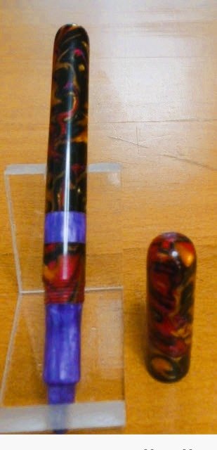

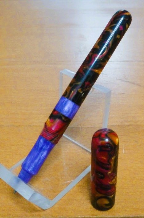

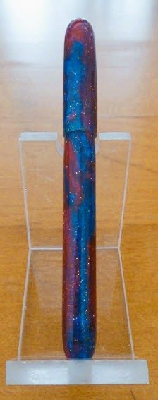

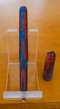

Pen with a "journey". As part of taking the next step I wanted to make a better shaped section and to use contrasting colors. The purple material is from an Alumilite blank that I made. The rest is Pearlux Alumilite blanks made by William Wood-Write. Everything was going well until I lost some threads while parting off a piece. It was my own fault for not being careful enough. Now I was stuck because I hadn't enough material to carry on as I had originally intended. So I had to improvise by joining 2 Pearlux pieces together using a piece of the purple material, which added a lot of work and time. Not sure if like the result, but I did complete the pen. I really like the Pearlux blanks, and hopefully the next one won't be so troublesome!
