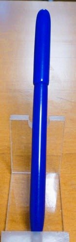

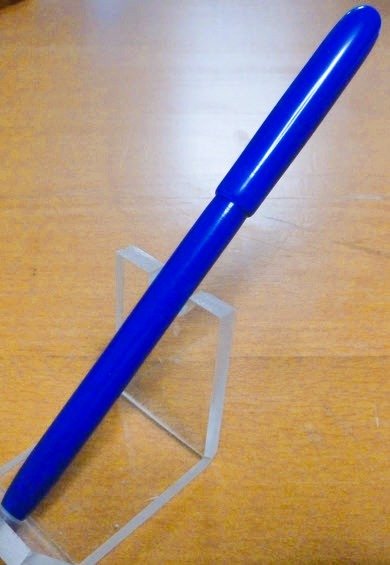

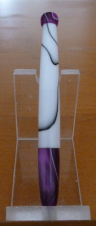

I took the advice to watch some of Bob Blanford excellent videos, and decided to try his "Bespoke on a Budget" to get started. After the expected initial frustrations, I have managed to make my first very modest desk pen (see attached). Like many of our activities it didn't quite turn out as I had originally intended! For example, I got too thin on the end of the body and it snapped off. So I had to improvise and make a cap. Also, the nib sticks out perhaps a couple of mm to far. I tried to "make do" without making the mandrel that Bob recommends, and that was the source of some of my problems. Lesson learned. I will get it right next time.

I look at it this way - you successfully brought the pen to completion - yes, maybe a few design challenges along the way but you did it! There is a lot of broken pen parts in a bucket near my lathe from things that went boom, despite my best efforts - I count them as learning experiences!
Nice job! Keep it as a progress measure.

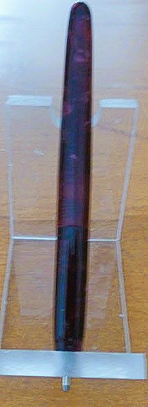

My Quilt Pen - I have been "trying" to make a "bespoke" pen with a cap for the past few days. There were many occasions when it nearly made it into the "garbage bin". However, recognizing that you often learn the most by fixing your mistakes, I persevered, and did get to the end. In the process I ended up with my Quilt Pen, being made up of various pieces to fix my mistakes. It isn't pretty but it is a bespoke pen with a cap. I doubt that anyone would set out to make such a pen!

Congratulations on powering through that first pen! My first kitless was also a mutt.
You wan watch a zillion YouTube videos, read everything available here, and talk to may makers, BUT you will learn the most by making and more from the challenges than the ones that go smoothly.

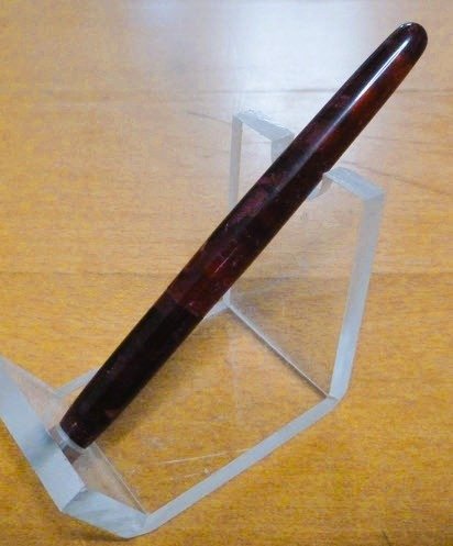

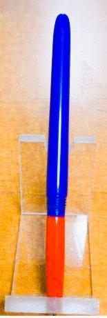

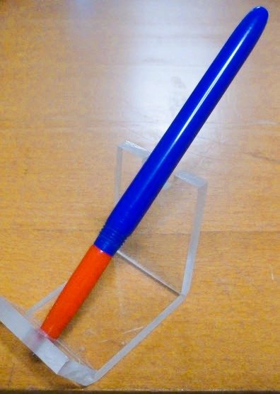

My next effort was to try and go "slimmer" to improve my plastic turning skills via a desk pen with Cross style refill. Slimmer also means thinner in places, which brings its challenges. Still learning what you can get way with and what you cannot. I used M8.1 to join the section to the body. M7.1 would have left more material for the body but less room to drill an accurate 1/8" hole into the section. I might try M7.1 on my next one.
Nice work on both pens! I'm also trying to figure out 'just how slim' I should go on the body and cap. I was exceptionally lucky to have spent a few hours with Jim Heinze at the recent MATE event and that is pretty much what both of us worked on together - really overcoming my fear of the whole thing just being to flimsy, while still keeping the pen light and with good hand feel. My second task given to me by Jim was to make it solid, thin and postable - which added a whole new aspect to the design. I succeed with one, but it too was a bit of a 'quilt' as it took a few additional inches of blank stock to redo both the cap and the body due to some failures. Going to keep at it so I can do the third set of tasks - adding a clip! Who said this wasn't challenging?????

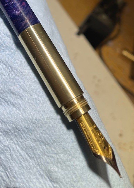

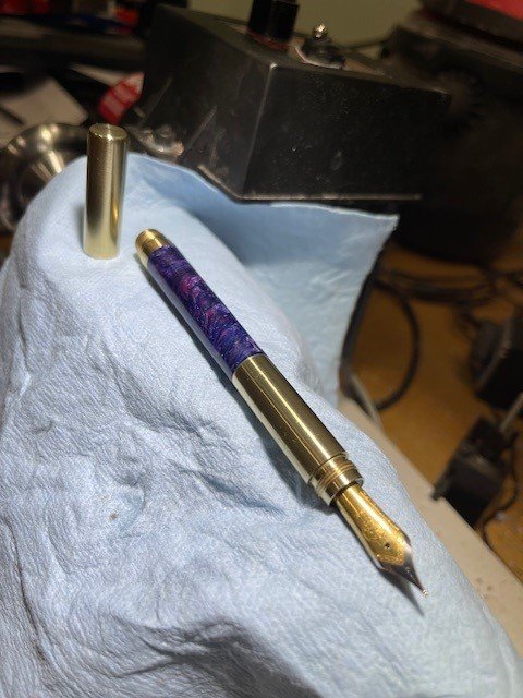

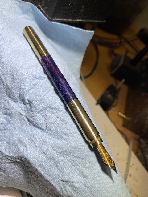

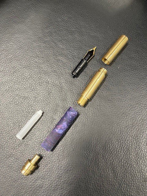

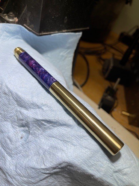

Tried to make "slim" pen with cap today. Let's just say that it is a "work in progress". Trying to use M7.1 for the section and M10.1.25 for the body and cap. Managed to make the parts but the section threads detached when trying to finish the section. Called it quits for the day in the end to let my back get some much needed rest. Getting older isn't much fun at times!
Smallest I've been able to do on a fountain is 11.7mm diameter. Will need to try one with a Schmidt or Parker style refill.
I picked up a suggestion somewhere along the way to help with the breaking section threads - put a drill or a piece of drill rod into the section hole when using a mandrel that holds the section by the threads. It will help give the connection a bit more strength to help keep it from breaking. Rick Herrel also makes a special mandrel for sections that doesn't hold it by the threads, but not sure if he makes one as small as you are making the section. Good luck!!
Very nice fountain pen, Frank. It's way, way beyond where I am right now, and perhaps beyond my capabilities. Plastic is enough of a challenge at the moment!

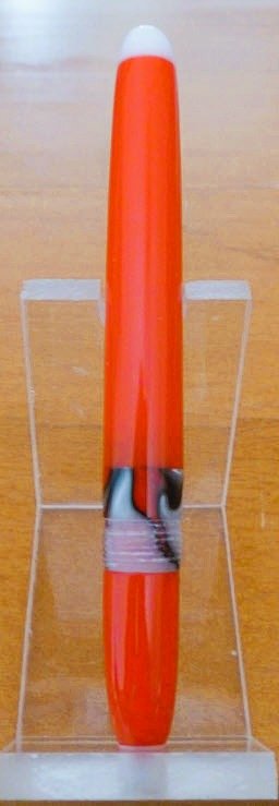

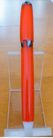

Some success in making a "slim" pen with a cap for a Cross style refill. You will readily notice that the section is a different color. That is because I messed that up, and didn't have any more blue. The body is 10mm, the cap is 12mm, and the section is 8.5mm. I don't think that I can go much thinner. In future I aim to make everything from the same material, and make the cap and body a little shorter. There is some room to do that.
