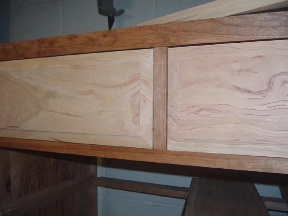

This raised panel effect is done with the TS at a 12 degree tilt against the fence. A 1/16" step is 3/4" from the edge.
I like the effect and would like to duplicate it on a future project.
However, I don't like the amount of sanding needed to get rid of the saw marks.
I've been looking for a router bit to do the same thing. Most don't give all of the dimensions and the only thing I found was a raised panel bit at 15 degrees.
Any ideas?

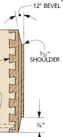

Curly, this is the detail from the plans.
My blade is thinner and did not give me as thick of a step.

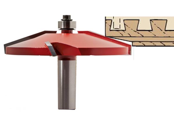

I have a PC 690VS router so I think it would handle the large bits.
And I do use a custom made router table.
I can use the bit John pictured but the angle is steeper. Not a big deal but I'd either have less on the edge or almost no step at the face.

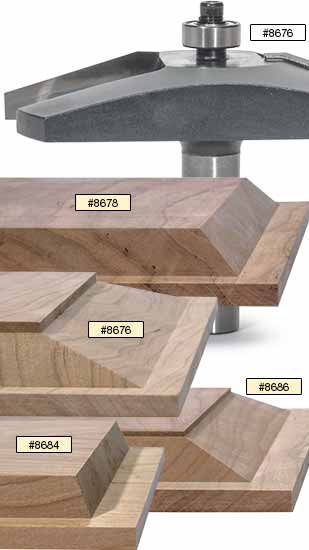

Shaker Bevel Raised Panel bits on Sale!
NEW! 18Âş angle bit! 2 flute, 1/2" shank, carbide tipped bits produce shaker style raised panels with a 1/2" deep tongue. Bit #8685 is widely used for a raised panel effect on drawer fronts. #8686 is also used on large doors. Use #8678 for Thomas Moser Shaker style furniture. See MLCS Router Speed Control.
Shaker Bevel Raised Panel - 1/2" shank Item # Large
Diam.
Bevel
Angle
#8676 3-1/2' 18° $39.95 #8685 1-5/8" 25° $24.95 #8686 3-1/4" 25° $39.95 #8684 2-1/8' 67-1/2° $30.95 #8678 2-3/4" 45° $39.95 No rating yet... Be the first to rate this product!

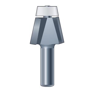

I wonder how a vertical bit like this with the bearing removed would work?
This one is 1" on the cutter length but that can be adjusted below the table.
With proper featherboards to hold the panel against a high fence, it may work.
The 12 degrees is there too.

Well if you are going that way the bit you shown is not going to work. You need a true vertical bit with no bearing. There has to be a cutter on the top side. You can't just take a bearing off. No cutter there.
