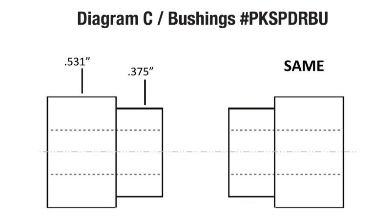

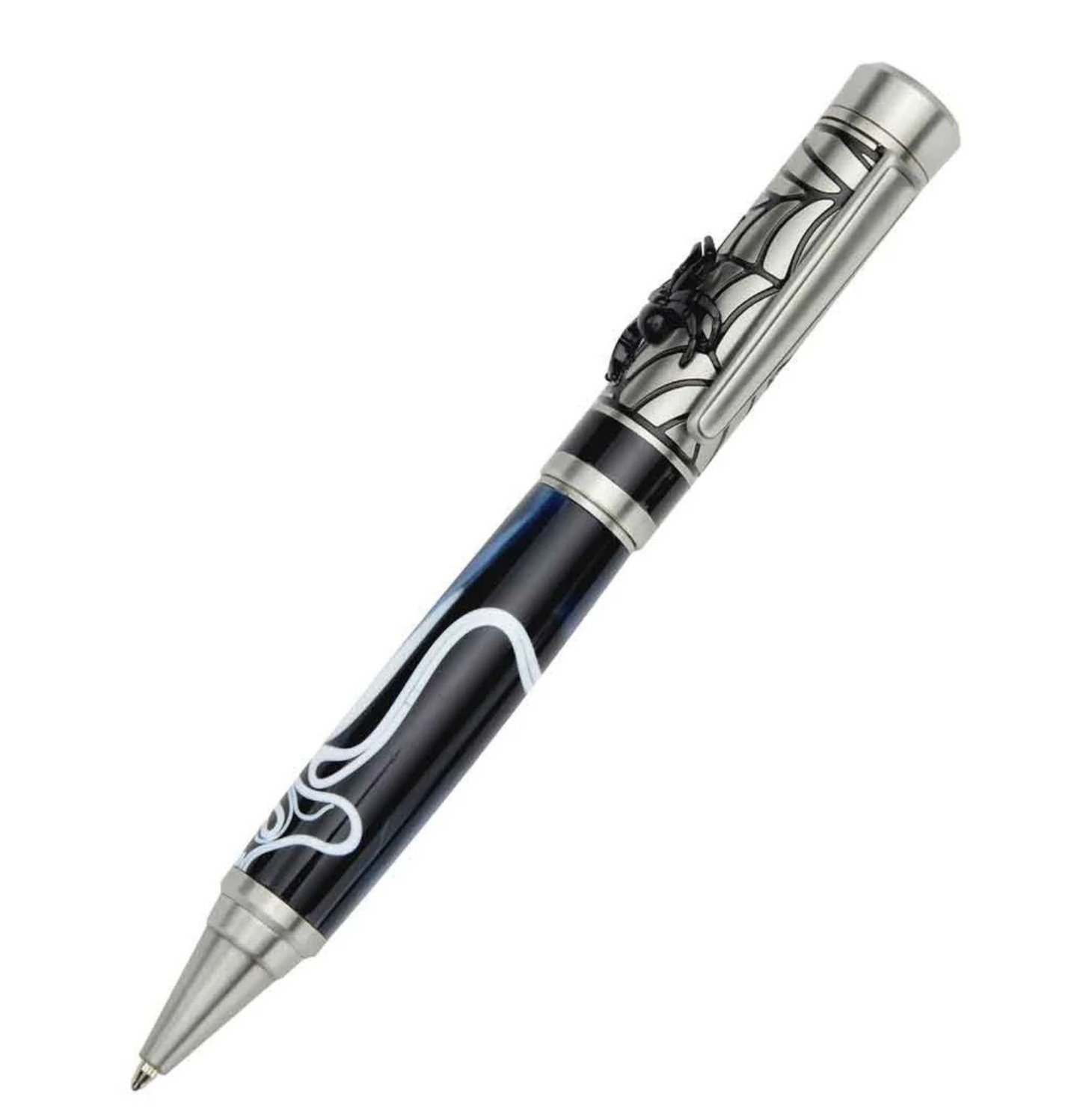

I have an order from a client for a Spider pen, but I've not been able to locate the bushings. Here's the pen kit and the bushings I'm needing. I tried to find the spreadsheet that has all the bushings and which bushings work with other kits and cant seem to find it on here. I downloaded the app and paid the fee and I found the info on the kit, but not what other bushings might work.
Thanks in advanced.

If you absolutely need bushings, check here: Axminster Tools . They have them listed in stock but not sure what shipping would be. You could double check with Exotic Blanks to see if they might have any. Another option is you could use any bushing that will fit the tube (probably the larger of the two lower tube bushings from a Jr. Series kit) that is smaller in hardware diameter that you need and using the calipers, turn to hardware size. You can also get some Delrin round stock and turn down to the sizes you need and make your own bushings. I've made many over the years. Hope something helps.

To use the app to find other kits with the same (or close) bushings, tap on the "Upper/Cap Bushings" or "Lower/Body Bushings" label.,Thstcwill put those bushing diameters into the search field and perform a search. (In the case of the Spider kit, it searches for matches to "0.531 0.376".
If you don't get a suitable search result, try reducing the search to 2-digit numbers "0.53 0.37" to avoid cases where one kit might have bushings listed as 0.531 and another might be 0.532 or so.
