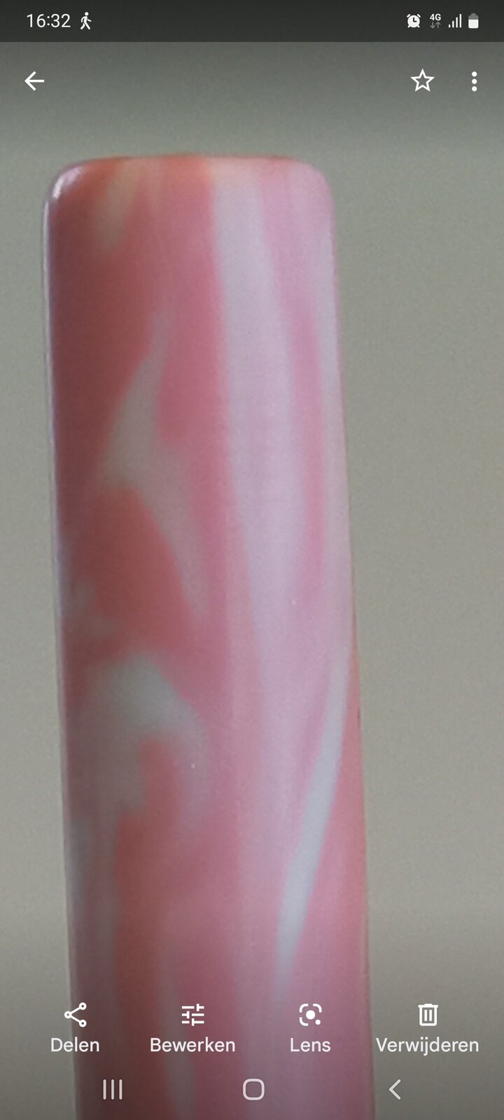

Hello,
I feel bad I have so many questions but there is so much to learn when you start down this path. I tried a lot to get rid of it but no matter what I do I get lines in my alumilite blanks. They are faint but they are there.

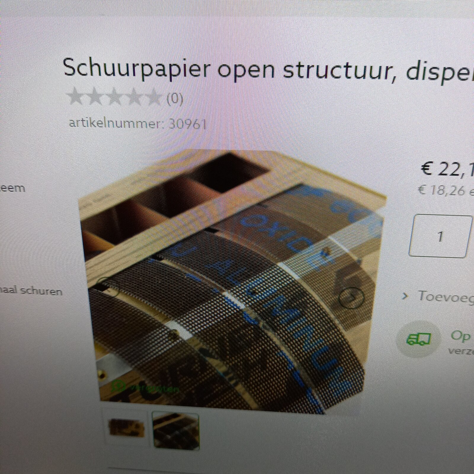

I was wondering if its the sanding paper I use. Its the open kind I took a photo of the paper and added it.
I use 600 grit paper only and then micromesh. I'm still wondering about a finish after that but if the lines would be gone I think it would be sufficient.
Sorry about the bad photo, my phone does not have a great camera unfortunately.

Ok. I will give that a go but that does not take away the lines or does it? They seem to be from sanding or it must be from the skew? If I can't mm them away will polish do the trick then?

"Sanding" may not be the main problem. How firm are you holding the sandpaper as you sand? Pressure on the sandpaper or sanding medium can force the sandpaper grit to dig in for one person while the next will lightly hold the sandpaper and it not create the scratches at all. The pressure that each individual uses with sanding medium is highly subjective and often makes defining the problem difficult.
Personally, I found that for me, open grit sanding medium like Abranet caused more scratches than regular sandpaper of the same grit. For that reason, I quit using Abranet long ago. But others use it and it works great for them.
IF what I am bringing up IS the cause, back off on the pressure, especially on the lower end numbers of the SP. Some people use the sandpaper to bring a blank to the size, and I have too. But be patient and don't do it with lower end SP.

I think I know what I did wrong. First I think my tools (skew 19mm and 2 parting tools 1,5 and 4 mm) were not sharp enough so I will buy the Sorby Pro Edge. I like the machine and since I have 0 experience in sharpening this is a good investment, I think. At least it's a must to have a solid sharpening device.
Second I think it's partially the way I sanded. I will do it more careful from now on with only one finger.
I think sharp tools, practice the sanding and then MM. Then I'm 90% there. The only thing I have to think of is a Polish/ Finish.
I think I will buy a botlle of Meguiars Plast-x or meaby A Beals like buffing system. That's still open.
Thanks for all the comments I't really helped cause I have the feeling it was a sanding technique thing. And that's solvable by practicing a lot on the pens I have so far till I'm content.

I also have the feeling it's the sandpaper I use. It's an open structure and more for wood I think. Although I'm not sure. I have the feeling the lines match the lines in the sandpaper
I was gonna order some abranet sandpaper and start from 400 600 800 then go to 3M trizact. 1000 3000 6000.
Meaby i skip the 800.
I found a place in the Netherlands for woodturning that sells it. I was gonna call him and als for a polish too. And then end with some renaissance wax.
