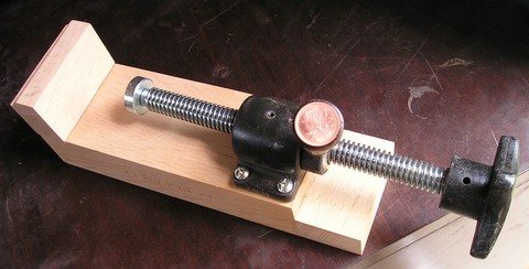

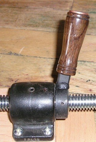

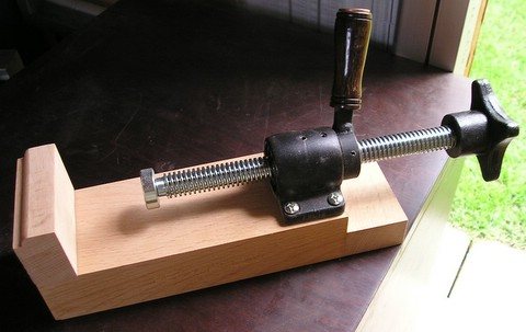

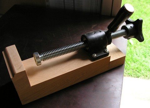

This HD pen press was made by me to accompany the linear pen vise that I posted recently. I refer to the pen press to lil' sister simply because she's daindy in comparison to the 'giant' vice. The pen press is neat in that she's capable of exerting 11,000 pounds of force in minute increments. The handle is a quick release mechanisn when turned to the left(counterC). Slides to a full retraction(open) in an instant. Shift the handle to the right and presto you engage the locking mechanism(clockwise) and you're ready to exert force with ease using the revolving knob. The press is mounted on a solid beech base with a removable end block. The shift lever handle was turned out of black walnut and instantly replaced the 'cheesy' plastic
cover handle that comes with the unit (De-sta-co FLR16). I repeat, although she may be small and perform her task with a gentle stroke. She can also 'crush' you and your pen in an instant if you don't treat her with respect. Fellas let's learn from 'her' and treat her right.;)

I really like the idea behind this! In my opinion you would have MUCH more control over the depth than the press pushed.
