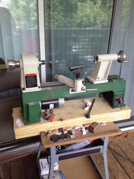

Here is my $20 HF stand.........but it works...........And yes workshop on my balcony. Dave

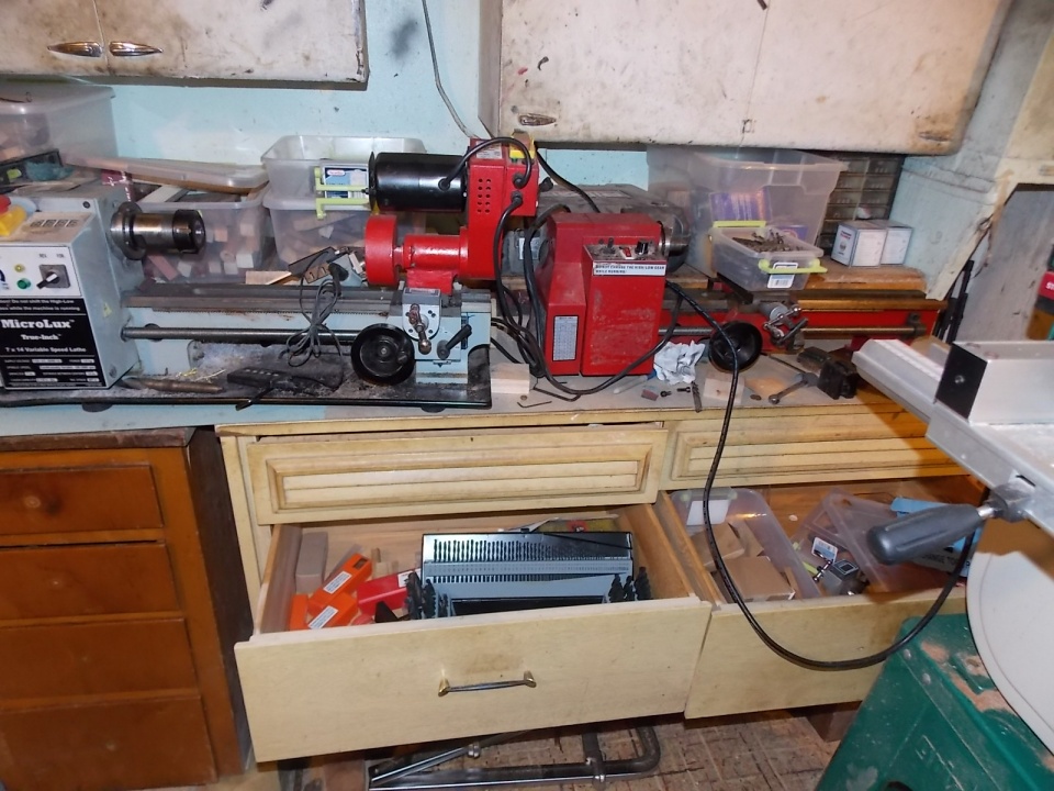

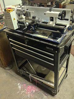

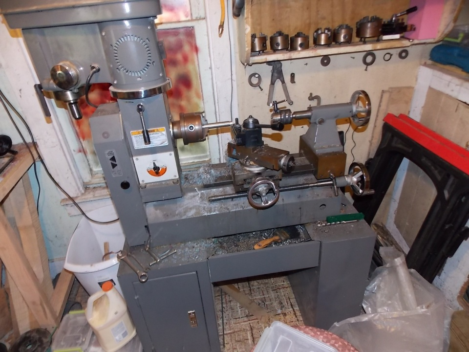

My wood lathe site on an old cabinet base I had in the shop. For my 10x14 metal lathe, I bought this tool chest from HF. There is a storage section under the top, but it is not usable with the lathe in place. Four drawers hold the tooling handy, and a low shelf for junk - as you can see. It came with wheels and is just the right height.
As you can see, I don't clean up often.

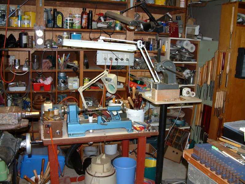

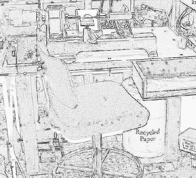

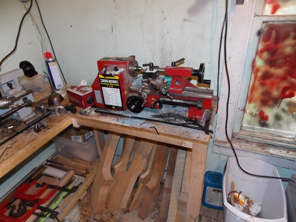

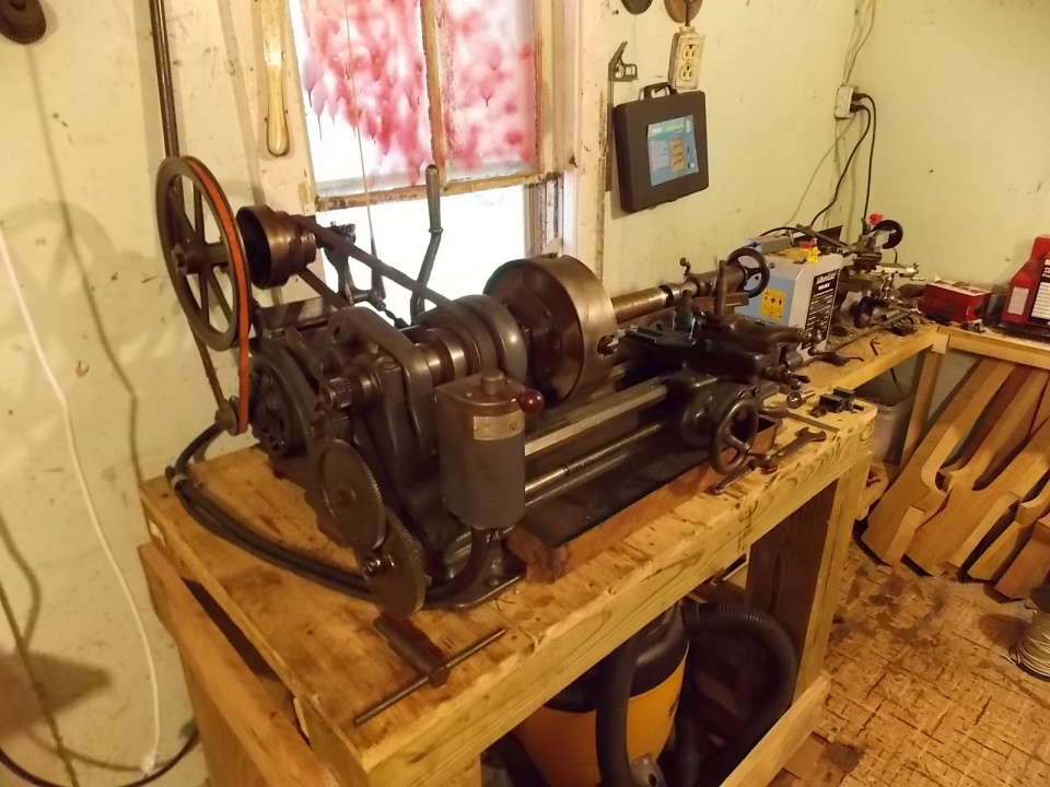

Dan, I choose to sit down on a draughtsman adjustable air chair at mid height lots of changes however mounting on my home made welded steel frame with 1 1/4 inch laminated top, the variable 240 - 415 volt control in the brown box left the small higher table mounted on a strong post houses the bearing press at eye height to press pens, under now clear tons of room motor on the bench rear clear between lathe rails so dust extraction through the rails of the lathe, buffing set up alongside the press. Still seated turn left to my design pen mill.
Works wonders for me no fatigue turning.
Kind regards Peter.

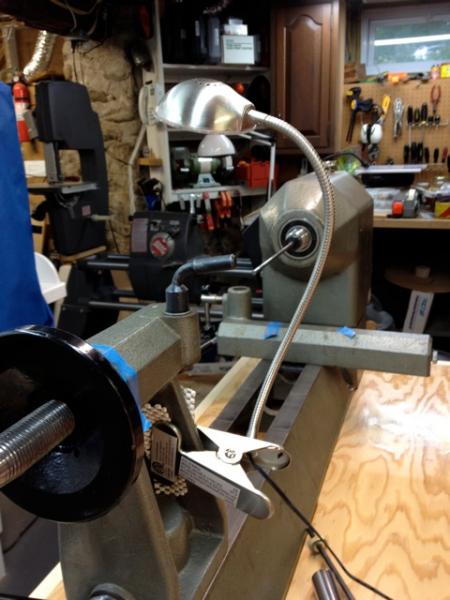

One more thing. You can buy an LED light at Lowes for $20 that will clamp onto whatever you want. I have it clamped to my tailstock. It has rubber(?) jaws that are not that sticky. I got some "waffle anti-rug slide stuff" that my wife had, cut a couple of pieces, and attached them to the jaws of the clamp with double-side carpet tape. The glue on the tape is inclined to weep, so I put a piece of plastic between the jaws until things settled. Anyway, on my Nova DVR, there is a great place to clamp it to the tailstock so that the headlamp is directly over whatever I am turning. And, if there is an "incident" there is nothing to shatter. Not too bad for $20, I think. Russ[/QUOTE]
I have a little les from Ikea. I'll gave to check out the lowes one too.[/QUOTE]
Dan, a bunch of the guys in my local woodturning club have Ikea lights. After I brought my LED from Lowes in for "show and tell", they went out and bought the Lowes version. I have been unable, lately, to find the lamp on their website, but here is a pic of it clamped to my lathe. Russ

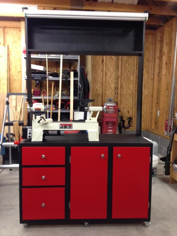

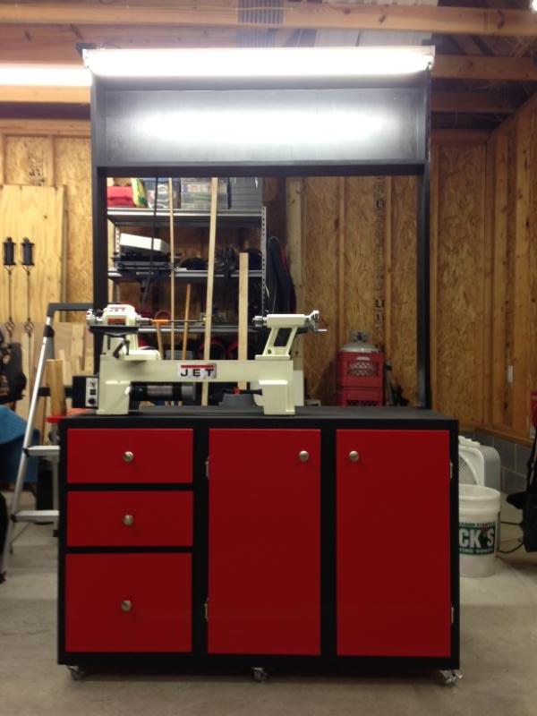

After lurking and absorbing a lot of great information from the great membership here at IAP I decided to make my first post and showoff my recently finished lathe stand/workstation.

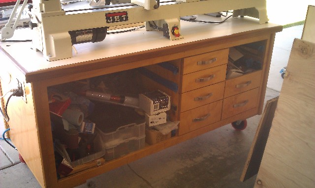

Hi.

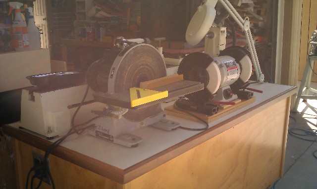

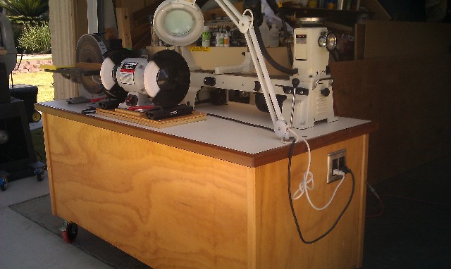

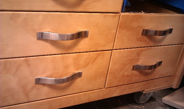

Here is a picture of a cabinet I built to hold my Jet 1220 with extension. The top is 30" x 66" with 12 drawers. It also has a 12" disk sander, grinder with sharpening jig & a lighted magnifier.
The cabinet is wired with 4 plugs on each side & one cord to plug in for power. The face frame & drawer fronts are cut from the same piece of plywood so the grain matches when all assembled. The top is 3/4" plywood & 3/4" MDF & skinned with white laminate & edged with walnut. The pictures show it almost finished. Just have 6 more drawers to make.

Wow,what a nice setup!
Steve
Hi. Here is a picture of a cabinet I built to hold my Jet 1220 with extension. The top is 30" x 66" with 12 drawers. It also has a 12" disk sander, grinder with sharpening jig & a lighted magnifier. The cabinet is wired with 4 plugs on each side & one cord to plug in for power.
Looks like you have drawer slides in the big open part too?
When finished there are 12 drawers total with slides. Works very well. It rolls on 5" casters.

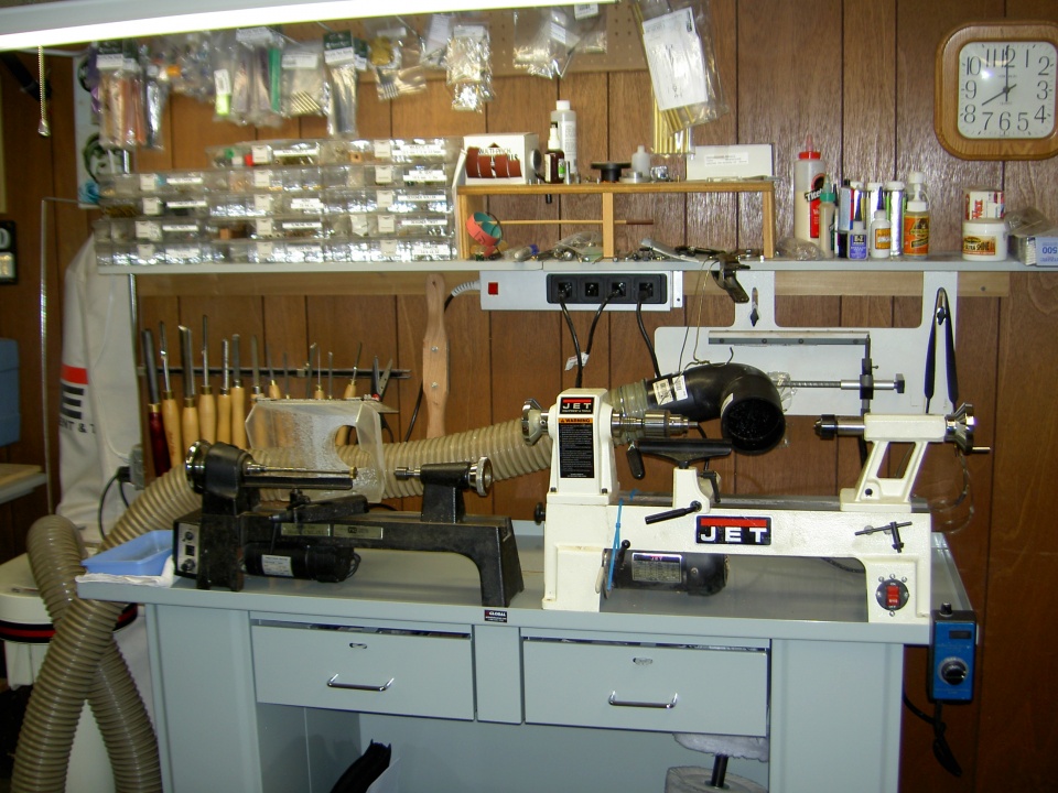

I'm getting a midi lathe and want to build a stand. I need some inspiration.
Anybody willing to post a picture of your shop made mini/midi lathe stand?
Thanks.

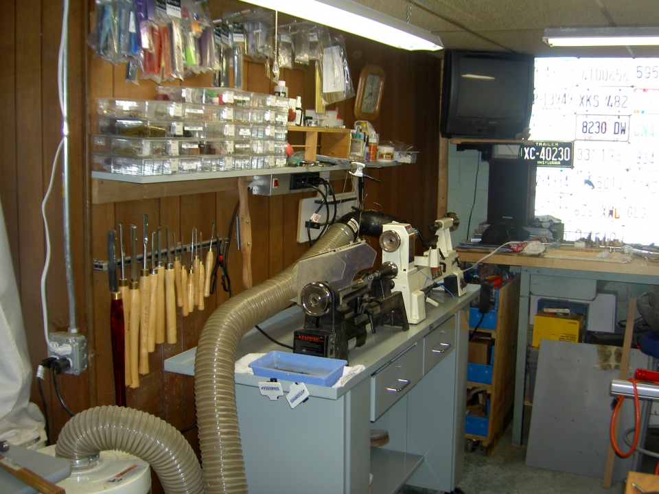

I used the steel cart that Sears sells as a base unit,and made some mods.It's a good unit,and the brakes on the casters are nice
Steve.
Steve, Love your portable Work Bench, The inclusion of the Dust Collector Fan, the Grinder etc., but I think you forgot the most important machine of all.
The "Coffee Maker" , or is that coming on Revision 2

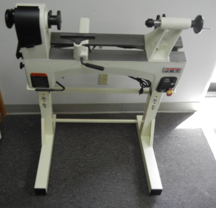

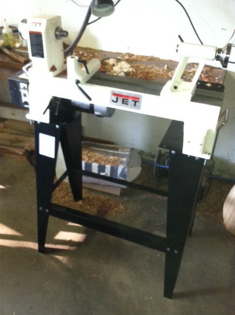

Ok, stand has been finished! Lathe is a Jet 1220vs, now discontinued. I really didn't want to pay $225 for a stand IF I could even get one. Picked up a $45 stand at Harbor Freight, the 46 inch stand, and cut it to the size I needed. Took me a few tries but I got it. The shorter the stand got the stronger it was. Turns out it's pretty darn solid. I did an outdoor demo last weekend and it handled everything. Pretty pleased!

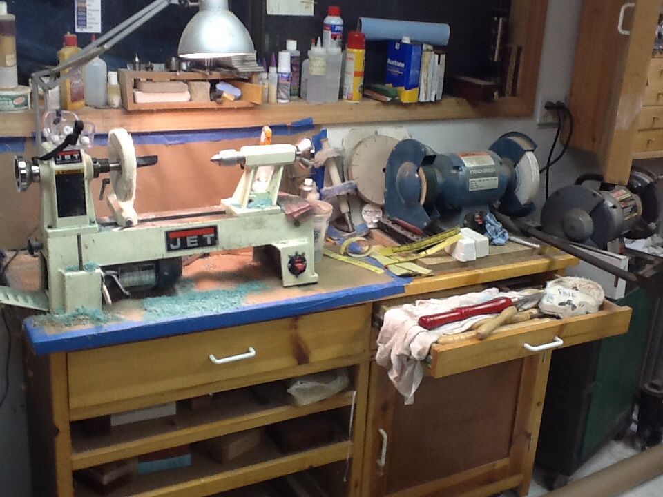

Cabinet with storage and sharpening center. Tool drawer has no bottom so chips fall through to floor. Whole unit on lockable casters so I can move it for cleaning or whatever.

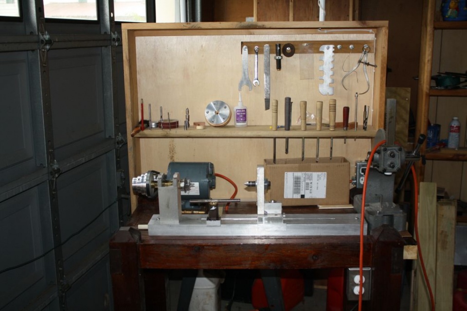

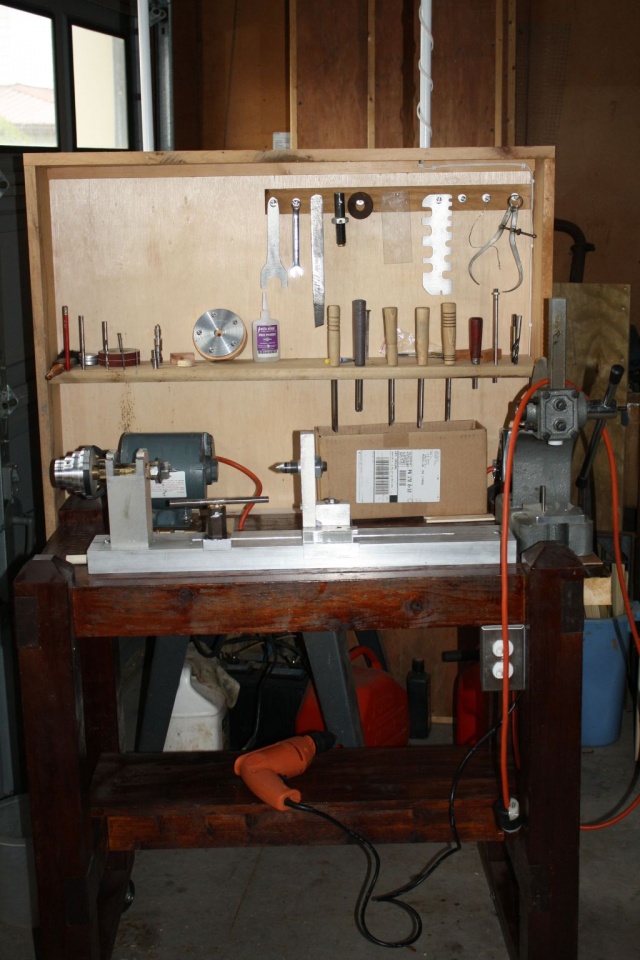

Some 4X4s, 2X4, plywood,and some glue and screws. Built the stand many years ago, then when the lathe was finished, pressed it into service. Added the back shelving, and done.

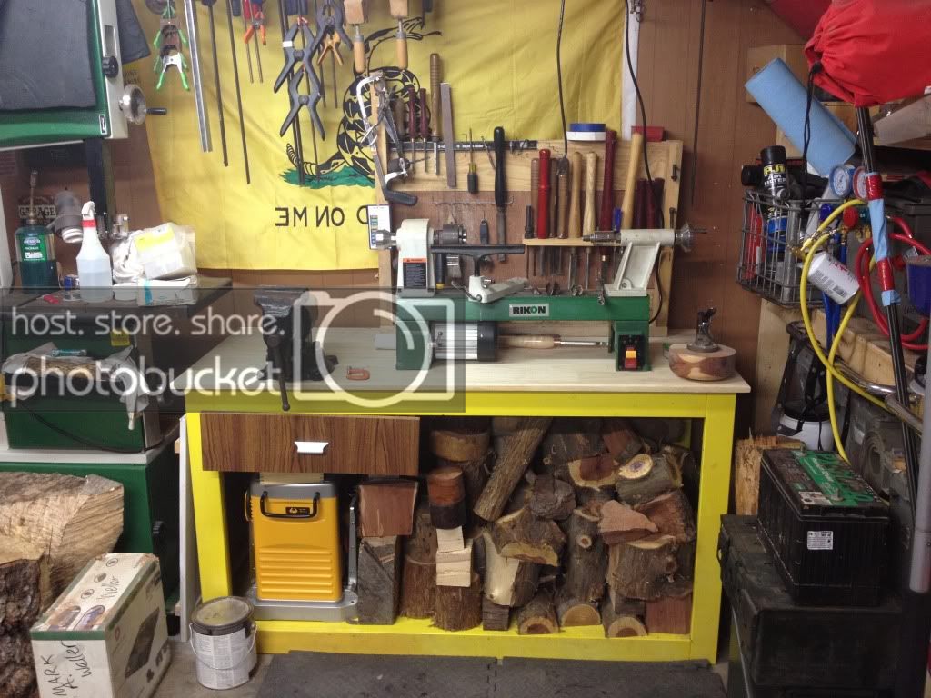

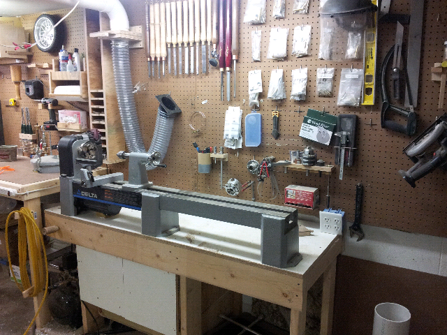

it was supposed to be for something else but I needed a new lathe stand so I stole my own project (which also got me out of having to build doors for it). the drawer is haphazardly set on the planer, the rest of the area is filled with bowl blanks.

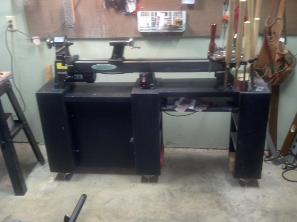

My "Shopnotes" stand
I attached the picture of my stand. I built it using plans out of Shopnotes magazine. The extension on the right hand side is removable so if you don't need it you can take it off or not even build it. It's all MDF and heavy, but you can remove the big panel on the front and stack concrete blocks in their for more weight if needed. Adjustable shelves on the sides plus a large shelf on the extension. It also has adjustable feet for leveling.

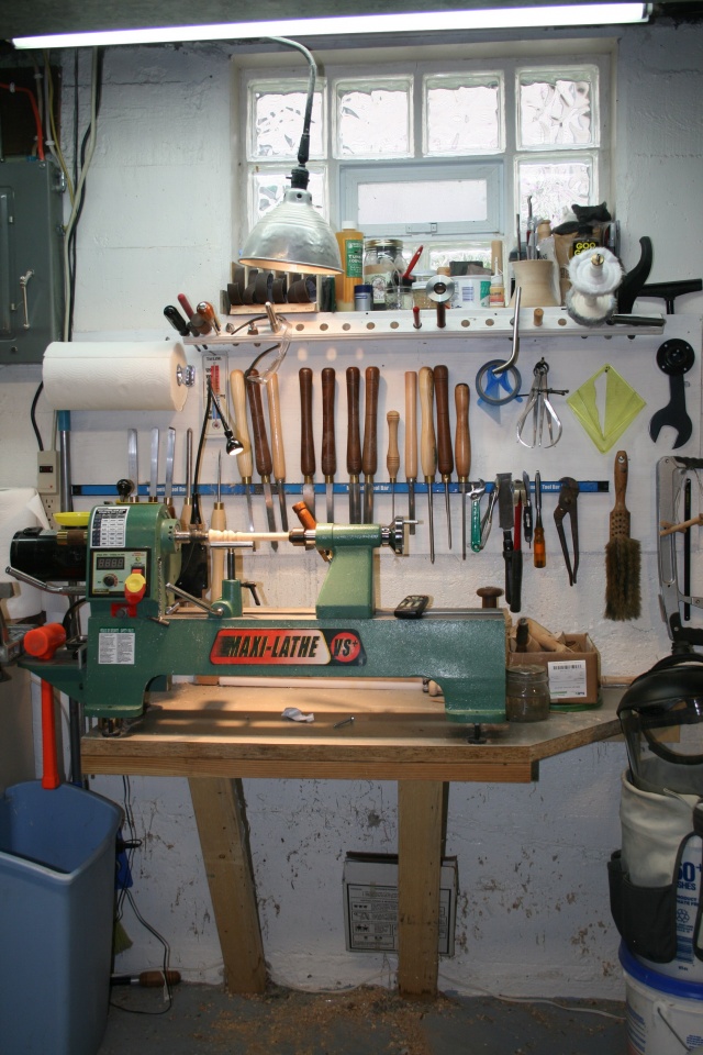

My basement workshop

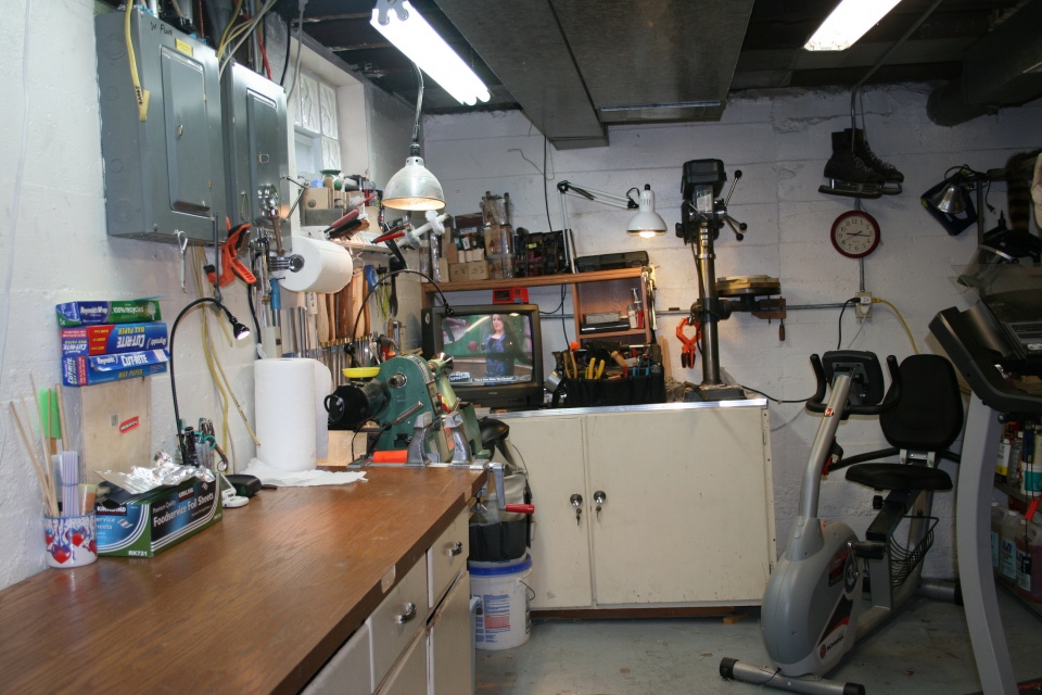

Here are a couple of pics of my basement workshop.
As you can see I've taken a corner out of the basement workout area between the treadmill and stationary bike.
I like the natural light over the lathe, it helps a lot in final finishing.
Happy Turning
Tom

I should try this for my 1221 Levi Woodard Sent from my DROID RAZR using Forum Runner
Levi - it's still working very well for me. I added some braces after as well. I turn green bowl blanks on it without a problem - even with no added weight. Just can't turn the rpm up to high until it's trued up.
Pm me if you need more info.

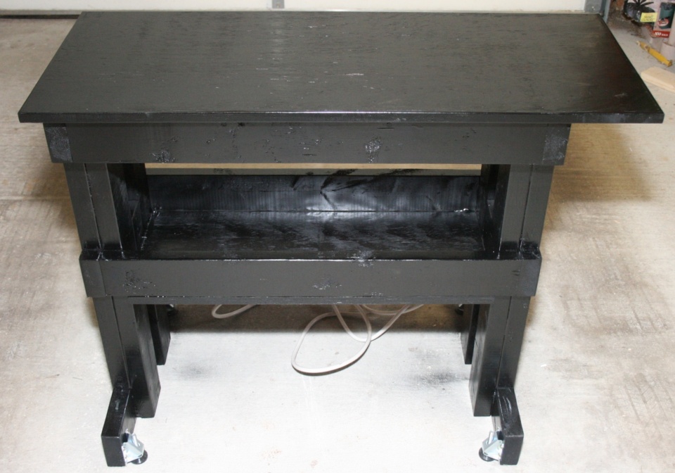

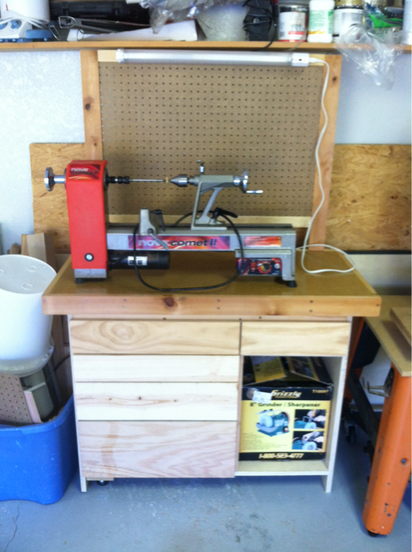

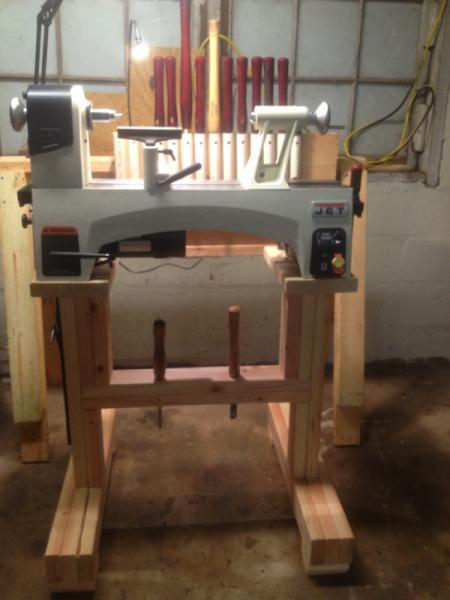

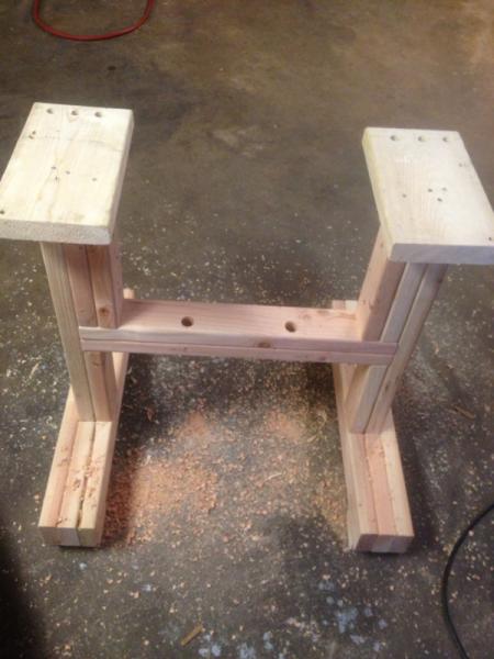

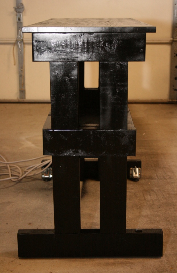

I finished my lathe stand today. It's made as I was planning with 2x4's and 3/4" plywood. It's stands 31" high the top is 14" deep and 39" long which should give me room on the right side of the lathe for tools, sand paper and finish. There is a shelf or bin I guess you could say 12" below the top it about 12" wide and 28' long. I put leg levelers on the so that I can keep it level no matter what the floor is like. I also put a power strip on the back of the stand. I hope to post a picture or two later on in the week when my lathe get's here.

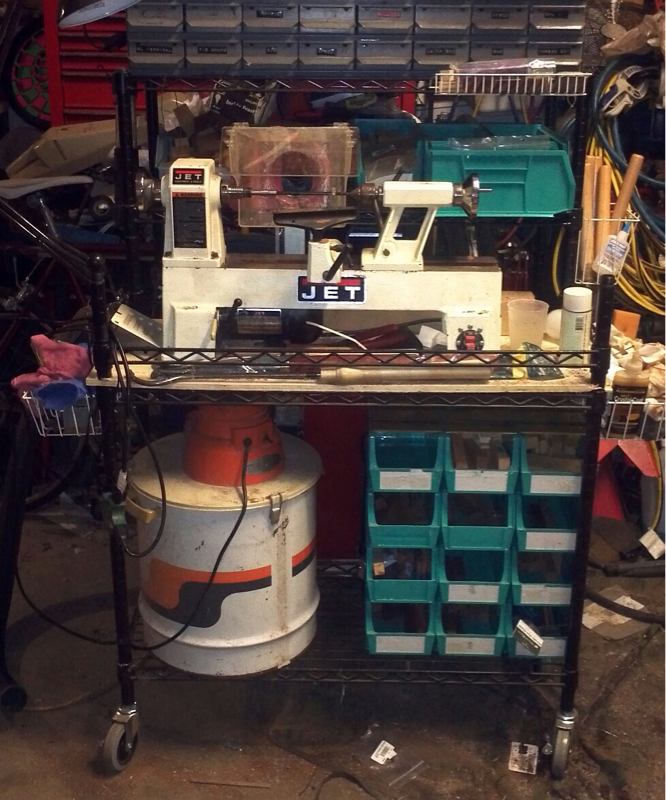

Here's one out of metro shelving, I've added to it and build a stronger base for it to sit on in order to make it mobile. But everything's there for my needs and easy to locate.
