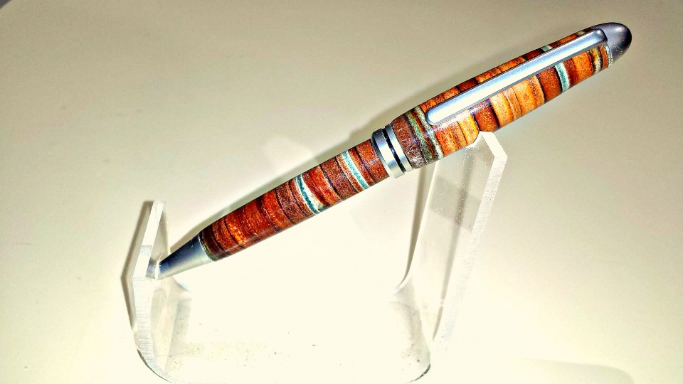

I have only made a couple leather pens, but plan on making some more in the next few weeks. I like all different thicknesses and types and colors of leather. Each gives a different effect. The messiest part is the actual glue up. LOL
This is one of my favorite pens I have ever made.

Thanks Mitch. That's actually the pen that kick-started my research :)
Did you have any troubles with particular types of leather, or did it all work regardless of the grain / weight / etc.?

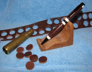

To cut out my leather for pens, I use a .50 cal shell. I cut off the primer end. Then I ground the cut end down to about a 45 degree angle. Place the neck end into my drill press. It will cut out nice disc size leather rings for making pens.

Great idea Billy. I was planning something similar for punching the interior hole using a sharpened length of pen-tube brass, but didn't have a good idea about cutting the outside . I don't have a .50 shell, but there's more than a few of gun or surplus stores in my area that should have one.
