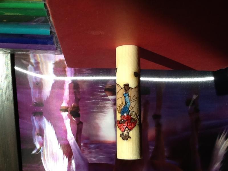

I just finished assembling the Cowboy blank from LazerLinez. I was careful to get all the pieces as flush to the blank as I could. Its not perfect, but its close.
This blank has a lot of lightly etched detail on it that will easily disappear even with very light cuts or sanding.
How do you turn and finish these blanks to maintain the fine detail in the laser cut pieces?
A lot of the inlay kits have to be turned with more material in the middle of the blank where the inlay is. If you look at a most of the Sierra kits you would find that if you turn bushing to bushing or a straight cylinder there will be very Little wood left on the brass tube.
Now when the inlays are cut I try to to cut almost through but still have everything stay together. There is a fine balance between all cuts fall apart or for it look great when turned.
When the laser lens gets dust on it it would cut with less power and therefor not cut through and cause the detail lines to disappear.
Please send me a pm with address and I will be more than happy to send you a replacement.
i don't need anything replaced, at least not yet. I just got to this point and I don't want to muck it up.

I might be in trouble. My CA had suffered a bit of thickening so my small controlled drops weren't quite so small and a bit less controlled.

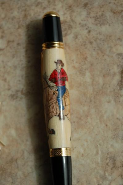

Good day - Bad day

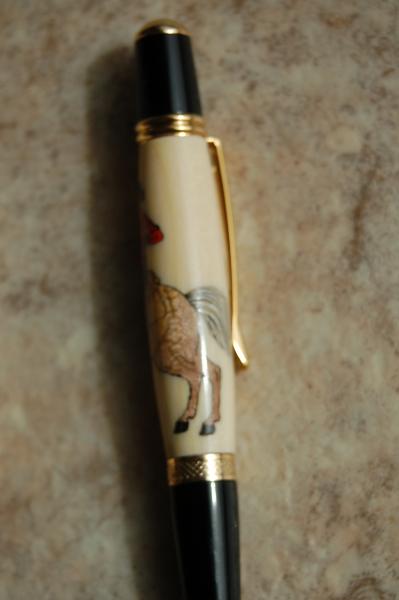

My daughters found a burned piece of wood in bale of hay. I took a piece of sandpaper to the log and in a very short time I had a nice pile of very black powder. I rubbed this into my pen blank, tapped it to get it to settle into the cracks and then added CA. I had mess of pen blank put I put it on the lathe and this what happened.
The second picture, though it did not turn out well at all, is the reason I started this thread in the first place. I took the diameter down slowly and stopped when I saw the detail in the tail starting to get very light.
I like the way this pen turned out.

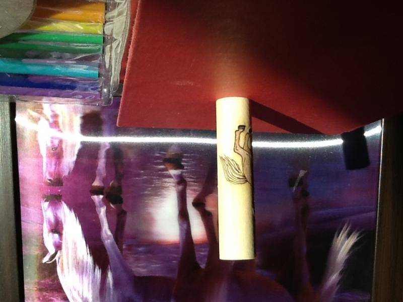

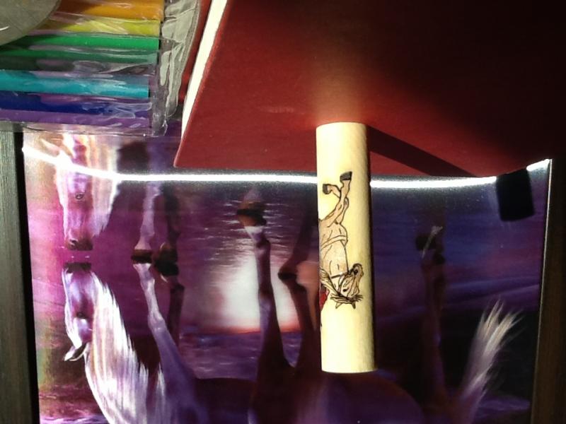

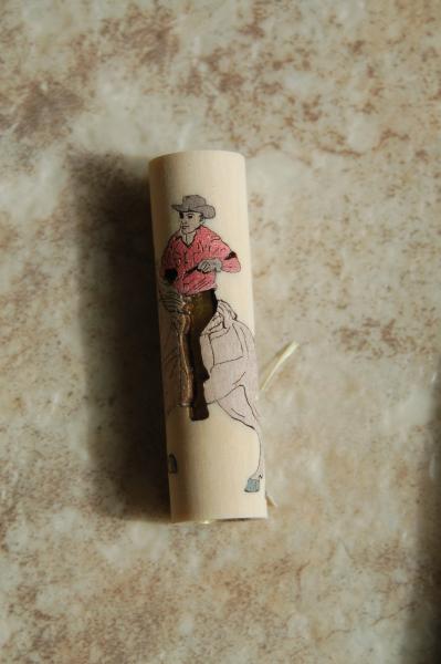

I had two blanks for the Cowboy. And the first on turned out so nicely I went to work on the second blank. And this is what happened. I was not cutting fast since I was paying attention to the tail details. I must not have gotten enough glue inside the blank and the skew caught a small piece of cowboys leg and that was the end of it. *sigh*

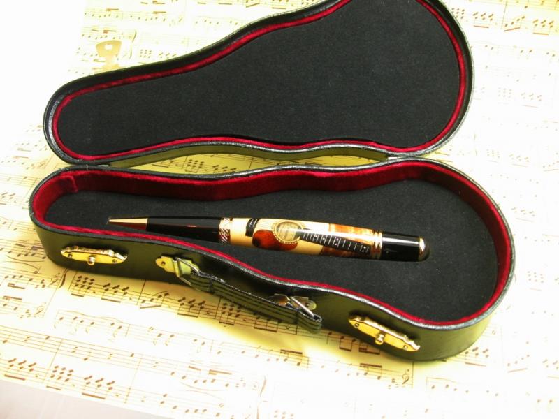

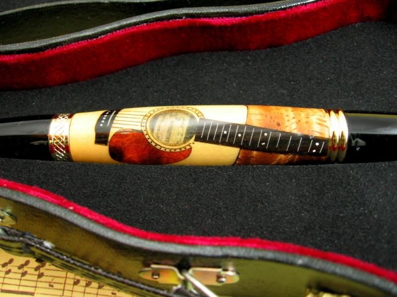

My favorite Constant's blank is the Comical Golfer. Very challenging but neat looking. Every time I make one and carry it to a show it sales. Most comments I get are " Hey thats the way I look when I golf". I keep about two dozen of his laser cuts at any given time and they sell well.
I too have done several of the laser kits but the one pictured was the most difficult. The fine lines, like the guitar strings, are burned deep enough that you shouldn't cut through when turning with REALLY sharp tools.
