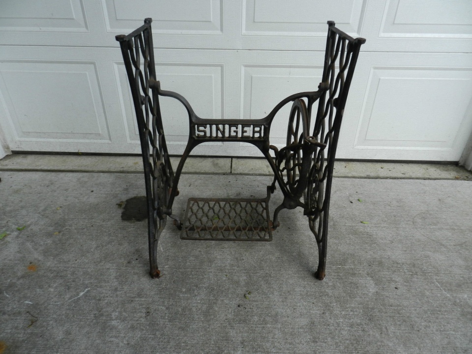

I built one using an old pedal type Singer sewing machine base. It is sturdy, compact, and on wheels and can be found locally cheap as folks tend to want to get rid of them especially if the sewing machine itself is junk.
I took off the pedal on the bottom so the bottom is open. You do need to build it up to get to the height you want, but I used a few 2x8 I had lying around and drilled out tool holders in the front of it for the tools I use the most...

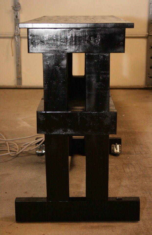

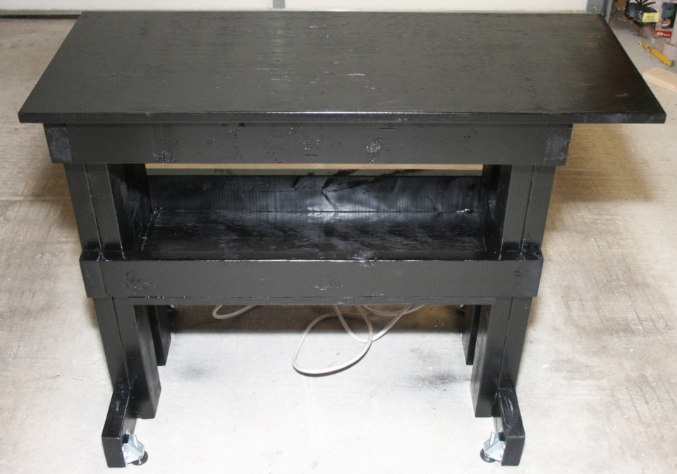

I finished my lathe stand today. I made the base from 2x4's and the top and shelf form 3/4" plywood. The stand is 31" high, the top is 14" x 39" and is has screen molding around it just to dress it up a bit. The shelf or bin is 12" x 28". I have leveling feet n the legs to that no matter how uneven the floor I set it on is I can keep is from rocking. If your wondering what the cord is under the stand, I put a power strip on the back. I painted it black since I had it in the shop. I'll post some other pictures of the stand with my lathe once it get here which should be around Friday. Any and all comments are welcome.
