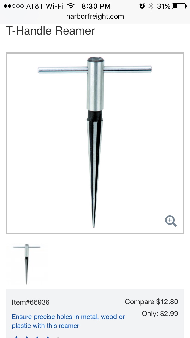

I use a tapered reamer to clean the tube ID before turning and definitely before assembly. They can be had from Harbor Freight for about $3.
