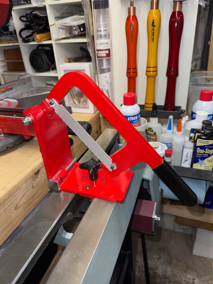

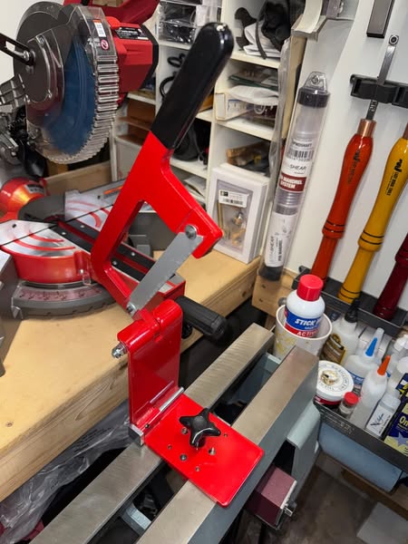

found this online, has anyone used it before? any thoughts? cheers

I was trying to look this thing up and came across this in my search results
Someone using a hacksaw blade further down in the conversation.
I dont know. This just looks dangerous.
Ok maybe i am overthinking this. I am trying to gather all the tools needed to make bespoke pens on my wood lathe. I thought that this tool wood make nice vertical cuts to ebonite rods. How do you guys true the face before drilling/threading? Just a parting tool is enough?
I cut on bandsaw or on lathe with a thin parting tool and then square the face with a square carbide cutter.
Just my opinion but that saw blade is not going to give you a nice smooth square cut.

My first thought was a cutoff tool also. I've used a hacksaw blade for that purpose, but only with very small turnings, such as a finial piece. I prefer to stick with something safer. The small cutoff tool from the Benjamin's Best mini chisel set works great.
