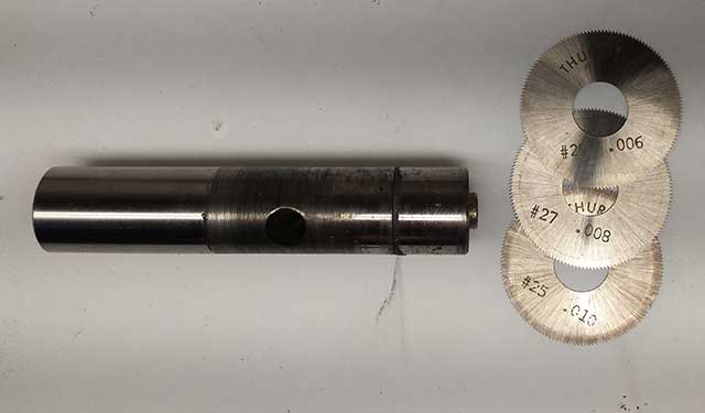

7 years ago, my pen lathe got converted to a specialized, mini tablesaw which uses both 1.5" and 1.75" diameter blades. 0.006", 0.008", 0.010" and occasionally a 0.004" thick HSS blade. That grew to 5 lathes setup. 2 variable speed and 3 Jet 1014 fixed speed, each setup slightly different. PSI tech guys were great in talking me through adjusting an internal setting to lower the bottom speed to about 50 rpm for sawing Titanium coils. 2020 was pretty slow and we made a decision which allowed me to restore one of the lathes to its original purpose in late December. Now I have 7 years of catching up to do here.
Custom Arbor by Rick Herrell

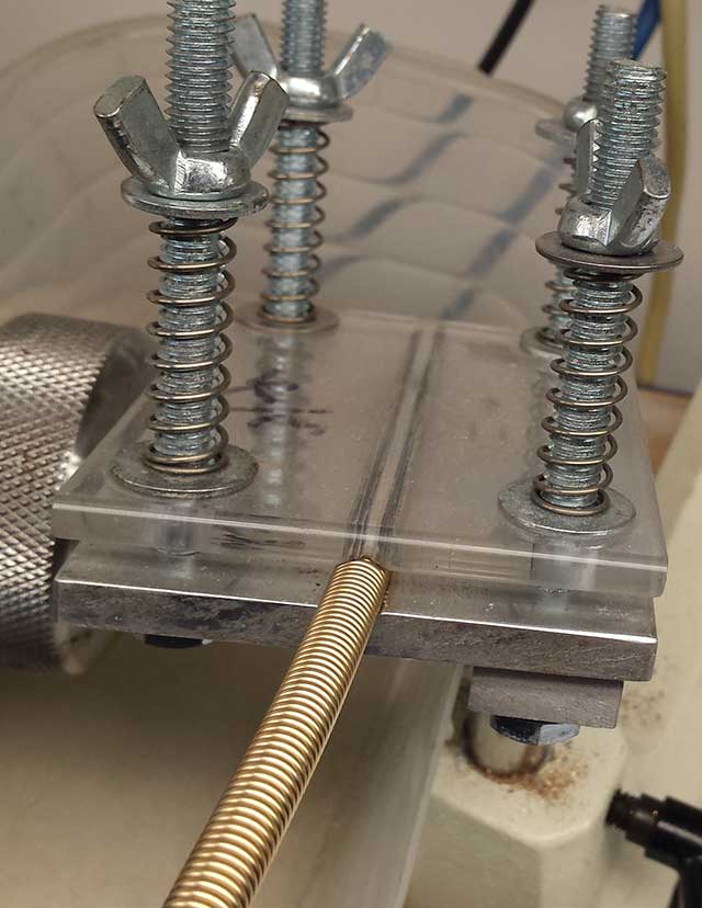

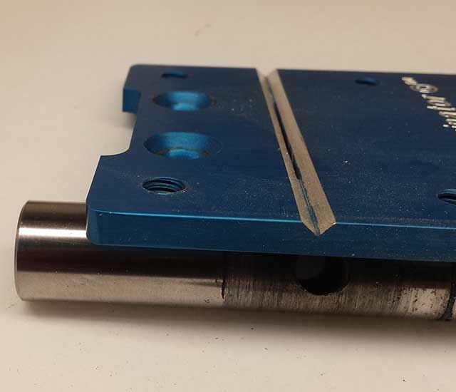

Specialized Table

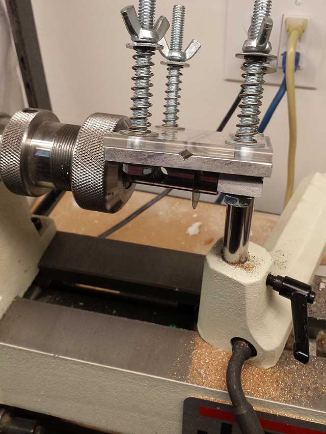

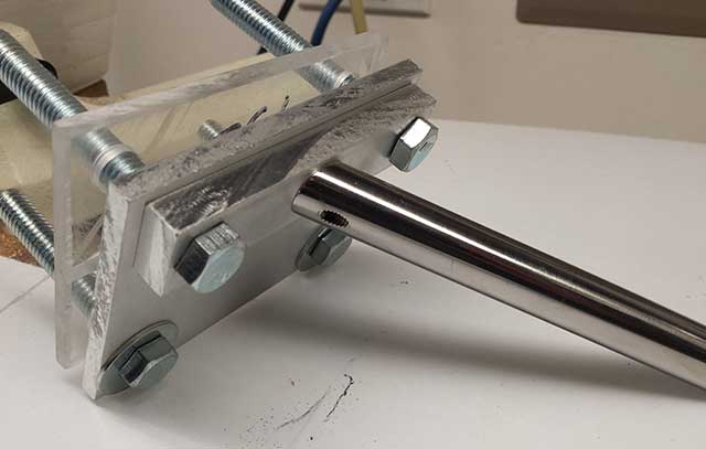

Custom Toolpost by Rick Herrell

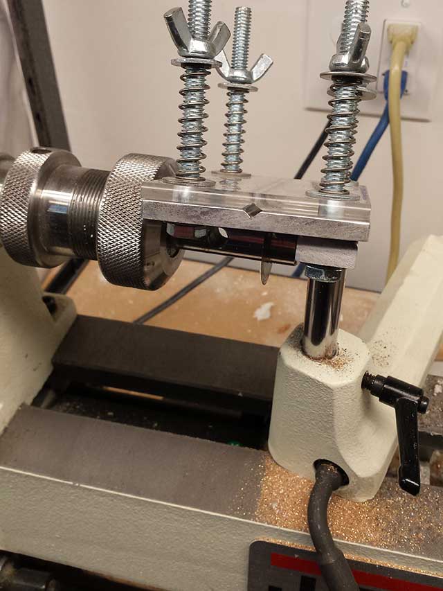

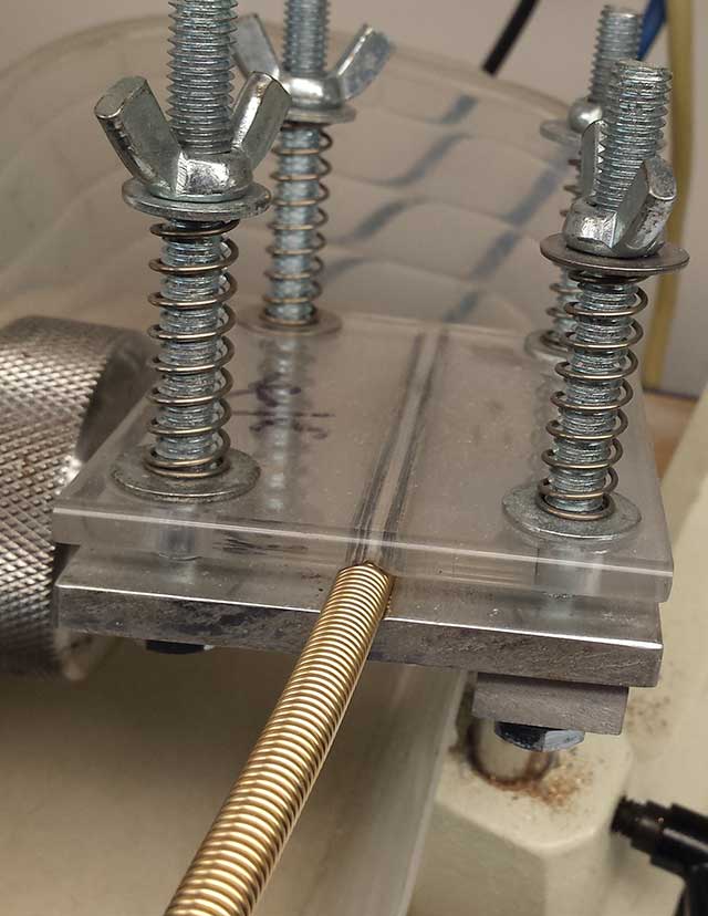

Mini Saw ready for work. Toolpost allows blade height adjustment.

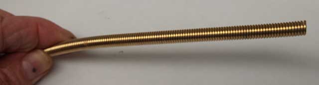

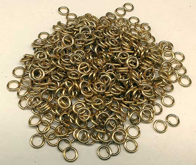

Coil of 16awg 14kt yellow gold-filled wire which is a misnomer since the gold is on the outside, not the filling.
Coil cutting in progress
Saw output ready for polish and hardening (not quite 3 ounces)

The engraving is either the copyright or trademark of that particular table. I have 10 tables in the rotation since the v groove has one spot prone to excess wear and it's quicker to swap & restore at a more convenient time.
