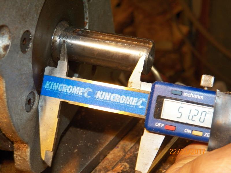

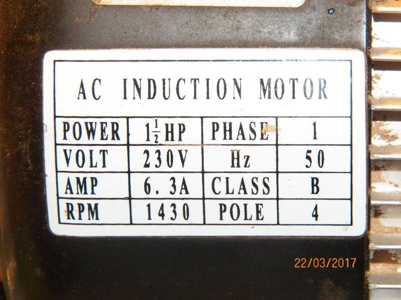

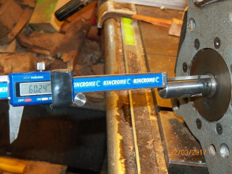

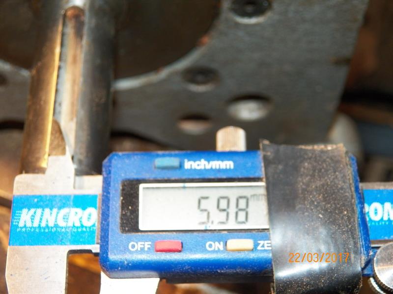

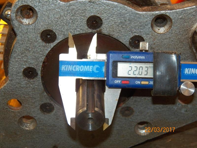

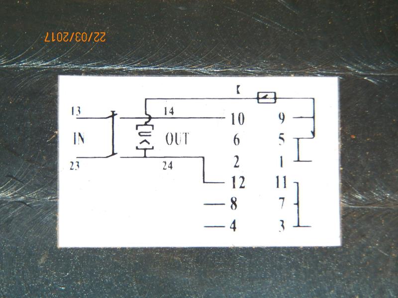

Hi Peter,
I had to remove the pulley to be able to give my motor shaft size, according to Teknatool there are 3 possible sizes depending upon the machine age, mine is about 8 years +.
I got the motor out and checked everywhere for any other info, the only thing that I could see apart from the sticker I attached on this post, was a small sticker with the motor number I believe, a series of 6 numbers, I think..!
I took measurements of the shaft and the only thing I need to do now is to remove the motor mount and get a pic where I will put all the measurements, that will help to get the right motor or one what will require a minimum of alterations.
See bellow and let me know if you require anything else.
PS: the wiring diagram shown is inside on the control box.
Cheers
George
