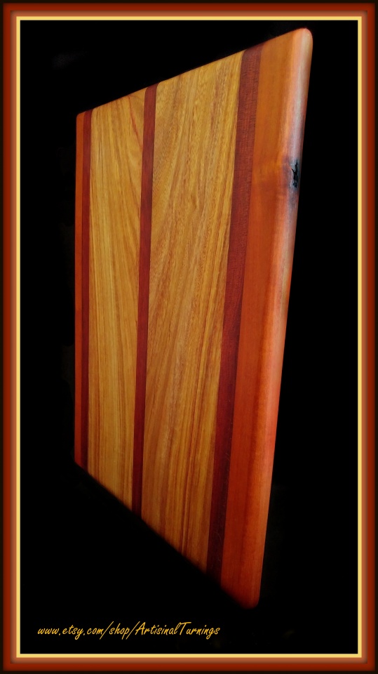

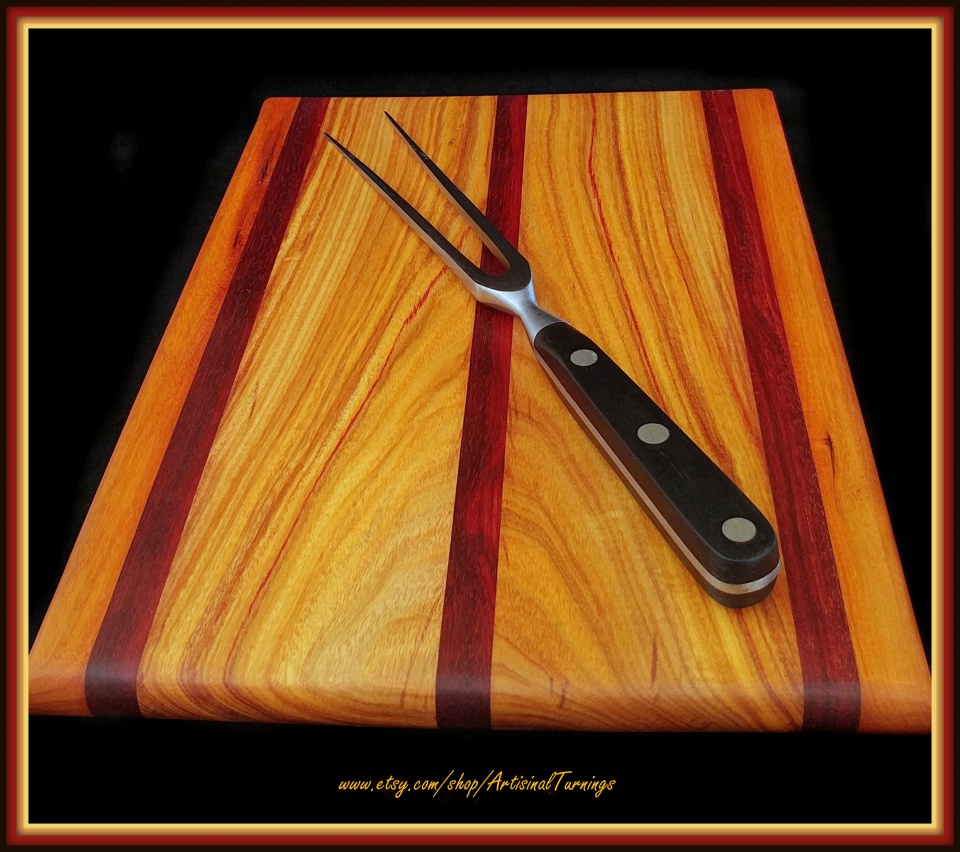

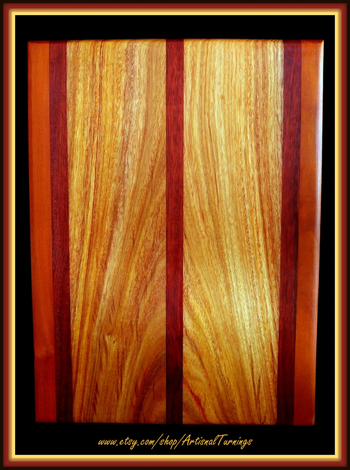

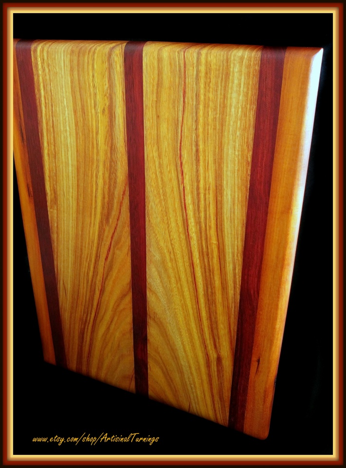

This is my latest cutting board made from Bloodwood, Canarywood and Cherry and finished with Mineral Spirits. Dimensions 8 3/4" x 11 3/4" x 3/4".

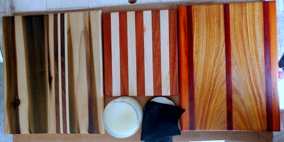

New Finish
I melted 0.8 ounces of bees wax in 6 ounces of mineral oil in a double boiler then cooled until hardened. All my recent cutting boards got a new coating of this wax/oil. Now everybody should be happy...I know I am!
