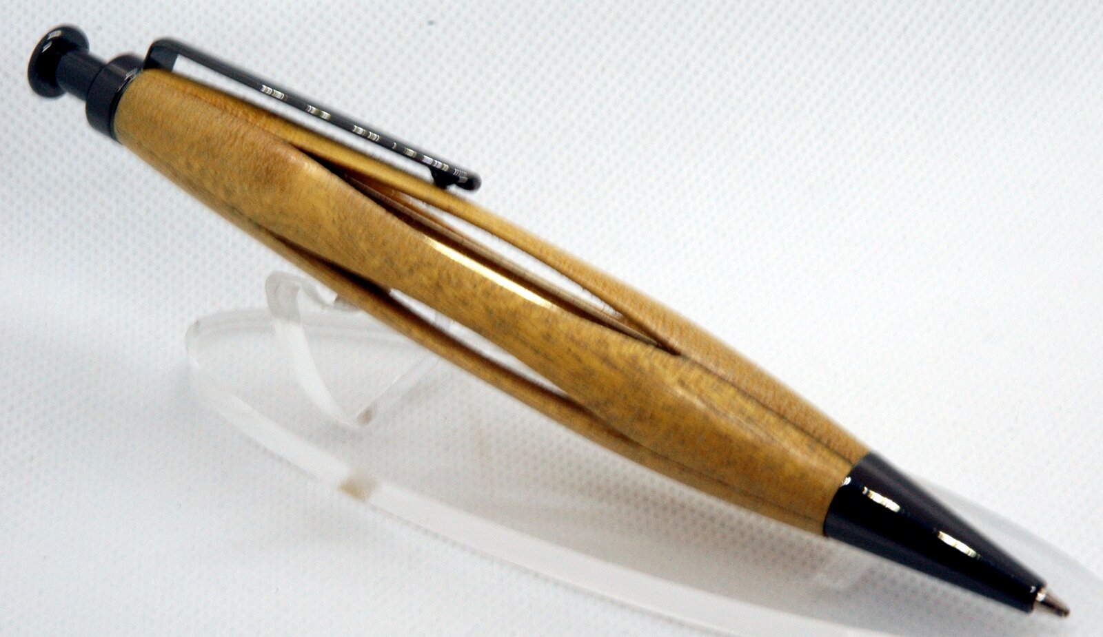

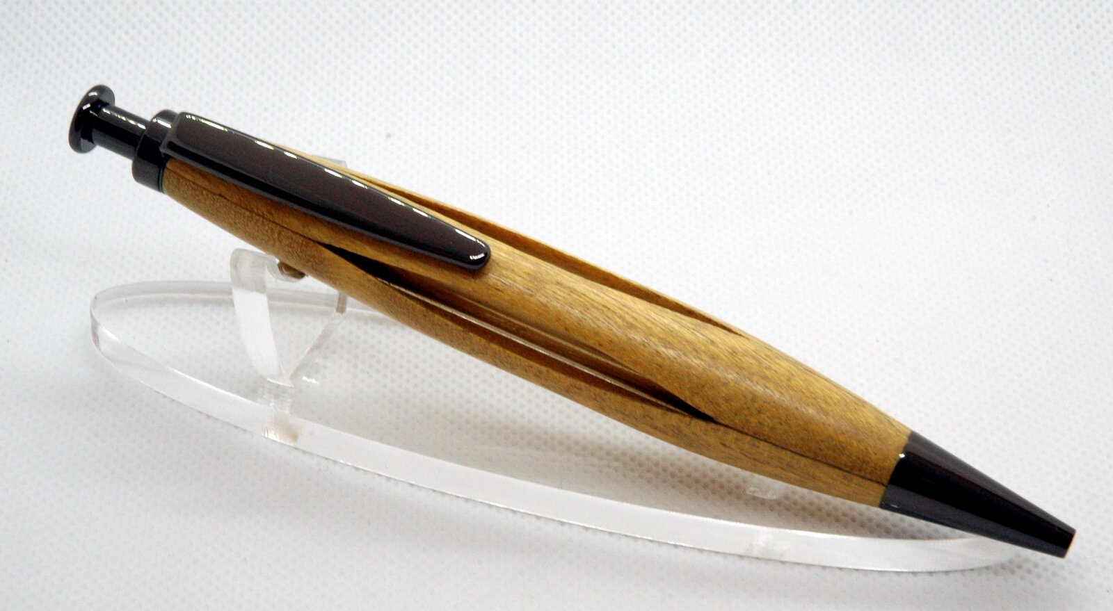

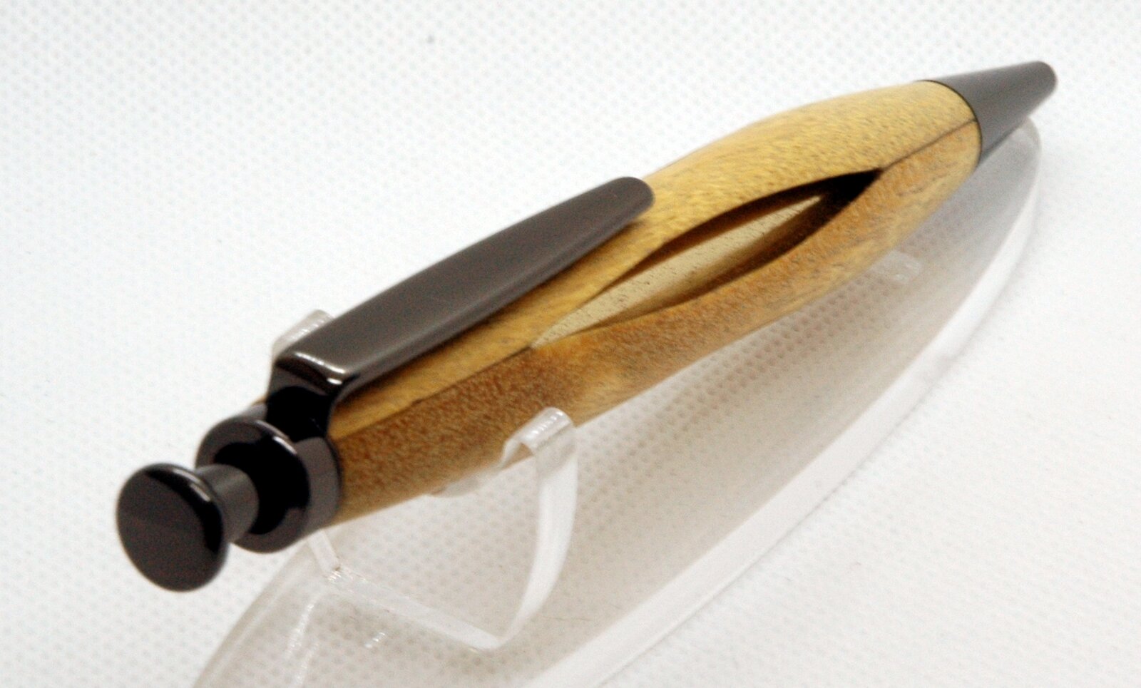

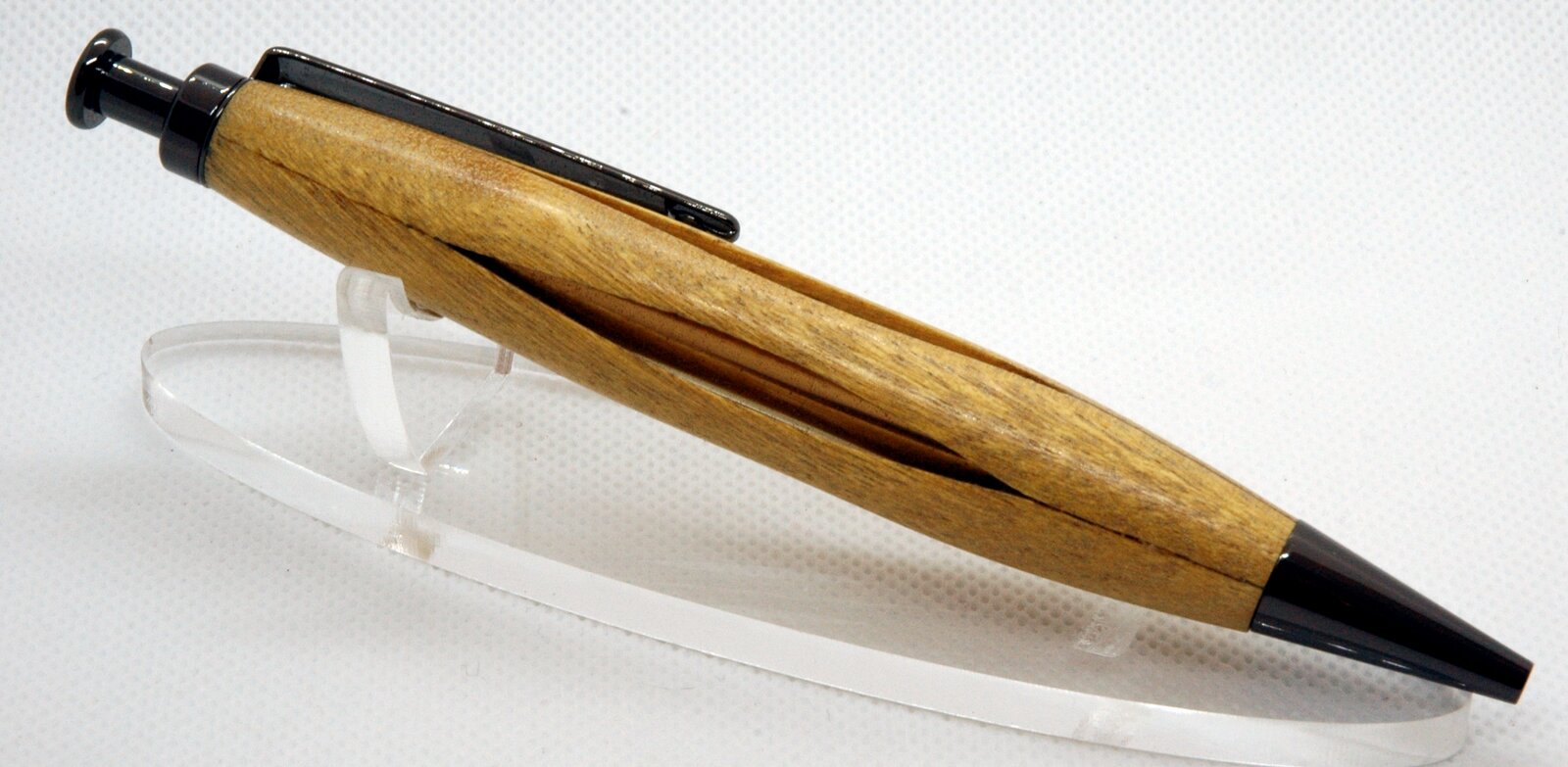

When I set out on this frustrating journey to make an Inside Out pen to fit a standard pen kit you have seen all the results good and bad and your comments were encouraging. And today this is it. Yes I left the Tube Brass and I think it suites the wood and got fed up scratching the paint on insertion. So after many attempts thats the mission accomplished. I promise to move on and not make any more think I've pushed it to the limit.
As always your comments are appreciated. Sorry Ken gave upon painting the tube.

Well thanks for that. I put an undrilled blank in the lath turn between centres turn the inside curve.
Then cut the blank along its length into 4 long segments glue and reverse these so the curve is on the inside . Cut the assembled wood to length drill insert the tube sand to length. You are now ready perhaps to cast in resin. I am sure you will understand this.

Yes, your process would lend itself to casting, because there is a stage where the wood is cylindrical in shape.
After you cut, reverse, and glue ... you can then turn cylindrical.
At that point you can cast in resin in order to fill the cavity .... then drill and glue in the tube(s). . And, finally, turn to the shape you have.

The inside is finished before reversing the 4 segments because you turn the inside first. The Pen is finally finished with Melamine Laquer.
