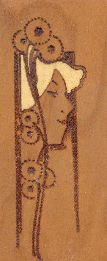

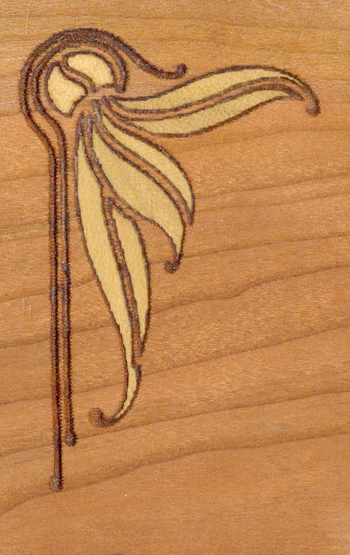

Stay away from the Chinese machines on Ebay. The ones for less than $3000. I have heard of machines that won't run, or have broken parts and lasers when they show up.
I bought from a rebuilt machine for $9000 from; http://www.usedlasers.com/component/option,com_frontpage/Itemid,1/
It is a Universal Laser with a rotary attachment. You can do a line, rotate the pen and do another line, so the rotary attachment is necessary unless you want to work in the round. You can do some great center bands when you engrave in the round.
Justify the cost? If I had to do that for all my machines I would be shooting pool for a hobby instead of woodworking. Laser engravers hold their resale very well. If it seems like too much in the future, you will be able to get most of your money back when you sell it.
Here's some more fun stuff I am doing for some jewelry boxes. The laser engraves on one program, then I outline the parts of the graphic I want to cut. I put down some colored veneer and cut that on the laser as well
