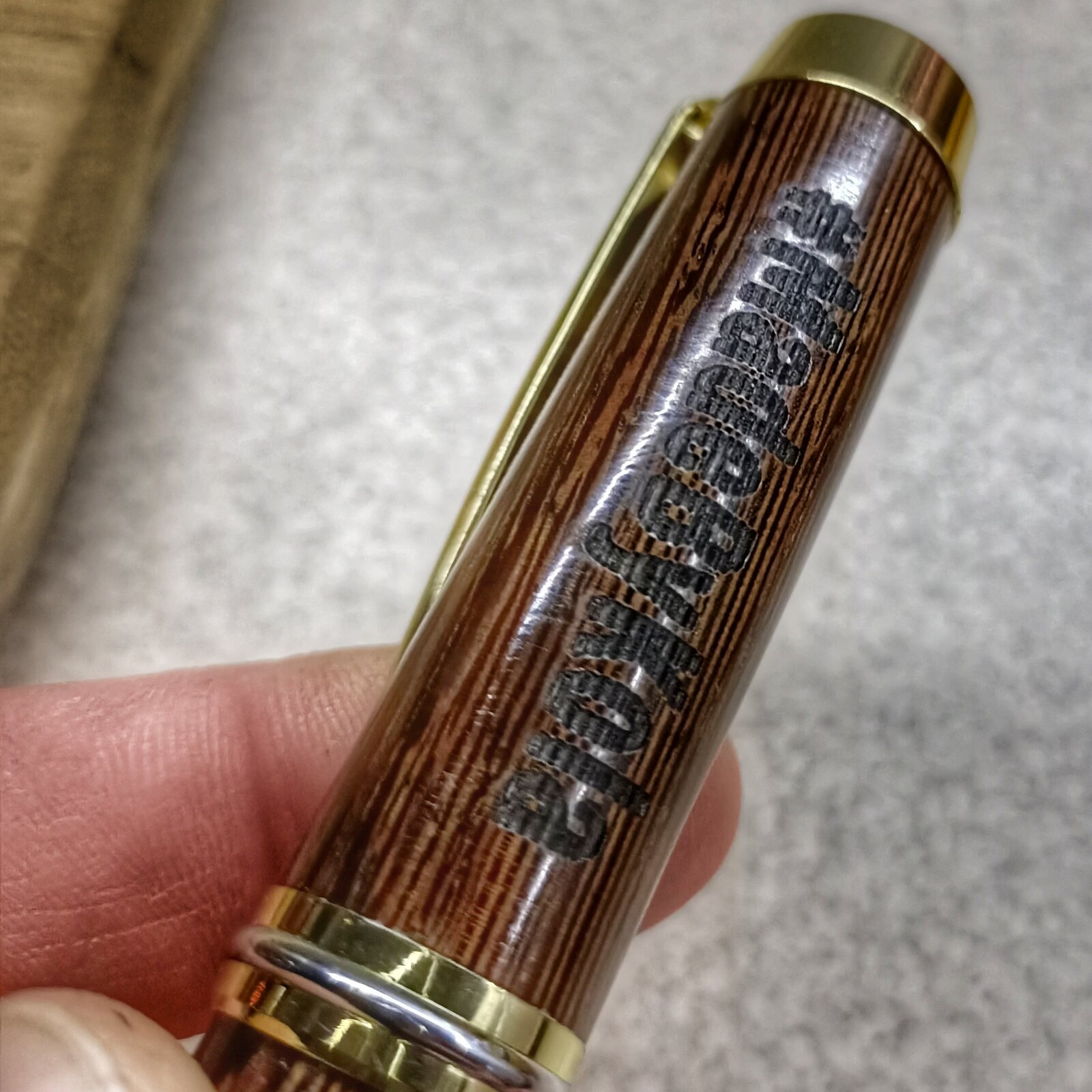

I also have a laser recently and this is my first attempt on a CA-finished fountain pen.
