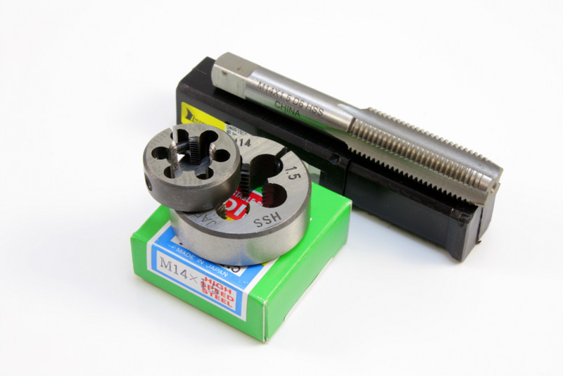

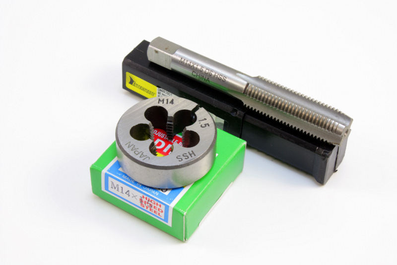

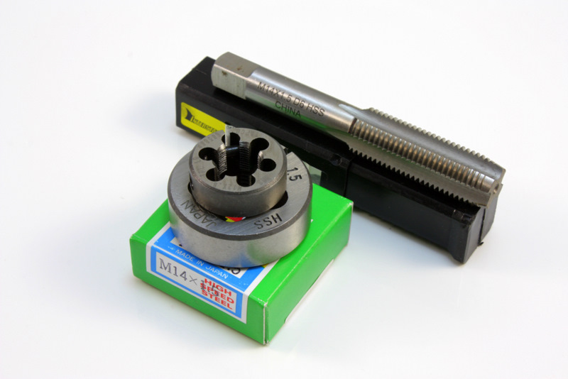

I remembered I had actually bought a 1 1/2" die, a M14x1.5, also intended for penmaking (kitless).
So I decided to have a look at that one to see how the 1 1/2" looked size wise.
index.php
I must say I was surprised at the size of the thing and compared it to the 1" M12x0.8 triple start die I bought recently.
Here is another comparison shot
Just to put these sizes in perspective, the amount of "meat" between the clearance holes on the 1 1/2" die is 5.5mm, on the 1" die it is 2.45mm. As the 1" die is a M12 size, the amount of meat on a 1" M14 die would reduce by at least 1mm to no more than 1.45mm.
Hope this will help some people to decide whether to go for a 1" or a 1 1/2" die.

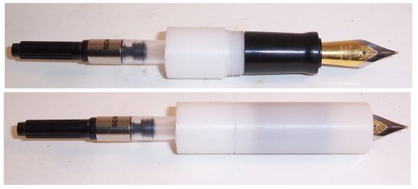

To show what I am talking about, below is a demo pen I made a couple years ago from clear acrylic. You can see all of the cap threads whether or not they have the lower body screwed into them or not. In my mind seeing "half" the threads isn't any better or worse than seeing all of the threads and using a bottom tap will still allow one to see the threads in a translucent cap.
Another thought...... In going to pen shows and seeing vintage pens, some nearly 80 years old now, there are many translucent pens out there and you can see the threads in the cap and some of these models are highly sought after so I have a suspicion that seeing the threads is not considered a flaw and is considered OK.
Not trying to convince anyone one way or another how to make their pens, I'm just trying to understand the need and if that's the only reason, I'm not sold.
While we're discussing what can and can't be seen, here is another thing folks need to consider when using lighter material. Even opaque or less translucent material still presents a problem. In the second photo below is a mockup made from delrin, and while you can't easily see the threads you can still see where the threads end and the nib section begins since the engaged threads are showing "twice the white" which abruptly ends where the black section begins then the light area of the gold nib on the top. In a completed pen this would go dark again at the top as the finial is glued or screwed in.
Here are the two photos showing the threads and the light and dark situation mentioned.......

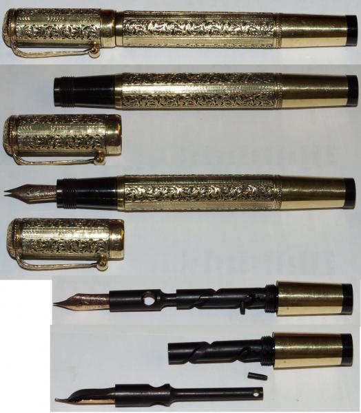

What is a safety pen and how will the bottom tap come in handy?
George:

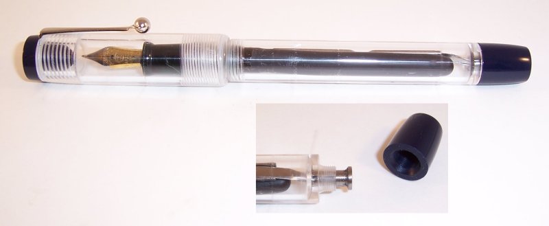

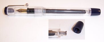

Safety pens were among the first reservoir pen designs. It's a type of eyedropper pen. They were invented by, I believe, Waterman around the turn of the 20th century. It has a retractable nib. To use it, the nib has to be extended by a screwing action and to store it, the nib has to be fully retracted again. It's cumbersome to use, but that was the state of the art back then. The thread is found at very near the bottom of the cap and at the end of the pen barrrel. There is a little rubber or cork piece inside the the bottom of the cap to provide a seal from leaking ink.
To be clear, one would be unlikely to make the inside thread of a safety pen using a 14mm tap and die set. Probably something in the 10 mm range would work better.
Steve
Attached is a picture of a safety pen I bought on eBay a few years ago. The last couple of pictures show the internal corkscrew mechanism. It would be fun to make one with the 14mm tap and die set we have. You may even possibly be able to do it without using a bottoming tap. I think a 14mm diameter would be big for sure, but probably not excessively so. It will just make it more comfortable to grip. You can fit a big nib in a 14mm diameter barrel.
Steve

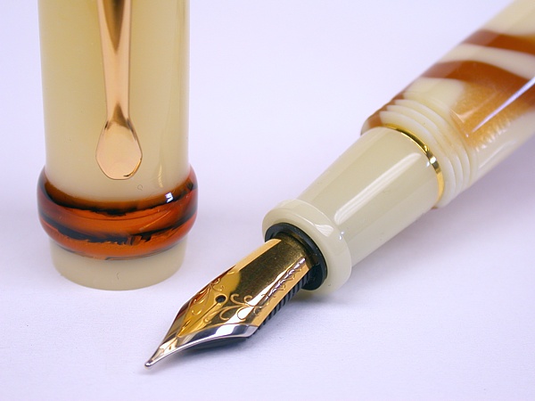

STEVE said: "I think a 14mm diameter would be big for sure"

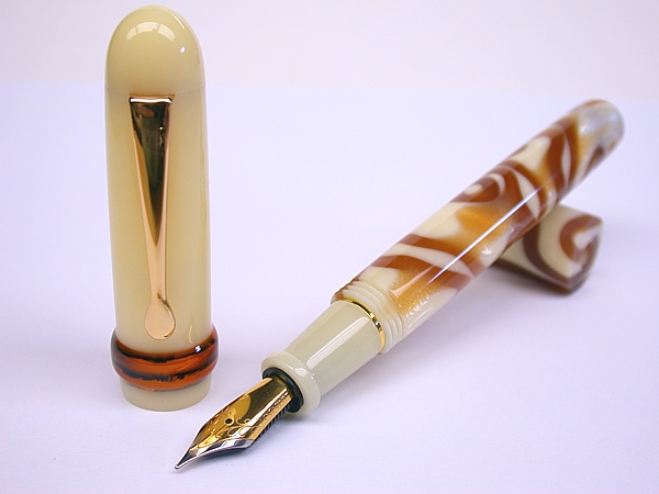

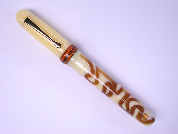

Steve, I posted one of my other pens, but here is one I recently finished that I used a similar sized threads on. The M14 set in the group buy that is currently running will allow me to add multi-start threads to these.
The only REAL difference in the pens (this vs a pen using an M12 threads) ---other than the slightly oversized cap that is a style choice-- is that it doesn't have the step down from the barrel to the threads that you would have on smaller threads.
Other options that a larger threads offers is being able to play with the nib holder styles (if you make your own). The smaller M12 threads keeps the nib holder size down pretty small and thus limits the style options. The larger threads opens up the cap diameter so you can go a little larger on the nib holder and play around with different style options.

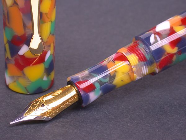

As for the bottoming tap, attached is another pen (confetti) where the threads show through in some areas where the acrylic is clear (see the area around the bottom end of the clip). The bottoming tap would help to keep the number of threads in the cap to a minimum rather than having it twice as deep/long than would be otherwise necessary due to the taper. That (confetti) pen by the way has the M12 threads.
All in how you use them...John
Pen Specs:
Size / Length:
Capped: 6"
Uncapped: 5 3/8"
Nib: #6
Clip: 1 1/2"
Size / Dia:
Barrel: .59"
Cap: .65" (not including band).
