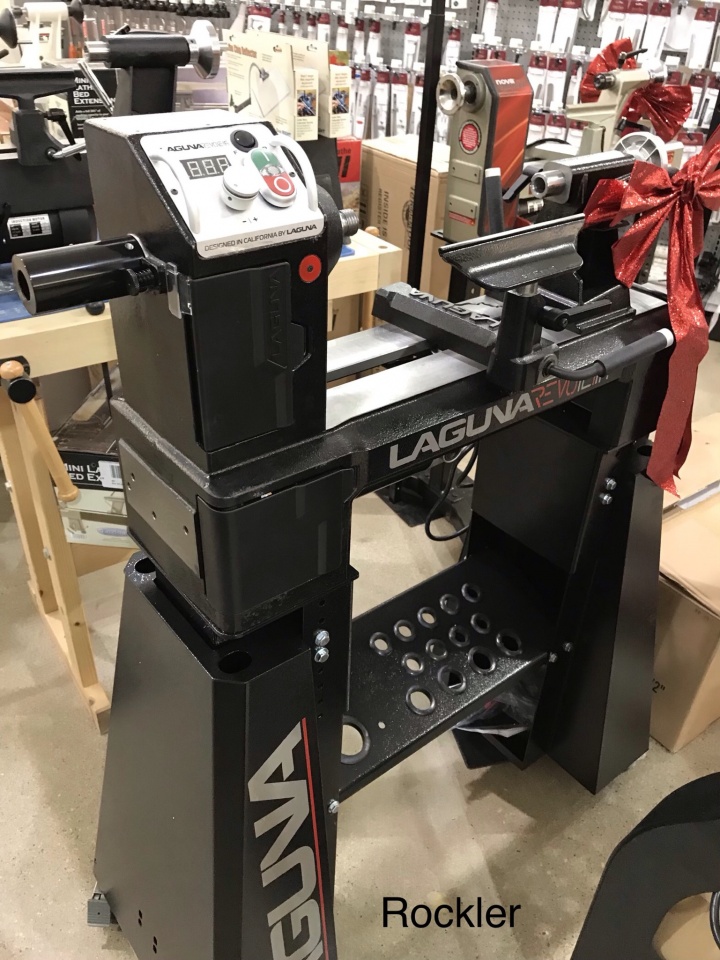

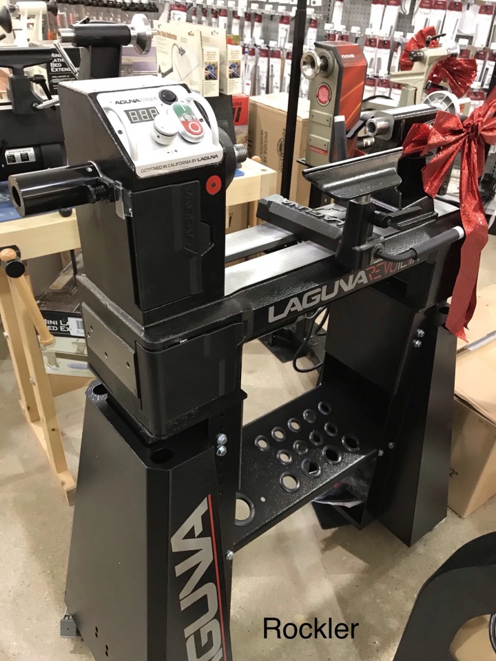

Been looking at it myself. My speed controller seems to be on the way out in my Delta 46-460. So I was looking at this one as a possible replacement. Got to eyeball it back before Christmas at my local Rockler 's store.
