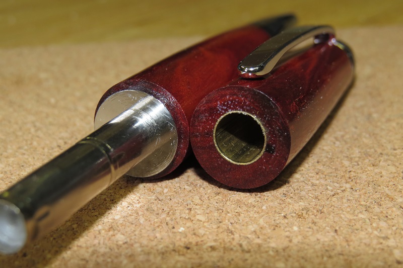

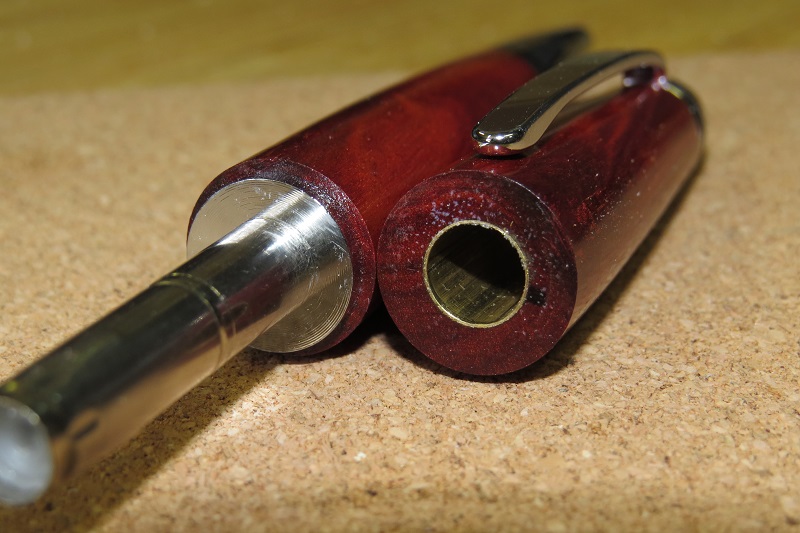

Tony, the Curvados I posted in SOYP is fairly beefy - if you use the bushing as a guide for the center near the band, its a hair over 1/8in thick there, as shown below (its an 8mm tube).
If the top tube is 8mm it isn't a Curvado (at least not a PSI Curvado) it is more likely The Graduate which as a 7mm bottom tube and an 8mm top tube...the Curvado is 7mm all the way.
I'm pretty sure its 8mm (mine are, and seems to indicate so at the PSI website Curvado Chrome Twist Pen Kit at Penn State Industries), and it takes the Parker style refill.
Maybe you're thinking of the Concava - that is definitely 7mm / Cross all the way.
