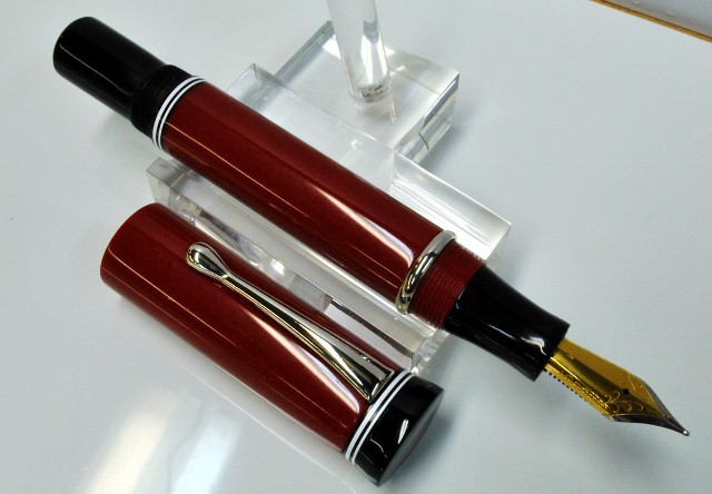

I use 7.4 x .5 tap for the Mesiternib #6 nib holders, which carry my favorite nibs.
I use mostly the 10 x 1 T&D set for the section/barrel joint.
I use mostly the 14 x .8 T&D set for the cap/barrel joint. You should start however with a 14 x .75, which is much less expensive and only slightly inferior. Below is a typical pen:
attachment.php

Seriously, the main thing that made "kitless" pens easier for me is retirement. You will need lots of time to learn before you get your first one done. Then too, I've been doing them for about 9 months and I still spend anywhere from 4 to 10 hours on a pen. I just finished another pen like the one shown above in about 6 hours.
