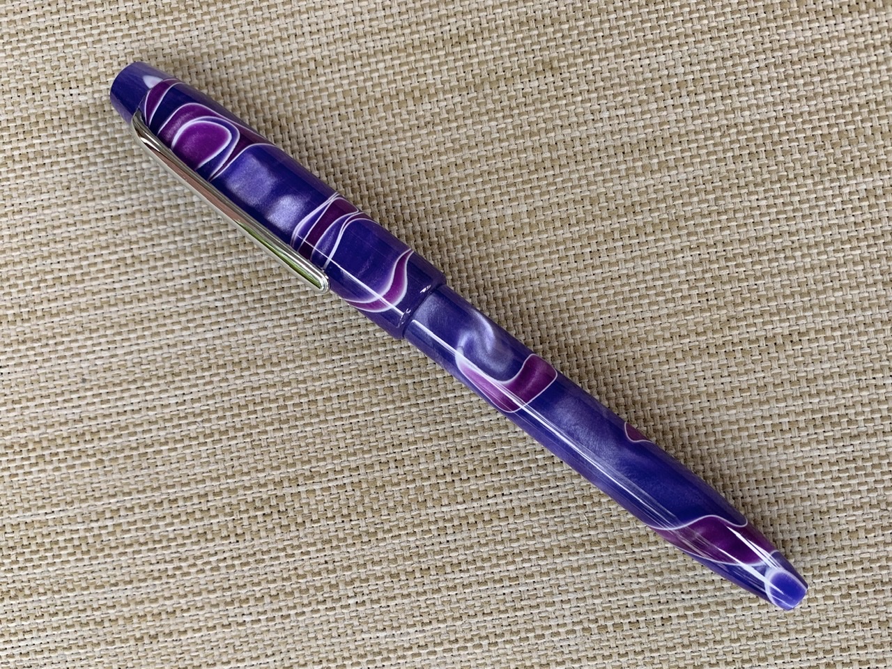

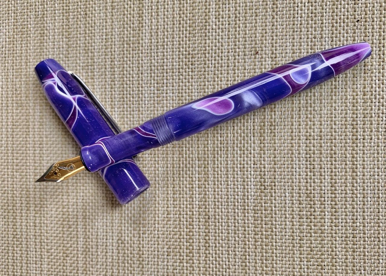

2 full days in a row in my shop! I can’t remember the last time I could say that. This one took a full 8 hours without a break for lunch. I made this after the same pattern as the aluminum one I posted yesterday. However the ODs are a bit larger and the tapers not as aggressive to preserve wall thickness in the acrylic material. Really light weight at 16 grams capped and 11 grams without.
