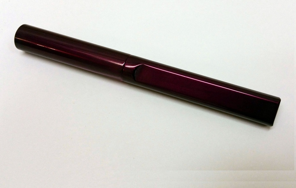

Today's fun :smile:

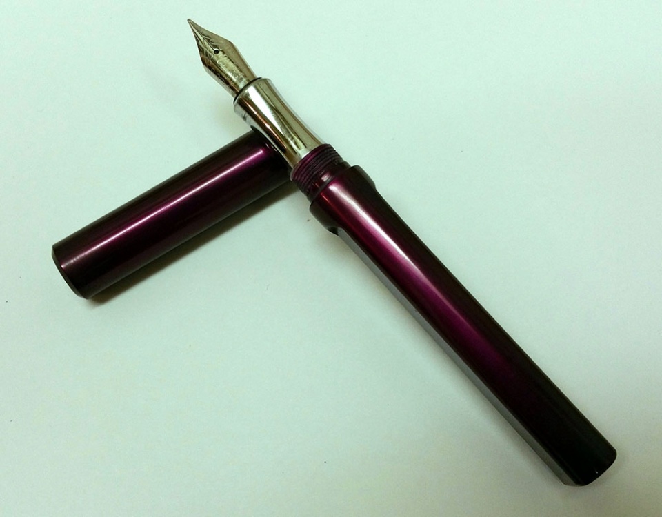

An aluminium fountain pen, with milled sides, anodised purple.
Thanks for looking :smile:

Very nice Brad. But it begs the question, how did you mill the sides? Did you do it on the lathe or have you already bought a new toy...err... tool?
Mike
I done it on the lathe Mike, by putting the pen in the tool holder (QTP, with V groove on tool holder) and mounting a 12mm slot cutter in the chuck. It give's you an X & Z axis if nothing else lol
I have actually purchased a vertical slide for the lathe, but I'm reluctant to drill holes in the cross slide to mount it. Think il just wait until I have the mill instead.
Great pen Brad - I like the method mite try it out - what speed did you run the chuck at ?
It was at 500 :smile: Nice work you're doing by the way. you're using Ferric by the looks of it for your etching?

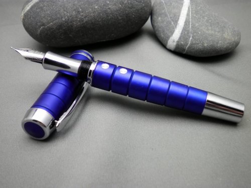

Compare these two pens:
Both of these have been anodised and dyed and cleaned exactly the same way. the only difference is one was polished to a high shine by sanding upto 12,000 before anodising, and the matte one took a bath in caustic soda for a few minutes so that the aluminium was very matte in appearance before anodising (Caution: fumes are nasty, and it will dissolve threads!)
Hi Brad I tried out the slot cutter in the chuck milling process today and it worked a treat - thanks Jake
