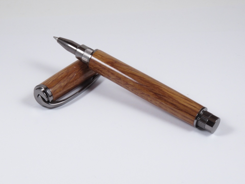

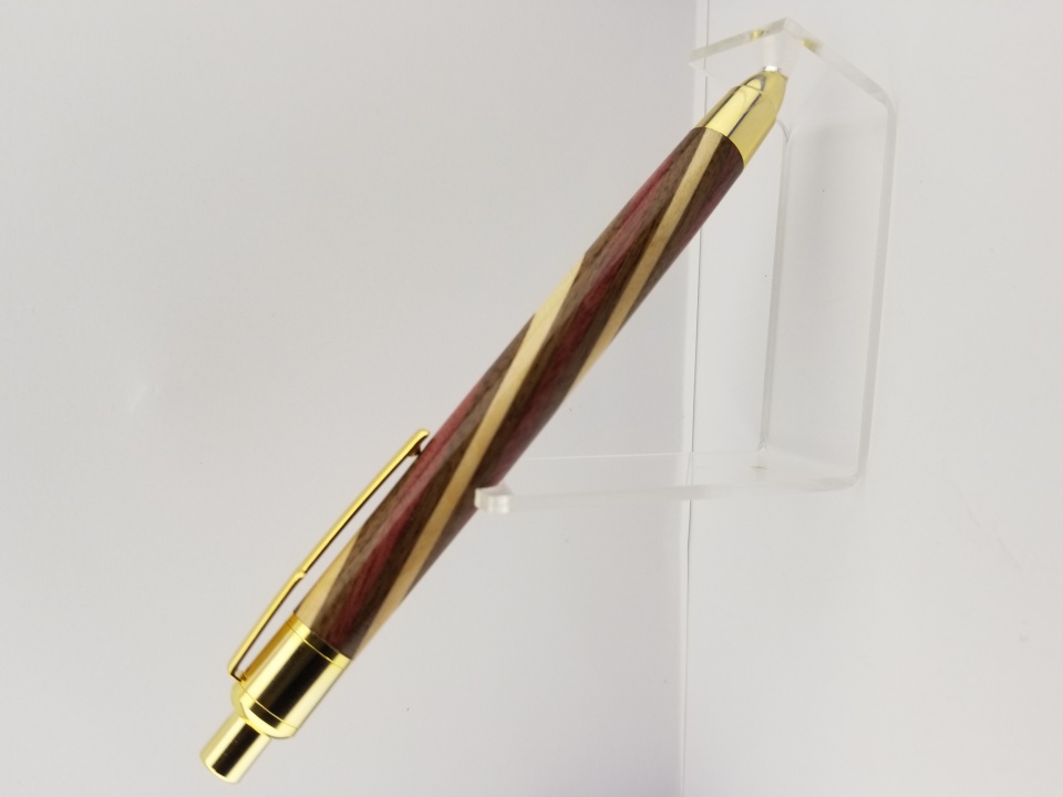

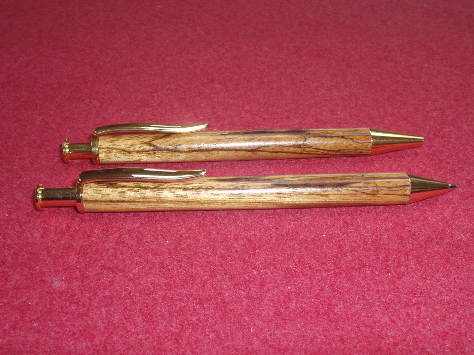

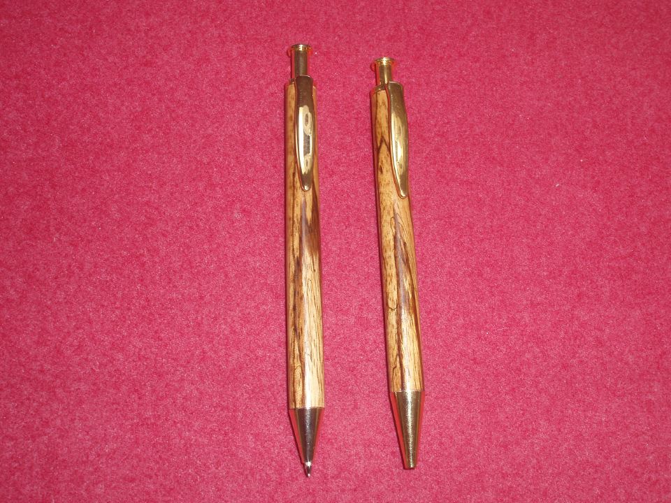

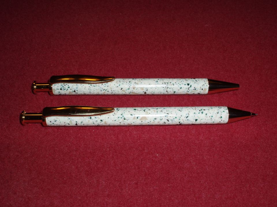

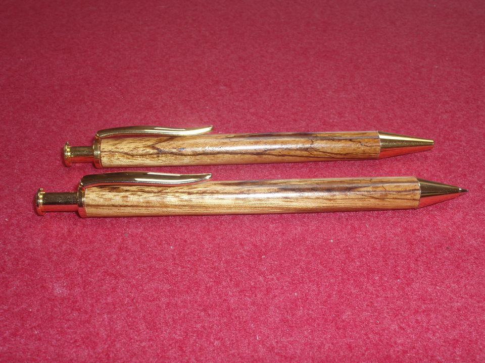

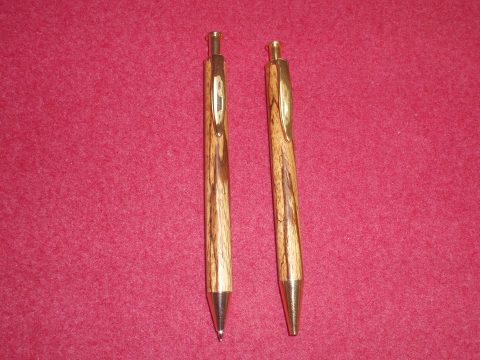

Here is the same Rockler Long Wood pen and pencil kits as above. This time in zebrawood.
