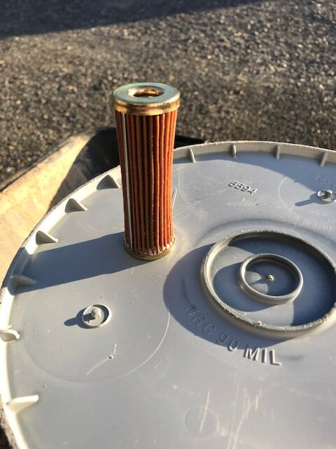

This appears to have been culprit
This seems to be the culprit
Gimpy: Good you found problem, Maintence on fuel filter at least one a year or 300 hours on engine.
Filters are cheap, injector pumps repaired are expense.
