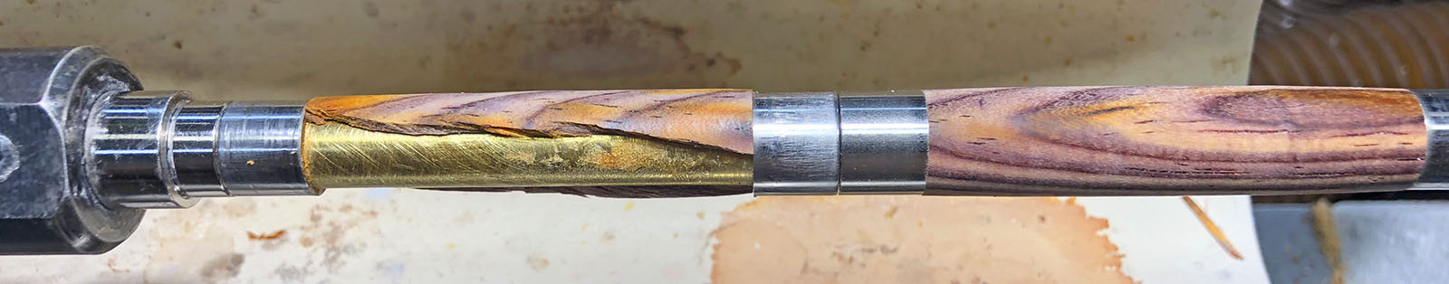

Well, you would think I would have learned my lesson already, but obviously I haven't. I can't remember how many times I've preached about making sure the tubes were glued in solidly before turning. Well, I was trying something new (for me anyway) today, a Cigar pen with only the little thin center band, so yes, I got in a hurry. Instead of epoxy I used thick CA to glue my tubes in - or should I say partially glued my tubes in.
Just as I was finishing up the light cuts to get down to the bushings, - Bang! - half of my lower blank disappeared. Actually, all of my lower blank disappeared, I just happened to find the half that is in the picture and snapped it back on the tube. The evidence is obvious that I didn't get the tube glued securely and completely before I started turning. Ok, I will start over, with epoxy this time.
It's too bad too because I think the Cocobolo blank was going to turn out very nice - lots of color variations.
Lessons Learned (again). Be patient and use epoxy to glue the tubes in or someday (today) you will be sorry!

Dave, In the past most everyone who experienced this thought that they had securely glued it. What is missing is the "not understanding the unseeable air bubbles that get caught when inserting the tube, far more than most would imagine. Filling, pushing and twisting with CA and even epoxy, air enters. But Epoxy holds better and is less brittle.
I learned my lesson over about 5 or 6 before changing to epoxy. I was a slow learner, but I did learn!
