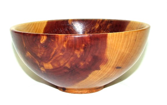

Hot off the lathe.
Juniperus virginiana (Eastern Red-cedar)
Size: 6 1/2 x 2 1/2"
ERC is one of the top contenders on my list of wood to find and keep around too! This is just another fine example of a wonderful piece of timber be finished just right!!!!
Love the shape of this one. Simple, yet elegant too!!!
Scott (nice finish) B
I love to turn Cedar. But it can be frustrating it checks and cracks very fast & easy. I have worked with it green and logs start to check with-in minutes of cutting with a chain saw. And turning on the lathe as you get down to size I can hear it cracking as it spins on the lathe. But the finished product is nice. Looks like you got a nice finish on it. I found it not to be forgiving when sanding and can be a little difficult to get a good smooth finish with no sanding scratches.

I keep coming back to have a "perve" on this bowl, the grain is spectacular and the little bit of sapwood is a great contrast. I hope some of my blanks turn out somewhere near as good as this.

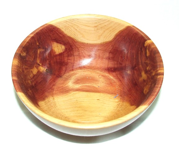

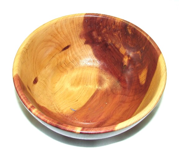

Ok so check this one out. This one has *NO* finish at this point.
4 1/2" diam x 2 3/4" deep.
On this one all you see is raw wood. small hairline cracks but I think that add's to the apeal, none of them are that deep. I sand with Abranet screen. I use 80 grit 3" circles on the hand drill, this is some very brutal stuff and you will see loads and loads of dust flying, 0 build up unless you are wet sanding. Then I switch to sheets and go at it by hand. 180 grit, then 400 grit. An alternative I use 220 grit and 600 grit. Thing is with cedar you don't have to use every single grit and can skip heavy and get the same results.
Oil finishes I use tried and true finish, it's polymerized linseed oil and bee's wax. The consistency is thicker than pancake syrup and works very good.
I really like the bowl and it's shape. I like cedar and only finish cedar with a wax that I make out of bee's wax and mineral oil. I find that woods like cedar and redwood don't take a finish very well.
