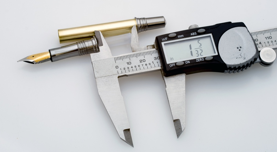

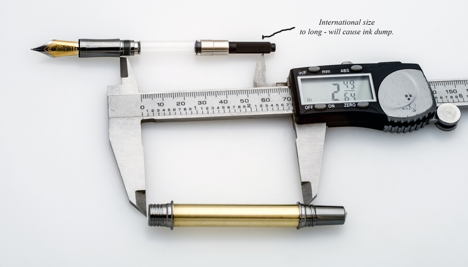

Ok here are the photo's.
Here we have a depth measurement to the spring.
These are samples from Signature Pen Supply the Black TI Aaron with Rhodium highlights.
attachment.php
The tube is on the bottom, the caliper is pre-measured for the detph and the top shows an international cartridge. Note the extra length hanging over the side, this will come in contact with the spring and will dump ink when it is screwed in.

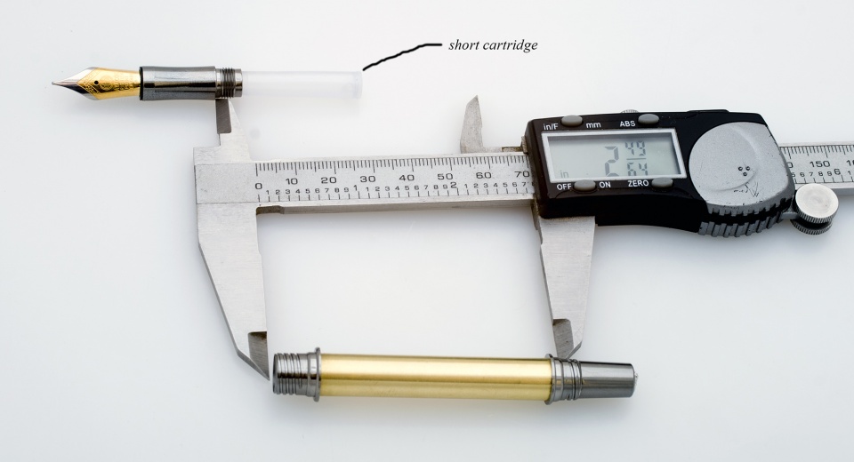

Up next we have a short cartridge. More common place now days.
attachment.php
Note here the GAP between the end of the cartridge and where the spring is. (Right edge of the caliper on top)
Adventuresome turners would shorten the lower barrel in adjustments of this to only use the shorty refill cartridges and make posting the pen much more enjoyable. :)
attachment.php
Note to, my measurements may not be the same as what you measure. Measure it before chopping the tube.
