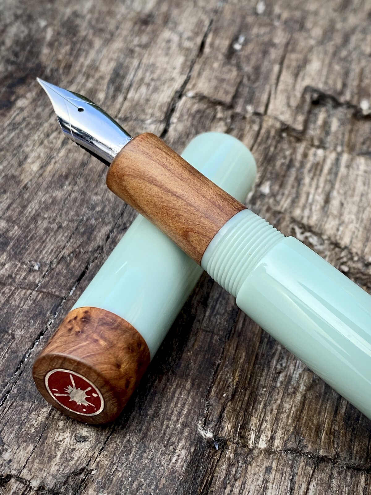

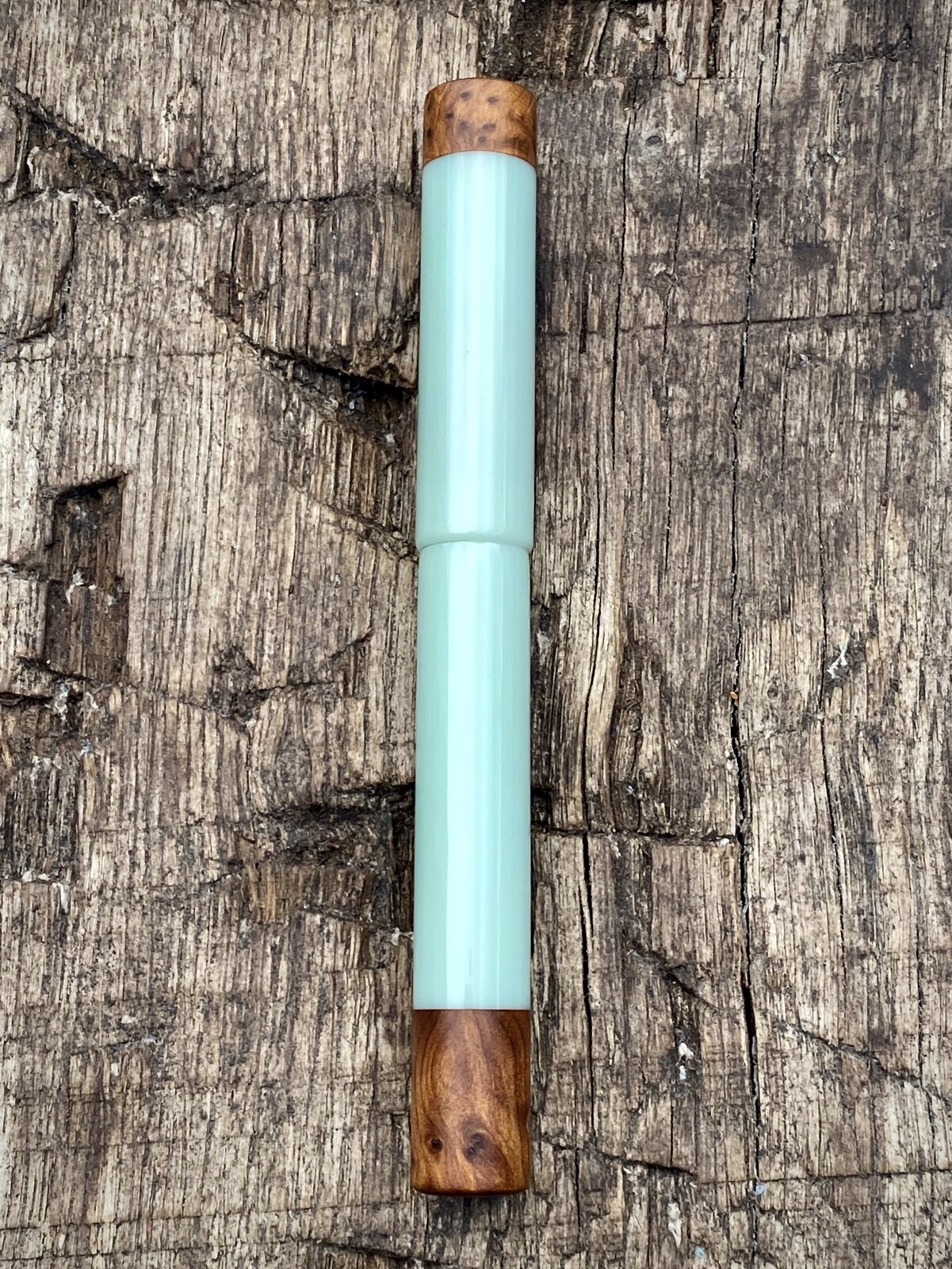

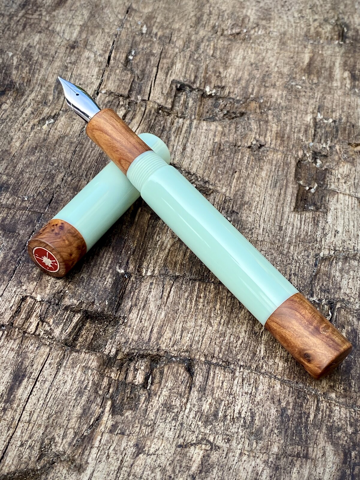

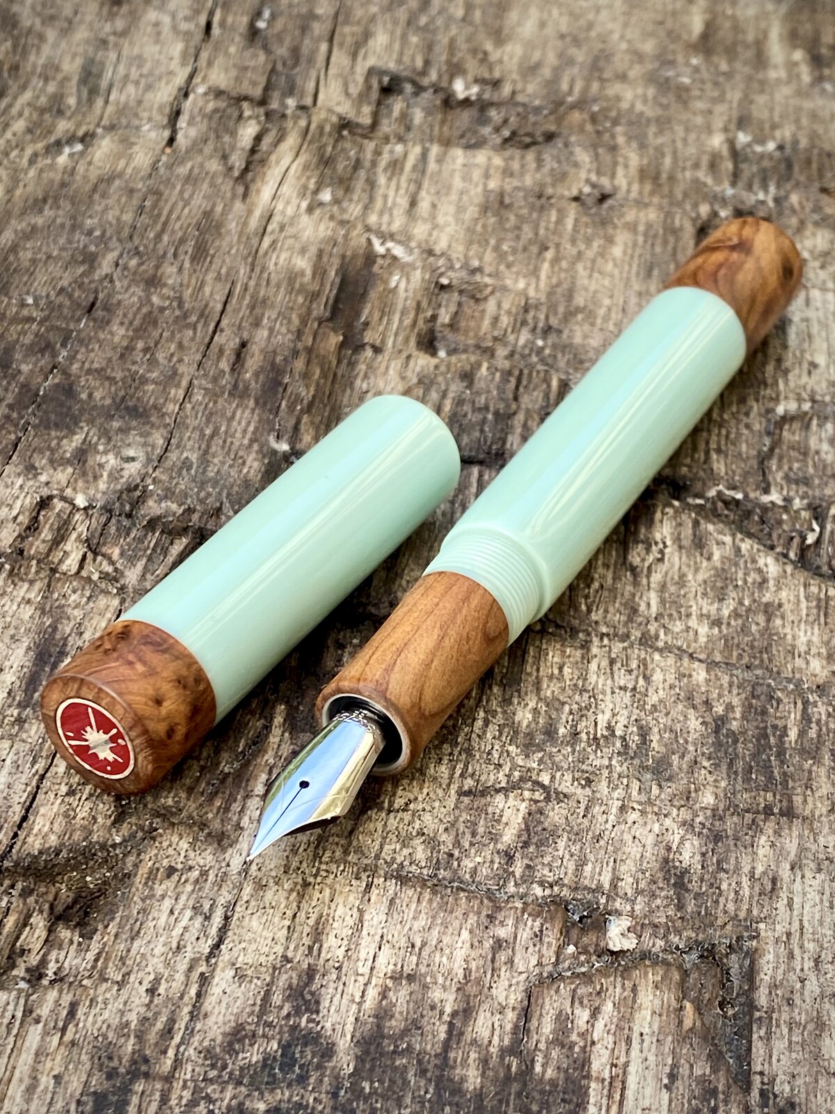

I was after a particular retro vibe with this pen. It is made from Italian acrylic and thuya burl.

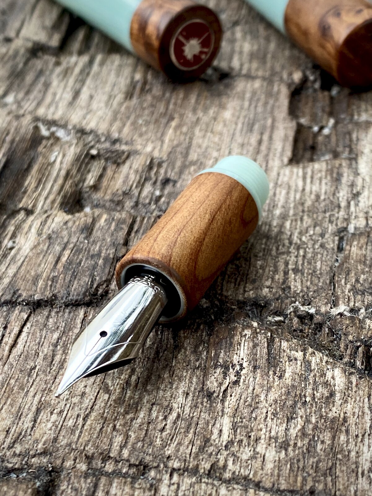

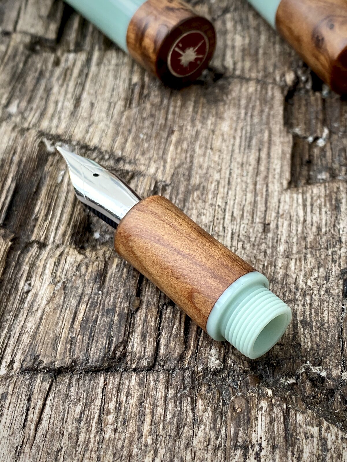

Nothing too complicated, other than the section is made from acrylic with a wooden sleeve. The main consideration being wall thicknesses of the wood (it’s a no6 Jowo nib and 13mm cap threads). The wood is stabilised so it does help with the integrity of the piece a little too.
Getting the silver/red logo coin to fit snugly also takes a little bit of time to get right. The trick here is to drill an undersized hole and bore out the remainder to sneak up in the correct diameter.
Length closed: 140mm
Open: 134mm (cap doesn’t post)
Nib: Jowo 6
Cap threads: 13mm
Barrel diameter: 14.5mm
Cheers
Ash

Looks really, really good. I’m partial to combinations like this.
Did you make the cap decoration?
Sent from my iPad using Tapatalk
Thank you.
The cap decoration is cast in sterling silver and filled with resin, although I sometimes leave it just silver.
Cheers
