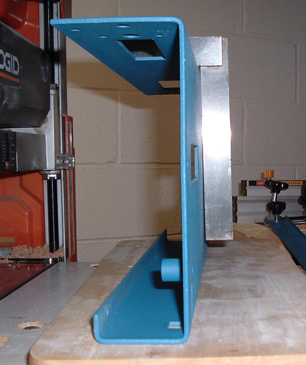

During my first cut, after an hour of setup, I noticed the 2 boards were not tight together. I figured I was not careful enough on the test pieces so I went ahead. The joint needed some adjusting but was not terrible.
However, after checking the ends, all is square and true.
I took the unit apart and found the problem.
This is the face and top surfaces, where the boards lay. This is out an eighth of an inch across 3/4 of the bed surface. This is pretty stout metal and I'm not sure I can bend it to where it is at a right angle. I really don't have tools for this kind of thing.
At this point I'm not sure I want to try.
Maybe I should take it back and put the $35 toward a 4210 PC jig.
Any suggestions?

There are so many of these units out there and all by different names. I do have the Porta Cable unit and yes it is a nice unit but very finicky and set up time is involved. But dead on accurate. There are also many other good quality units, Festool, Leigh, Keller,and some like Craftsman.
To your unit. I am guessing what you are saying when butting both boards they do not come to a perfect 90 degree angle and is throwing off your fit. I see a couple options. One take it back and get another. Try one from Grizzly or Rockler. Take a board and place on the edge and try to hammer it in shape. Or you can jury rig it and place strips of tape on the tail end (short fence). Build up the tape till it sits 90 degrees with the pin board. Keep tape on the very lower edge of the fence. Or make a wedge to compensate for the difference. I would not be inclined to do this but it is an option.

I'ld have grabbed a few 6" bar clamps and set them up to spread the lower leaves till the top was a true flat, and saw if I could use it that way ...

Dale: being a tool collector, I have picked up many different styles and brands of dovetailing jigs over the years. Many fall short of their objectives, and some are just junk. The best ones for cutting dovetails are my Leigh 24" and my Japanese dovetail saws and chisels. I like the Leigh because I can cut many types of joints, cut large boards, and adjust the joints in any fashion and spaceing I care to. There are two factors that choosing a jig comes down too. The first being how much are you going to use it and what for. The second one is how much do you want to spend for the ease of use and accuracy of that machine. As for how to fix the problem of a jig that is not square. I would clamp the lower edge down on my work bench tightly. Find the surface that is not square, and with an adjustable pipe bar clamp, raise or lower that surface until it is 90 degrees and square to the adjoining surface. If, however your jig bends that easy, you made the wright choice by returning it and ordering a new one of higher quality. Jim S

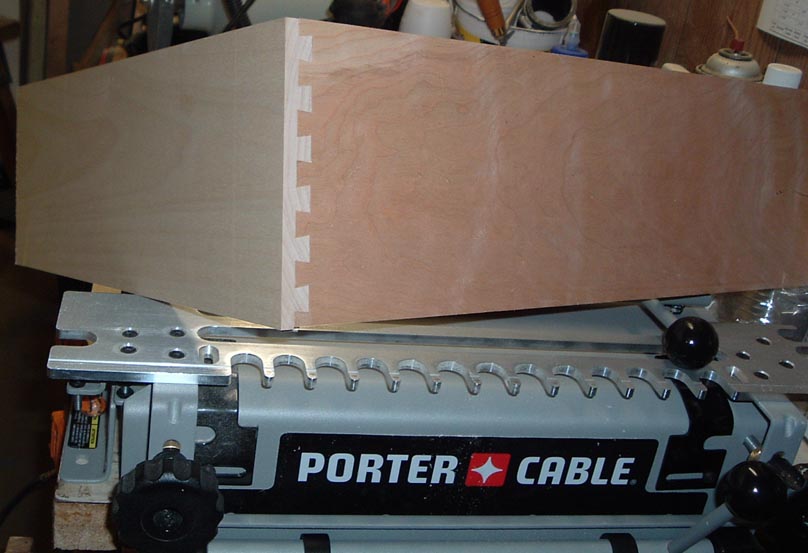

Well, I'm glad I got the PC 4210.
Boy what a machine!
This is one adjustment after about 40 minutes of setup.
This will be just fine with me.:smile:
