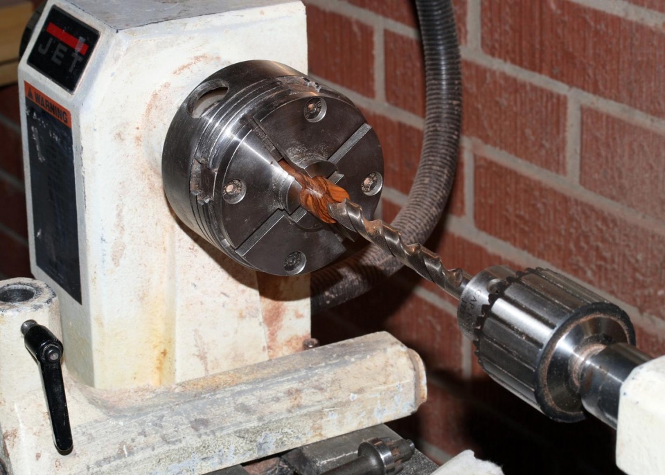

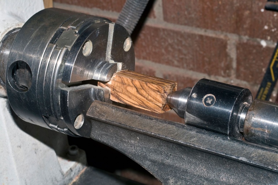

I started drilling on my HF mini lathe with the $80 dedicated pen blank chuck (along with a 1"x8 tpi by 3/4"x16 tpi reducing bushing and the MT1 drill chuck. UNFORTUNATELY, I need to buy a new drill chuck or JT33xMT2 adapter for my new Jet lathe. I think the reducer bushing was about $10 from PSI plus $80 for pen blank chuck and $35 for drill chuck.
The jaws make the difference.
attachment.php
On mine I use some 1" jaws, it's not a 0" fit but it does the job for most things.
attachment.php
The #1 problem with MT1 is typically the motor size is rather small and the heavier tooling you add on there the more it causes problems and shortens the lifespan.

Your spouse is a keeper if supporting this hobby. I have two G3 and love them. They get the job done and nova now makes a jaw set for pen drilling. I do not own it but it is similar to PSI it does look a little beefier on the screen shots. I have not seen it in person but I believe woodcraft carries them.
I believe you're talking about the pen jaws kit. I saw it was only 2 jaws? I think... but if it lives up to their reputation i know it will be high quality and useful all the way.I ordered that as well.
Quality Pen;1630403I believe you're talking about the pen jaws kit. I saw it was only 2 jaws? I think... but if it lives up to their reputation i know it will be high quality and useful all the way.I ordered that as well.[/quote said:
Yep. I got them a few weeks ago and really do not see me drilling any more pen blanks on my press ever again... Works great for both square and round blanks. The only thing I may say (have not run into it yet. just thinking...) is if you have a square blank that is twisted or warped, I would probably drop it between centers and round it out true before drilling...
