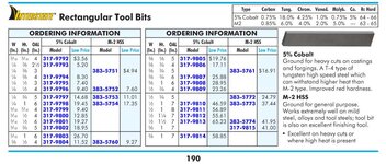

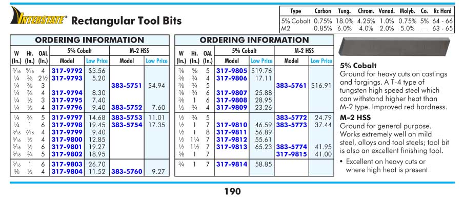

I am thinking of ordering one or two of these to make some custom tools.
From Enco.
