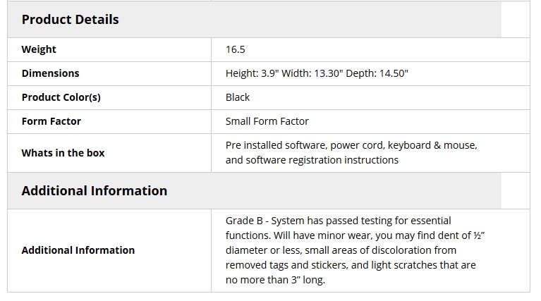

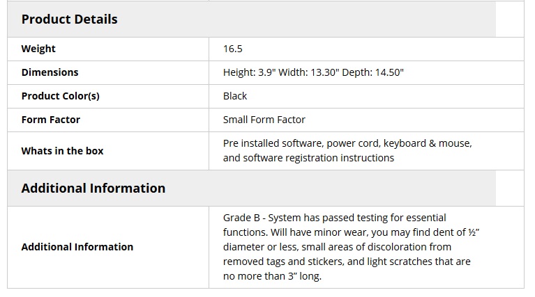

Oh ... new update ... did a little digging on that site, this is what's further down on the page ...
attachment.php
So ... awesome! just cosmetic defects and you get the power cord, Windows 10, USB keyboard, USB mouse, and software registration for your legit copy of Windows 10.
