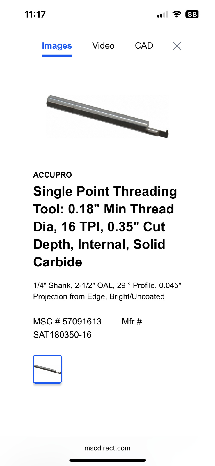

You can get tools like this. Solid carbide.
Hi, @hooked and @rherrell,
Thank you so much for your feedback and recommendations. I have searched for Micro100 and found a Lithuanian supplier that carries them. Since I am inside the EU, I will probably purchase from them. I also found a brand called Simtek that sells solid carbide tools for small parts turning in the EU, and I will also check them.
