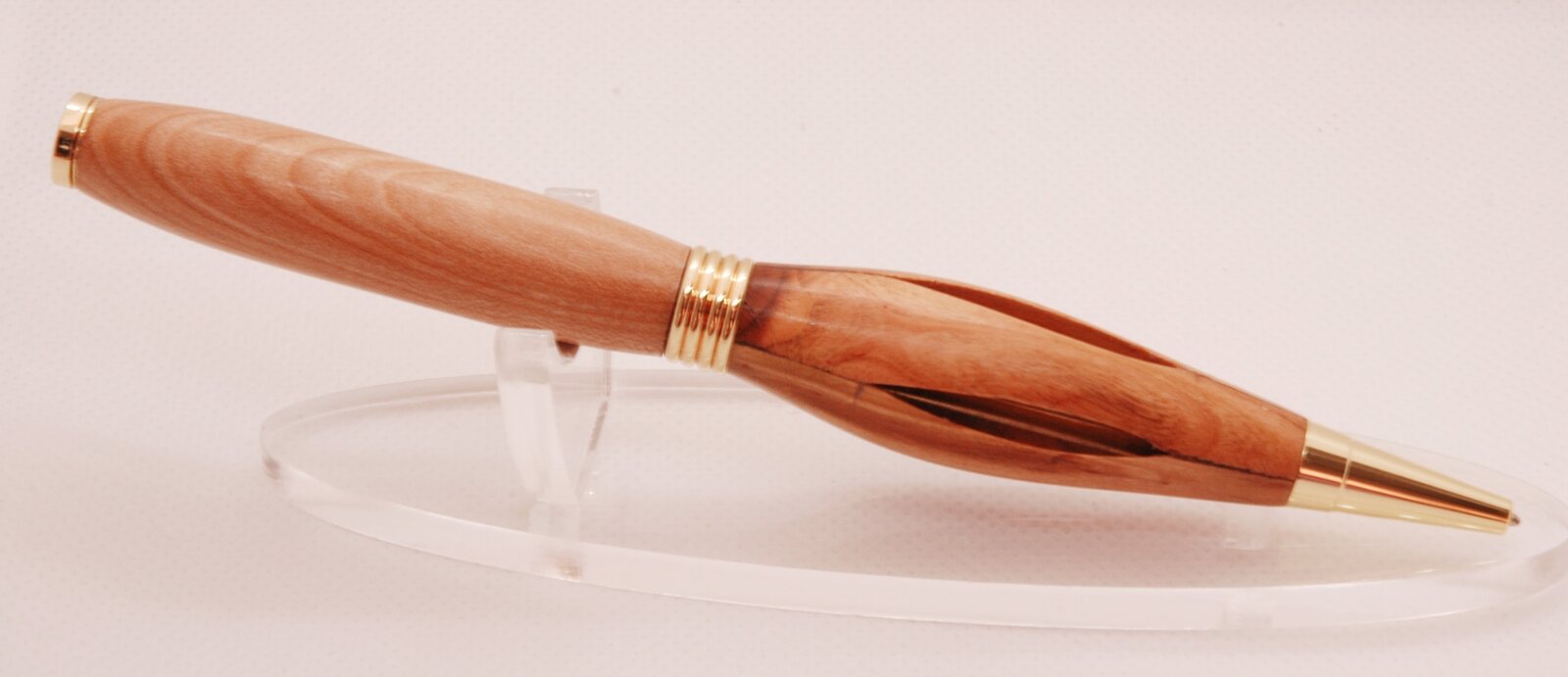

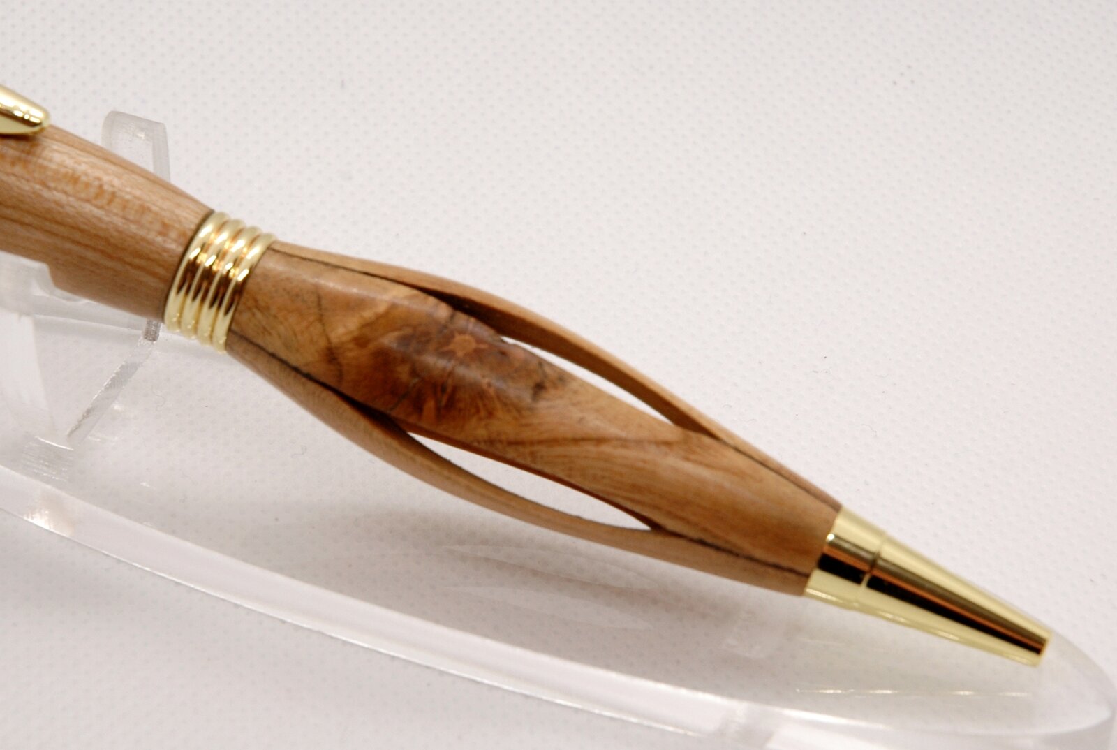

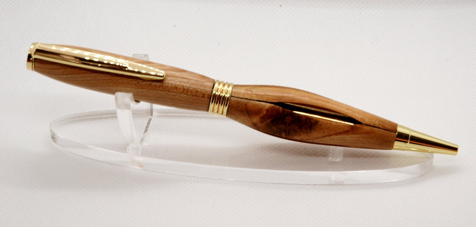

Years ago tried this method of turning something inside out on a Bud Vase. First thing turning the inside quartering the blank and rotating each 180 deg glueing them back together and turning the outside.
The joints are far from perfect but I only have a Bandsaw. I had 5 failures due to glueing finally settled on Epoxy which didn't help to disguise the joints but kept everything together. There is very little wood to play with. Surprisingly the finished pen is quite strong
At least I've accomplished an idea I've had for a long time.
Your comments as always would be much appreciated.

Generally, I like the idea of this innovative design concept.
One issue is the bulge size on the lower barrel ... a little too much from an aesthetic point of view, IMHO.
Another is the visibility of the brass tube on the lower barrel ... Painting the brass tube a matte black would tend to make a feature of the brass tube.
Maybe you could paint it before assembling the wood pieces. Just a thought.

Thank you for your much appreciated comments. I did think of painting the tube but keeping the glue away from the tube impossible.
Because on a pen you have so little wood to play with design is not easy the wood is very thin. I used a slimline kit because the tube diameter. Is small
After a few failures I was just pleased to make a finished pen.

I fully understand the constraints you were working under. . And ... I meant to say ... I am amazed that you accomplished as much as you did !!!
I applaud your ingenuity and patience to complete the project !!!

Michael, good job with the inside out pen. I like seeing something different, and maybe your design will spark other peoples imagination to run with this idea.
What is the pen like to hold and write with?
As you asked for comments....... I would try the inside out turning at the clip end rather than the nib end.
I look forward to your next pen.
Alan
Thank you for your comments the clip end as possibilities. Surprisingly the Pen is very comfortable to hold and Surprisingly feels quite strong.
How long it would last with continuous use no idea but I intend to keep it.

I wonder, as far as people suggesting painting the tube, what about spray painting it after it's glued up and partially turned, then making the finishing cuts?
Not sure how I could do that but I do think the tube needs something doing to it.

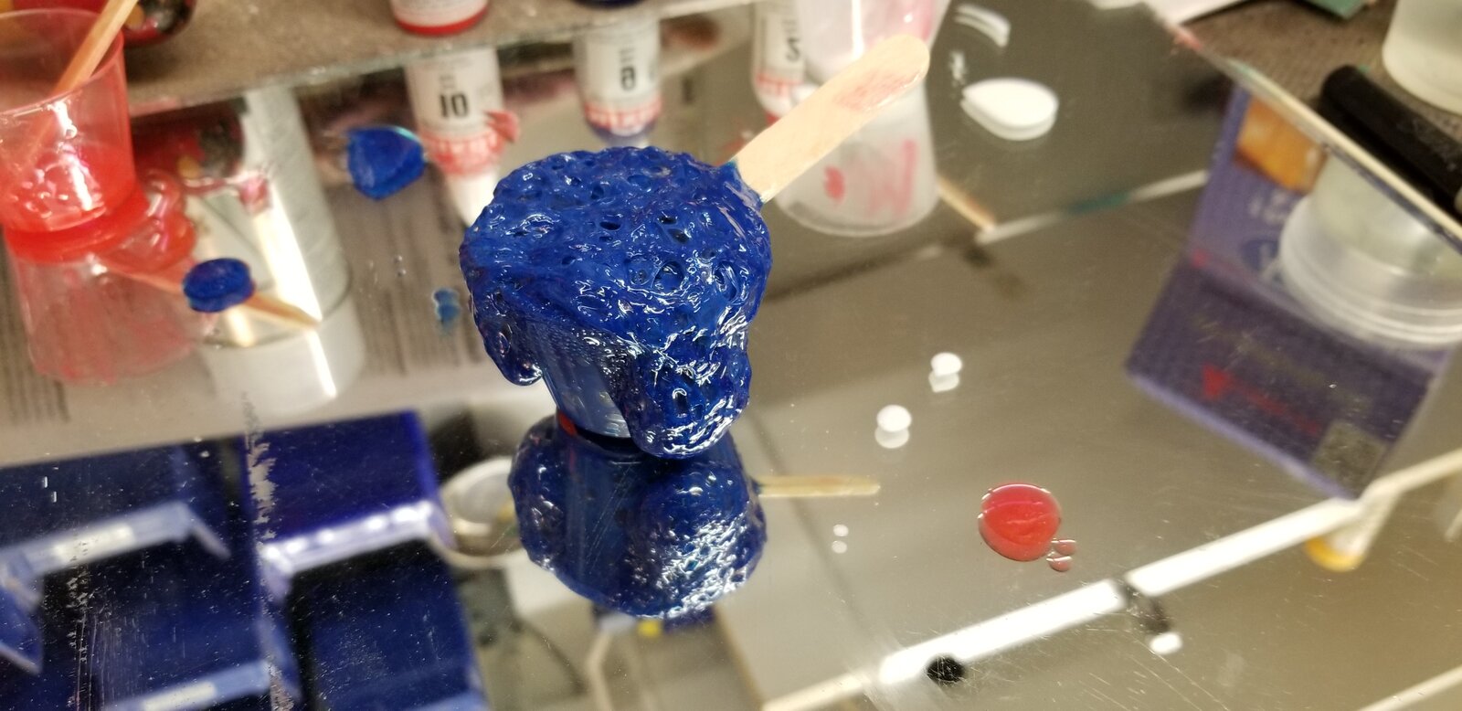

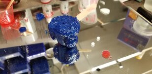

I get mine from Amazon but I think others use Latex paint but I would check on the paint as I've never used it. Here's how it shows up on Amazon
Black Epoxy Pigment (Colorant, Dye, Tint) 6cc (0.2 oz.)
I've used the red and black with good results.
Thanks for the information I'll try Amazon. The next pen of this type I'll use Epoxy glue and try this pigment
Am I right i thinking you turned the blank solid then quartered it?
I've done bud vases etc using paper joints and it's a lot easier. little bit more cleaning up to do before reversing the blanks to turn the inside ( now the outside) but works really well. Never tried it on a pen though!

Yes can't see any point when making a Pen. With larger items you would do it too change the grain match. But on a Pen not so important so I quartered it after doing the inside. Hope this makes sense.
You would put paper in the joints and break apart which would be difficult and I think unnecessary.

I'd be careful with latex paint. Water and Epoxy do bad things. I know some have used acrylic paint but just spending a few $$ on some Alumilite dye or Divine Pigments will insure you don't have problems.
Alumilite dye from Amazon and Divine from Turners Warehouse.
I just happened to think that must have been at least a little challenging to drill after cutting and gluing it inside out.
The drilling went ok I left some extra wood either end and trimmed to length afterwards.

It's actually fairy easy , honest, and would eliminate your joint line issue totally. I use an old plane blade to carefully split the joints apart. Minimal glue ( PVA is good ) and newspaper , then leave overnight to thoroughly cure . Takes a bit more time
Next time I'll give it a go thanks for the advice.
