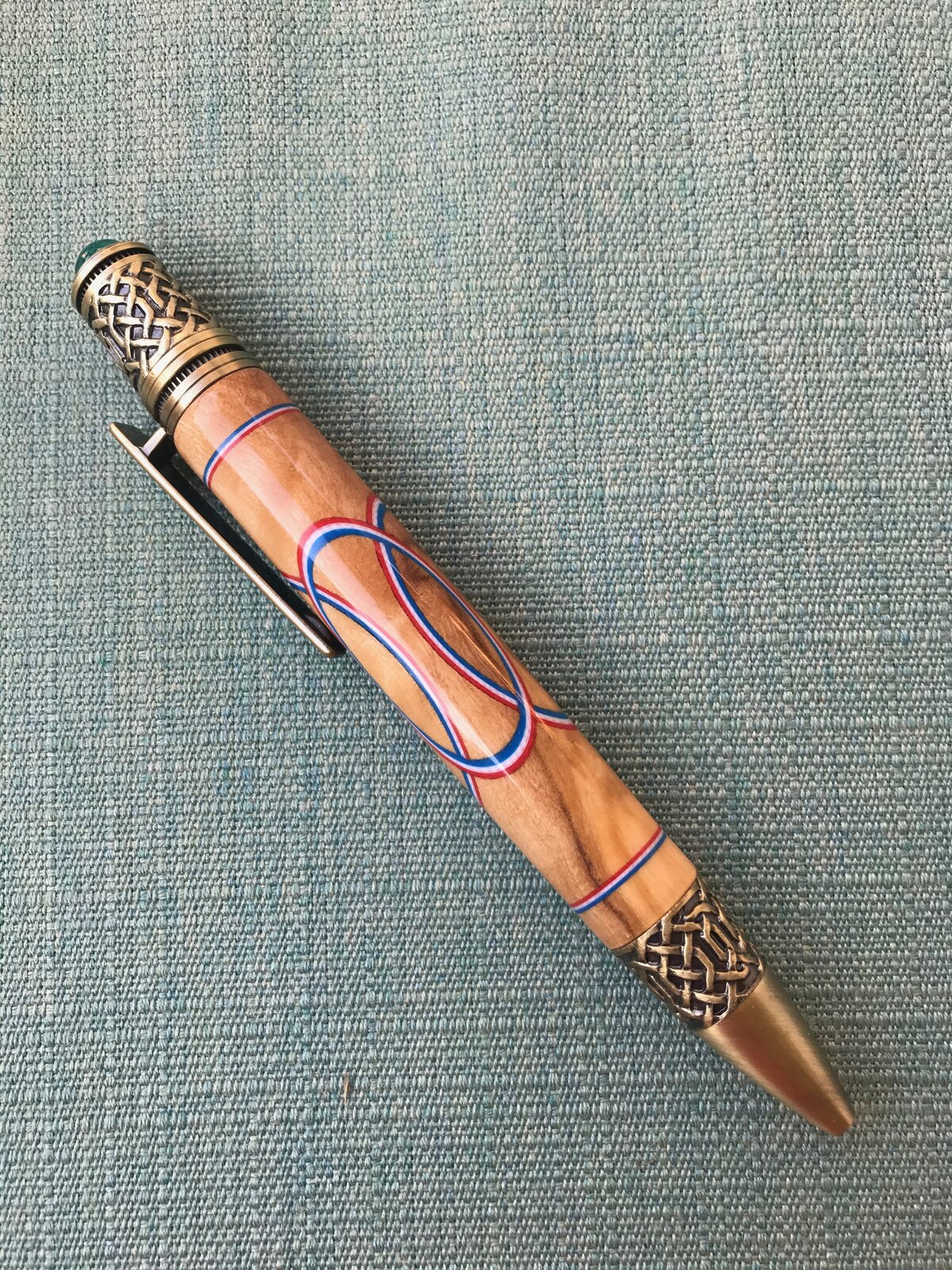

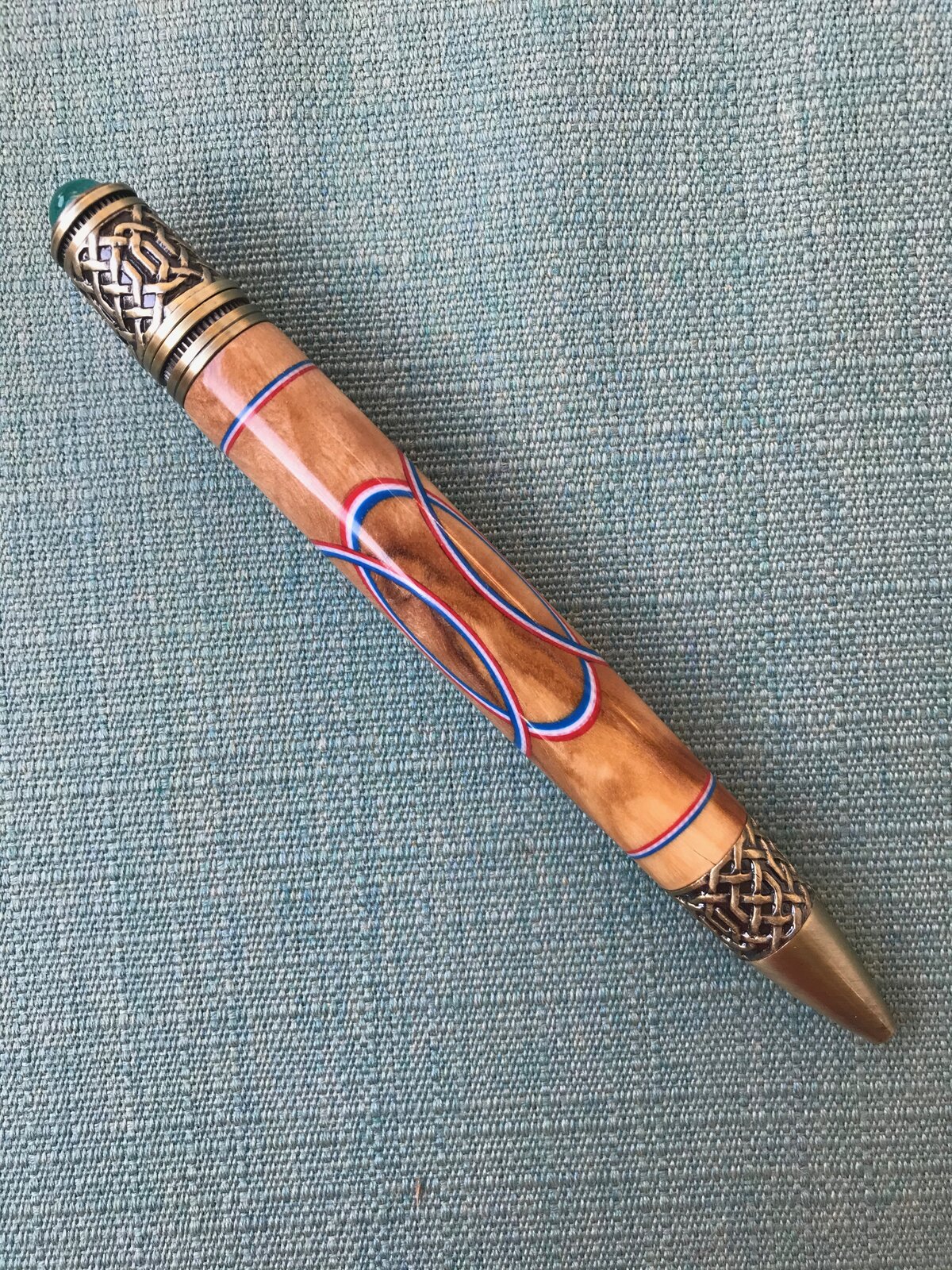

Blank is Olive infill are three ply G-10 epoxy System Three T-88. Teamed up with PSI Celtic Twist.
KenB band saw jig and his three ply design, Thanks KenB for sharing.

Blank is Olive infill are three ply G-10 epoxy System Three T-88. Teamed up with PSI Celtic Twist.View attachment 243450View attachment 243451
Oh My! That is beautiful. 👍 👍 👍
