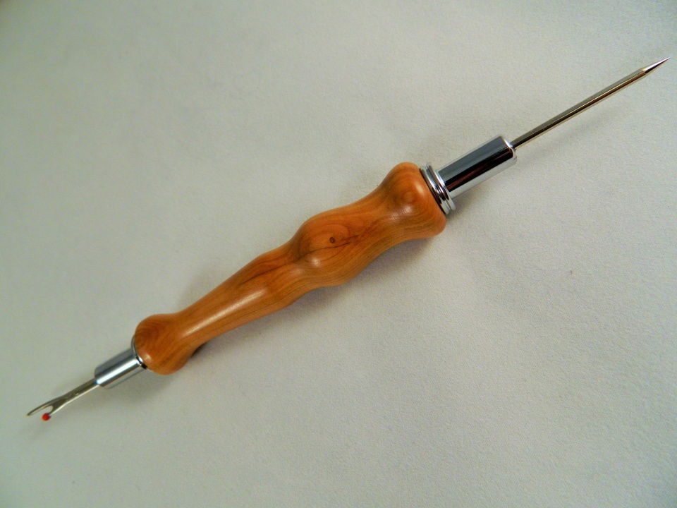

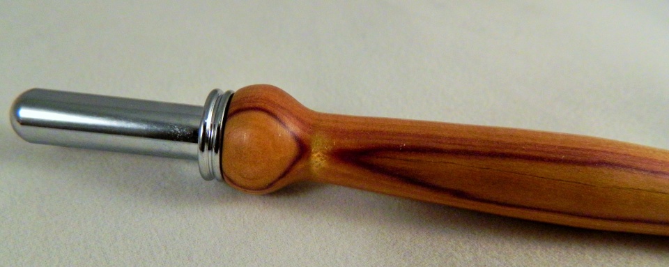

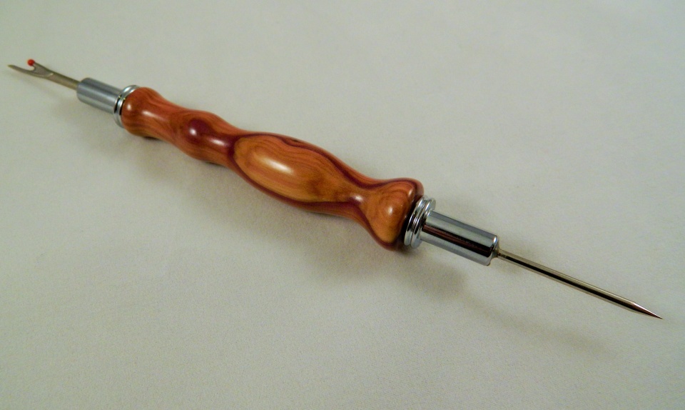

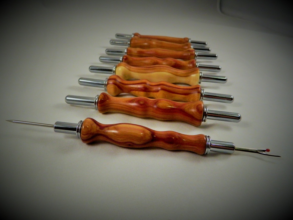

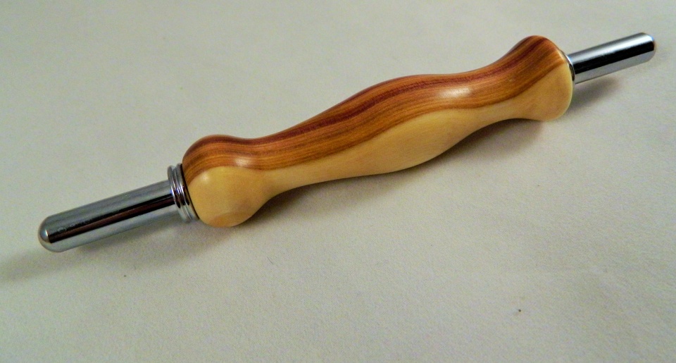

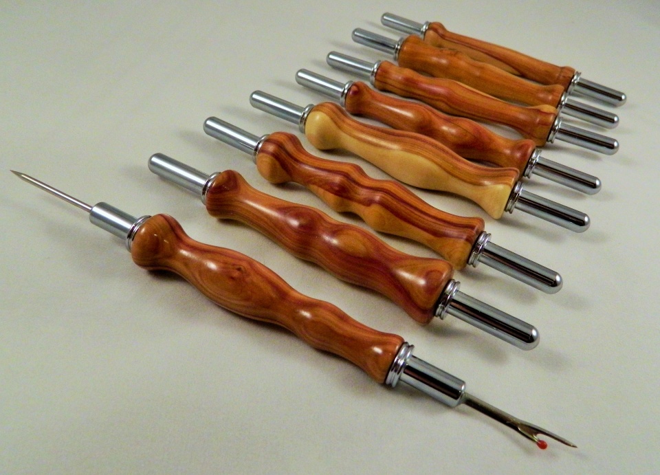

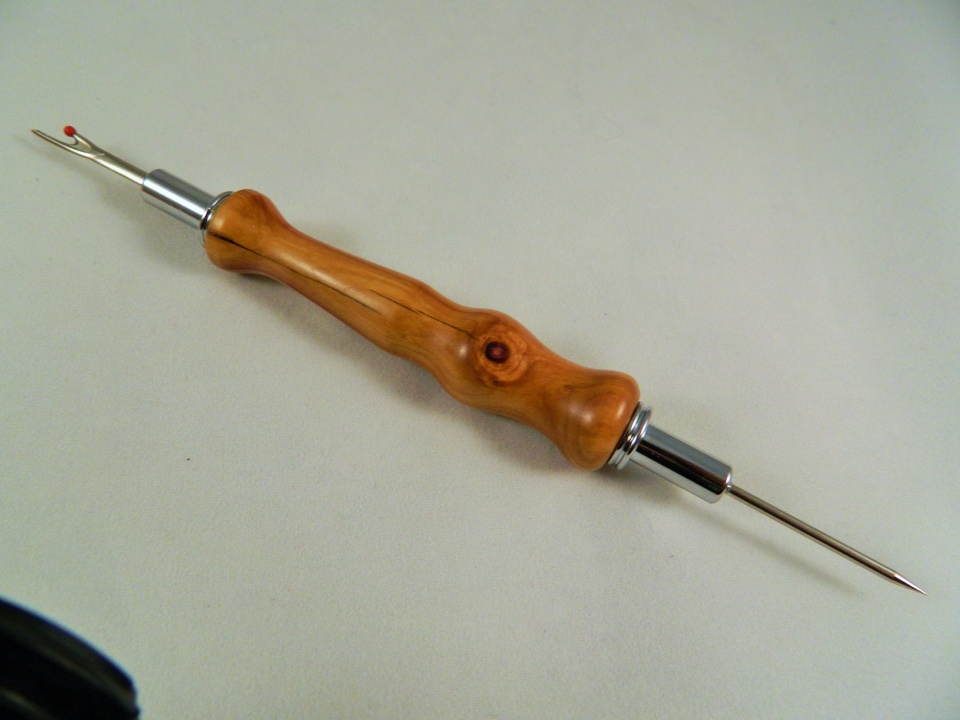

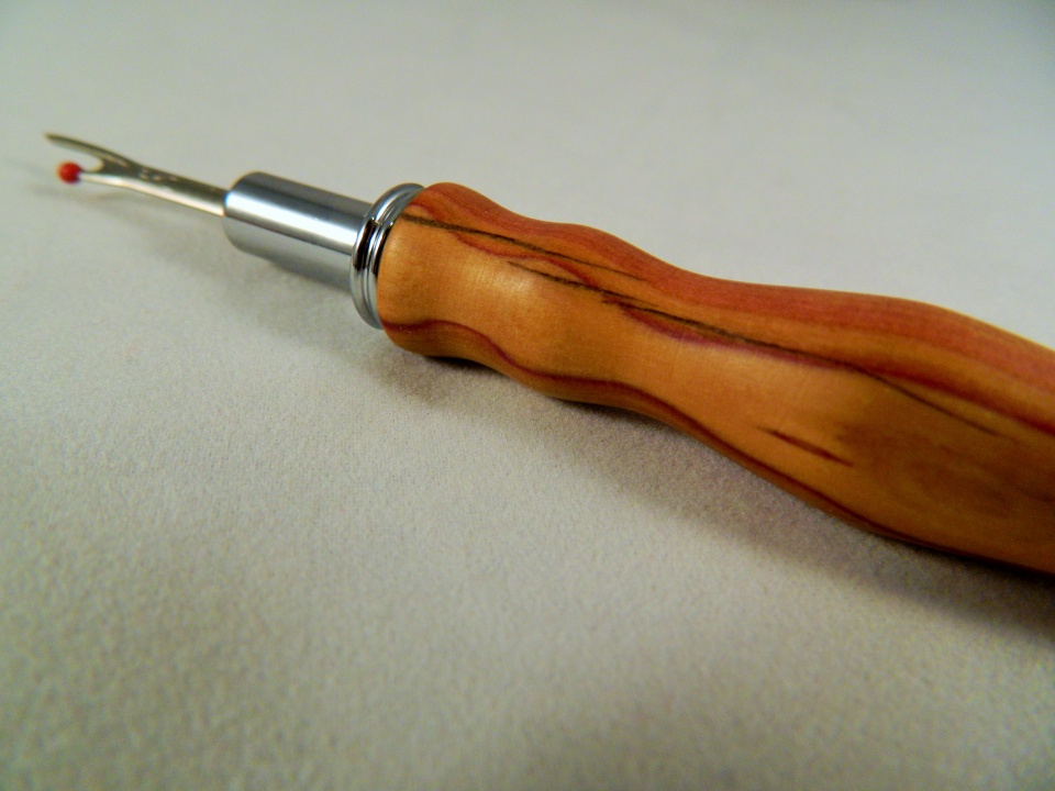

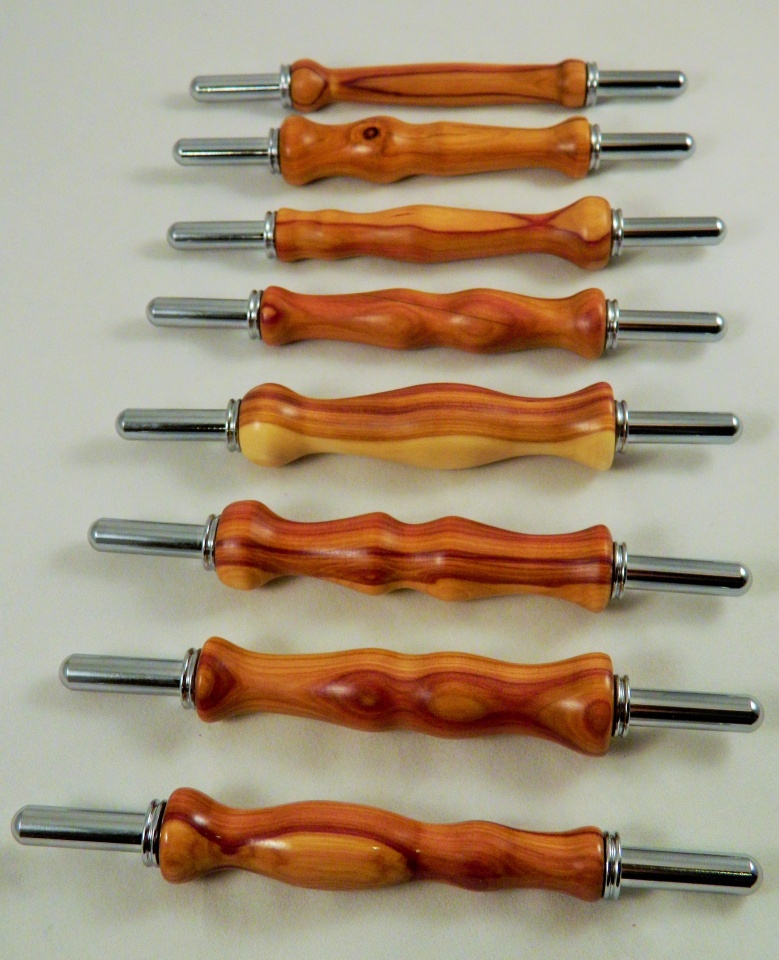

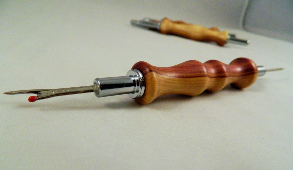

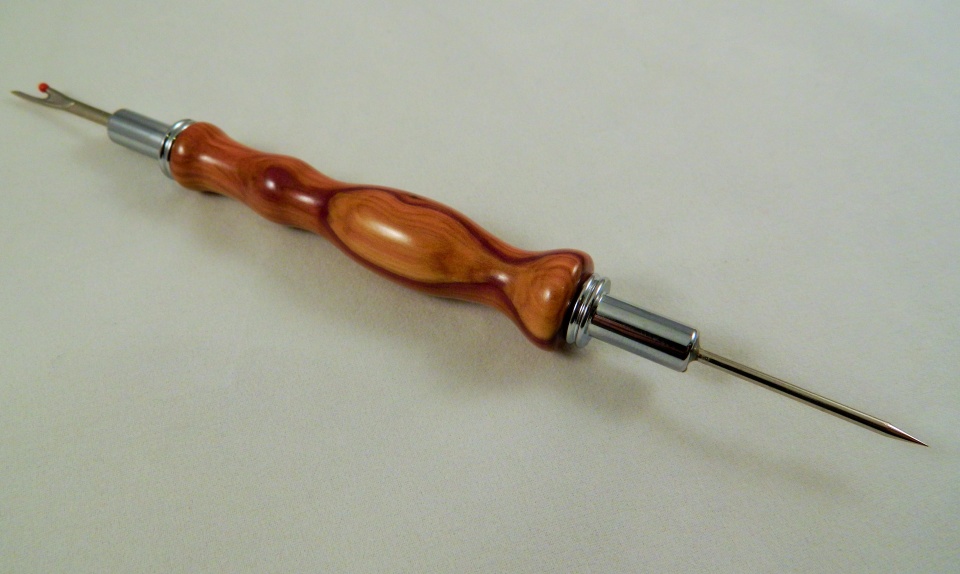

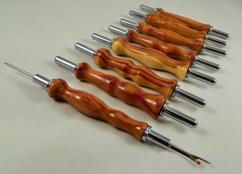

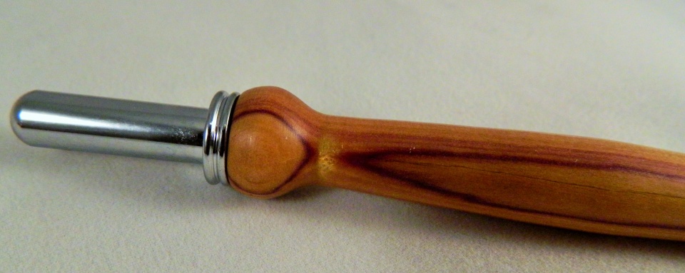

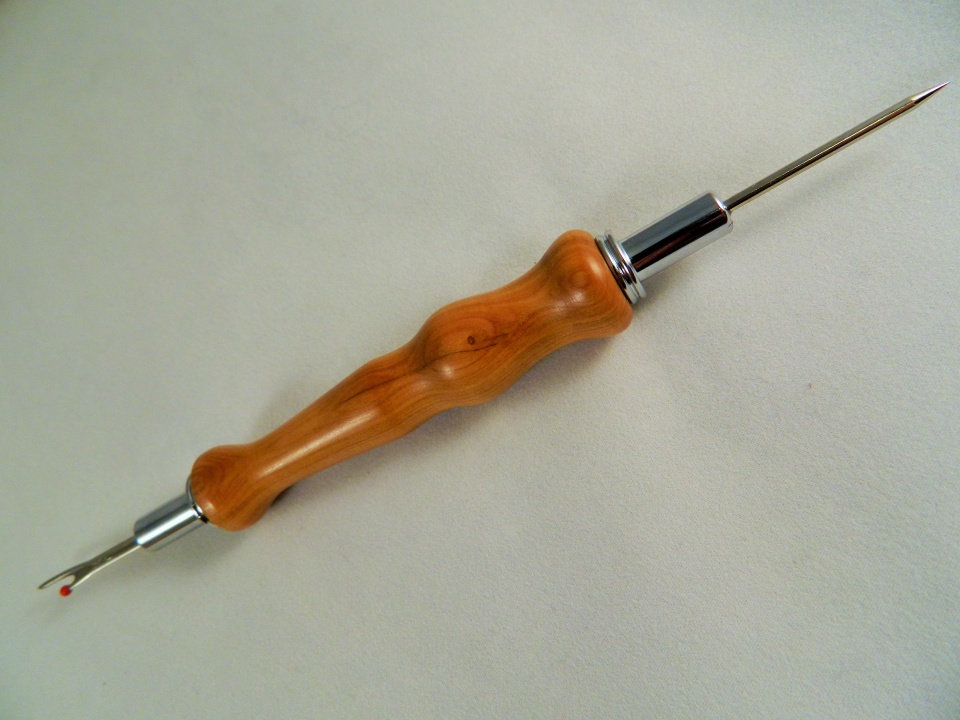

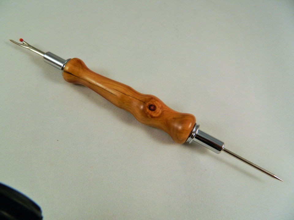

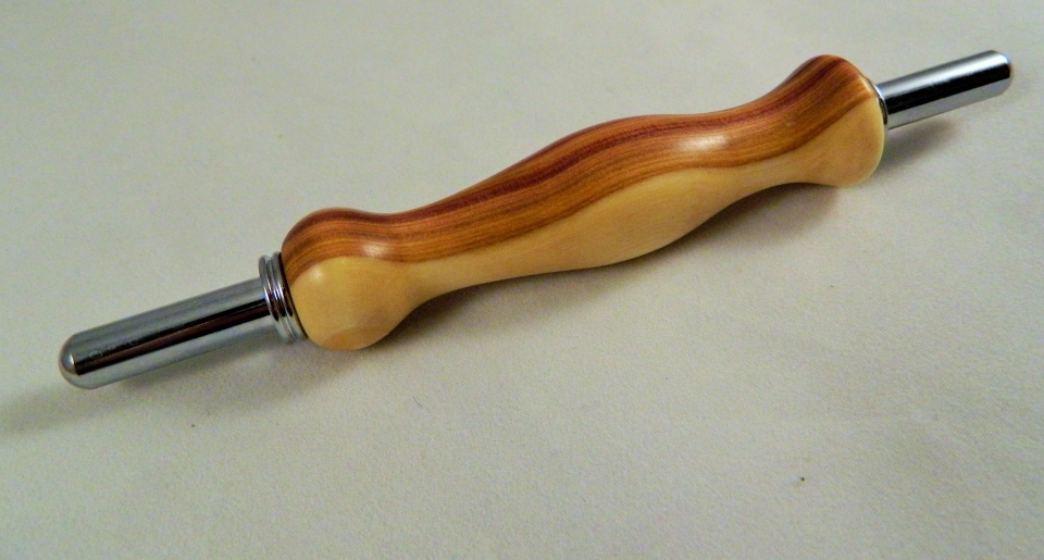

Lilac Seam Rippers! The bottom 2 in the pictures have CA finish the rest Dr's Woodshop Pen's Plus. The smell from cutting, drilling and turning was just amazing! This wood turned so smoothly it made the fun job at the lathe 2x the pleasure!
A few of them had small cracks that Lilac is known to have but were filled with CA and fine Lilac shavings.
Someone gave me this LiLac as a gift and I only have probably 8 more of these blanks. Where have people purchased Lilac blanks / wood from?

Very nice job on those seam rippers, Ethan.
Also, you got some really nice lilac blanks there.
Lilac is generally a small shrub that grows in the northern half of the USA. Your best bet will probably be to try to find someone who has been able to harvest some & try to work a deal with them. You might post a wanted request in the Deals, Trades, Gifts & Wants forum in case someone here might have some.
I have seen lilac pen blanks on ebay from time to time, but I don't see any there right now.
You might also try the WoodBarter.com forum if you can't find any here.
Best of luck
Edgar
See if you can get hooked up with two or three landscape companies who regularly pull out old shrubbery. You will need to make them a pen or two!
You may get some other good species as well. Just be sure to try the blanks and let them acclimate to help reduce the splitting. I would cut your blanks a little large and put them in a paper bag on the shelf. Date them and then start pulling from the earliest batch.
