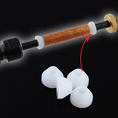

For finishing, then you need this stuff to prevent sticking.
Tri-Flow has Teflon in it. Make sure to spray the bushings before you use them. A couple of light coats are better than one thick one.
Allow the bushings to dry well between spraying them with the Tri-Flow.
Try not to use accelerator on them as it degrades the Teflon coating.
Re-spray the bushings before & after every use, and the CA glue will not stick to them.
I hope this tip helps someone out there. :smile:

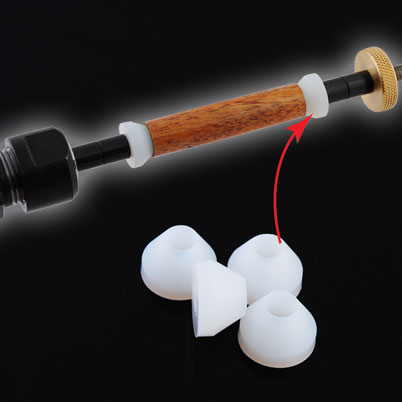

Many times I will use my live and dead centers when finishing. The key is not to tighten so much. If it spins when working on snug it a bit more. I also made my own delrin bushing and made the cone longer and sharper so there is more room on the ends. A couple dips in some acetone and all residue is gone. Those bushings look to bulky. I would never buy them. When I do my CA finishing I like to make a pass with the towel in a clean sweep motion. I would run into those and abruptly stop my motion causing the CA to pool at the ends. Not for me.
