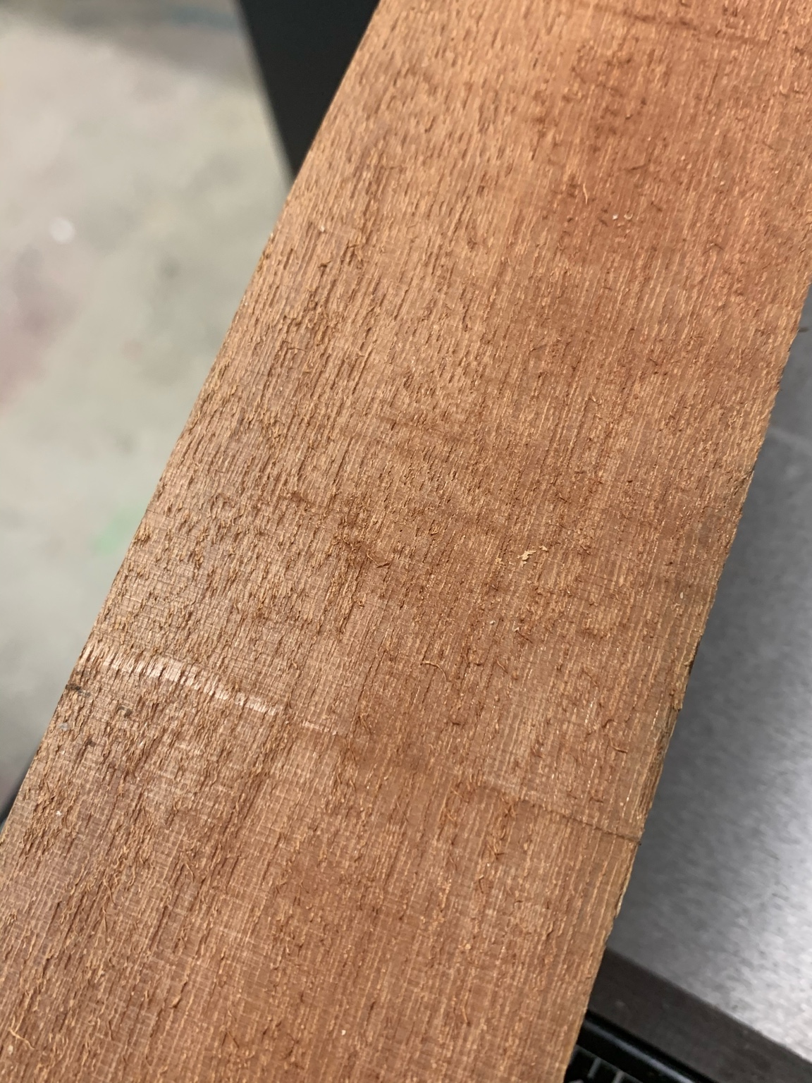

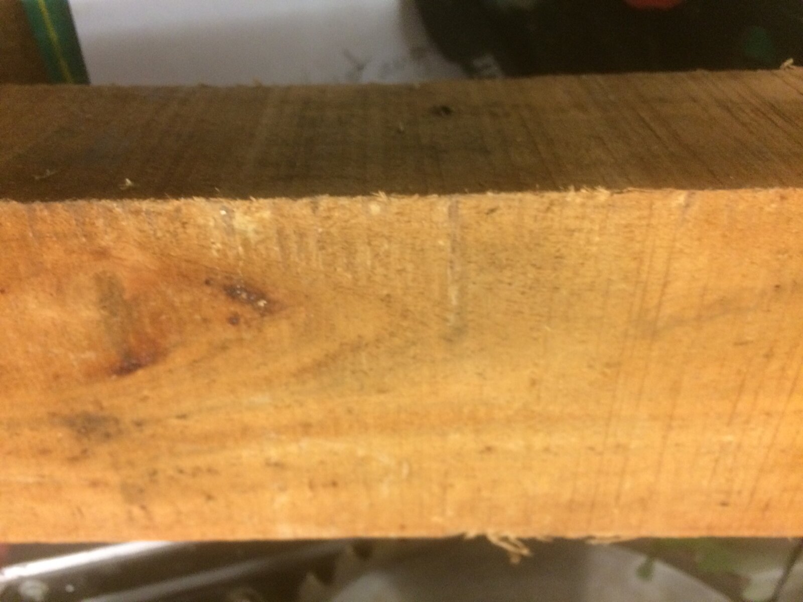

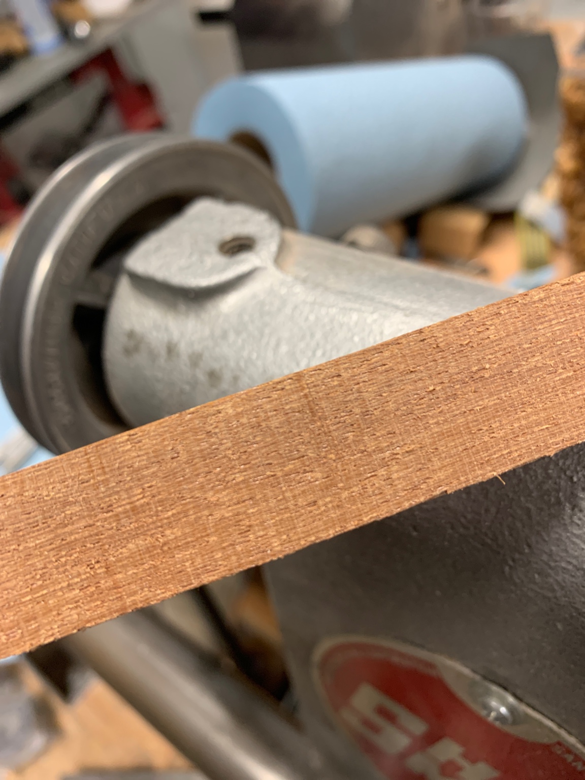

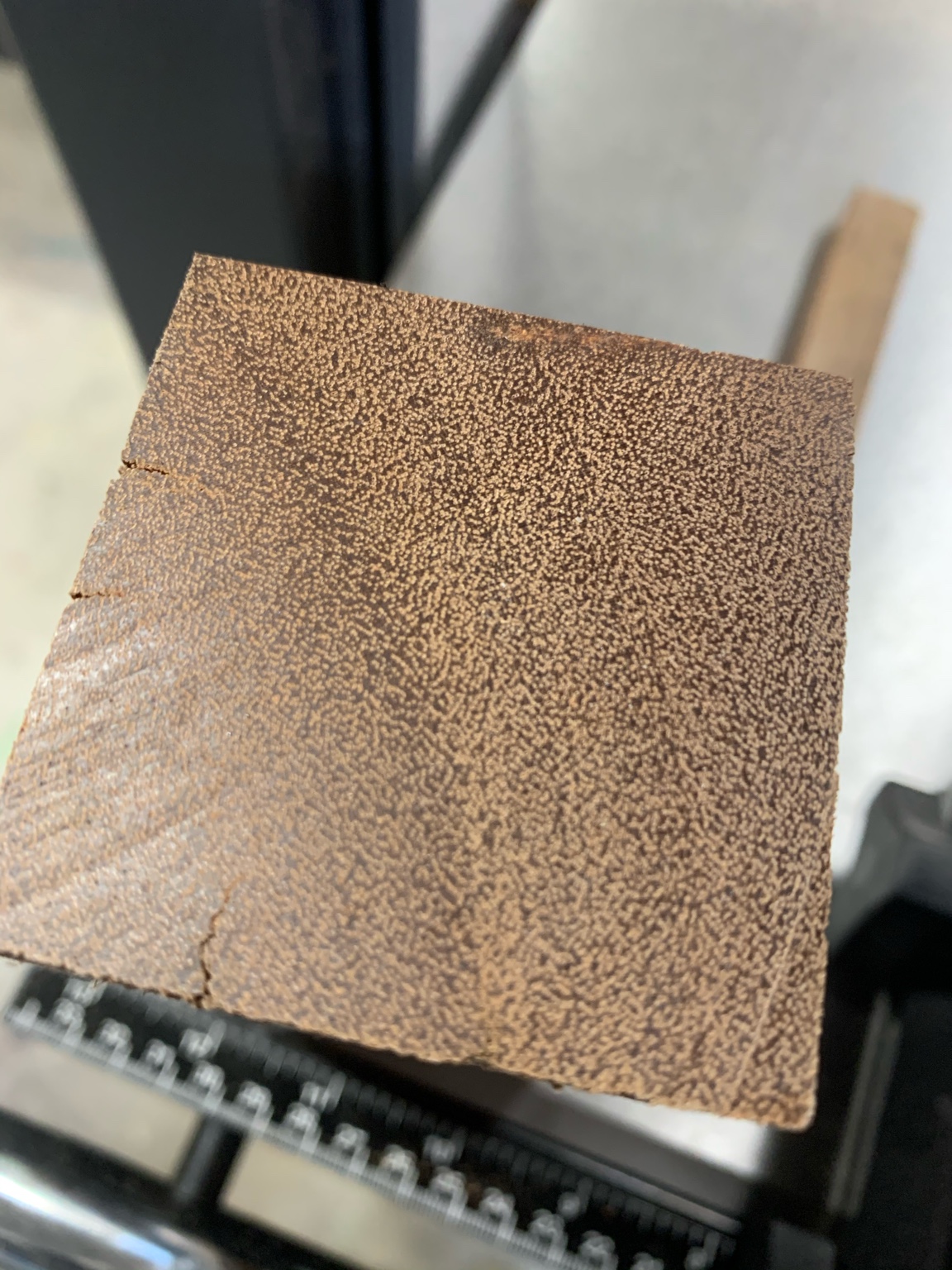

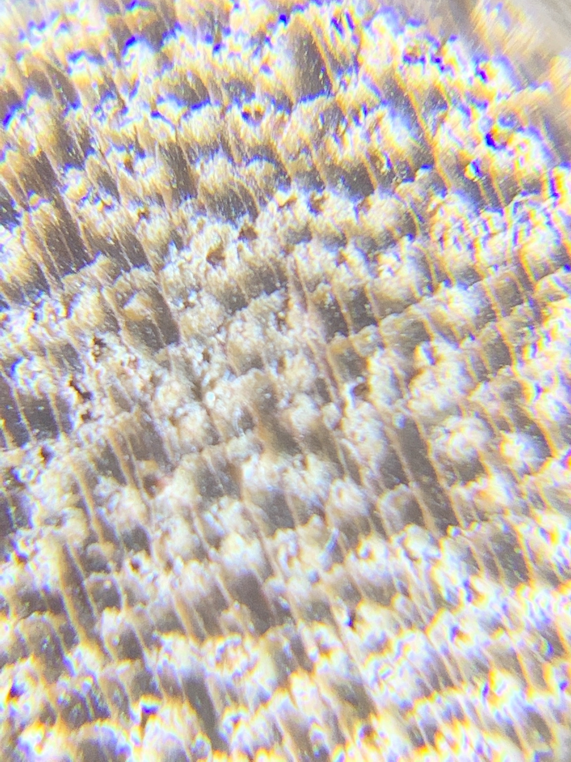

A friend gave me a big block of this wood... he didn't know what it was. I have no clue!
Testing out my new bandsaw... the wood smells sweet and peppery. It seems pretty dense too.
Any ideas?

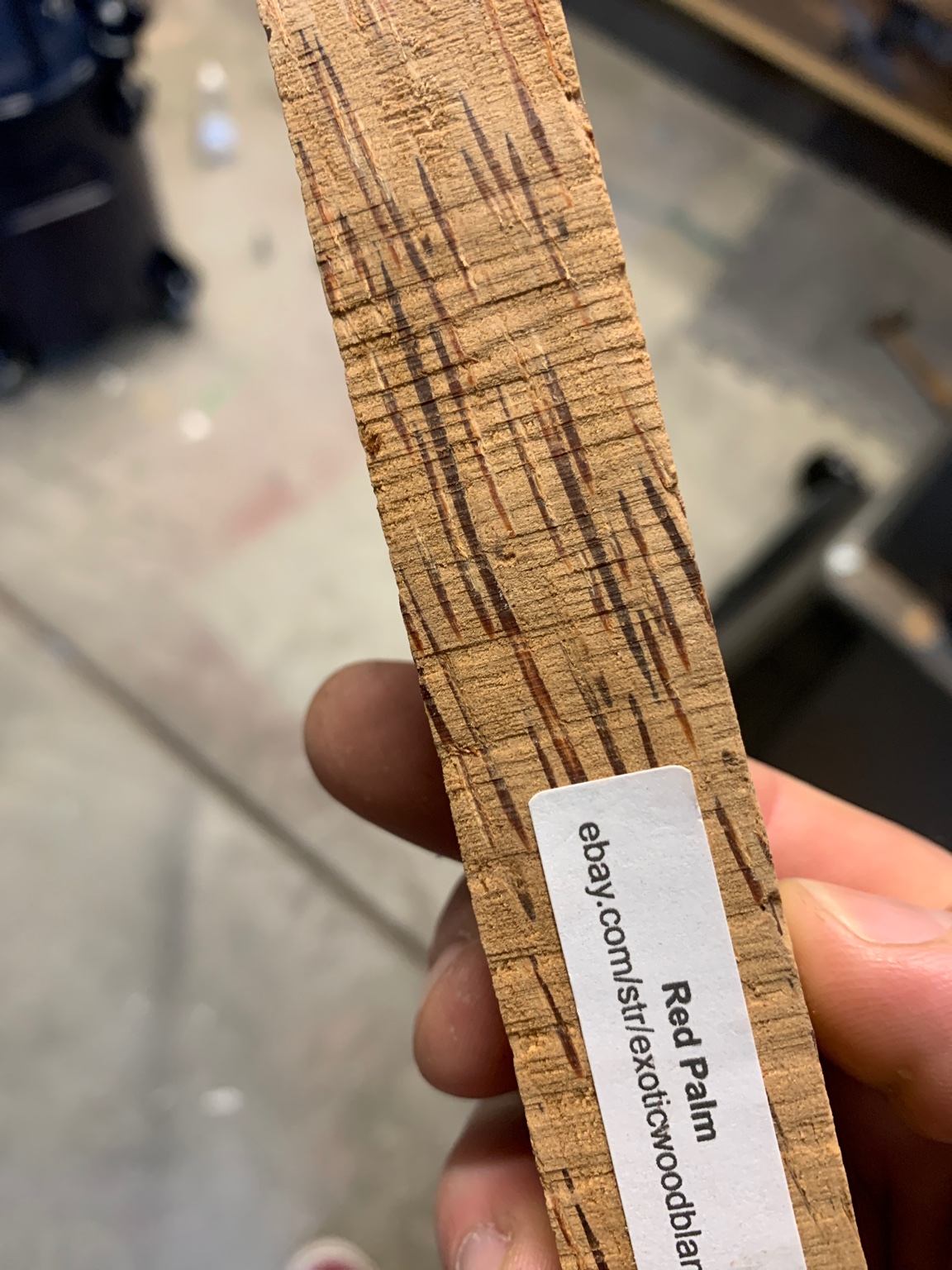

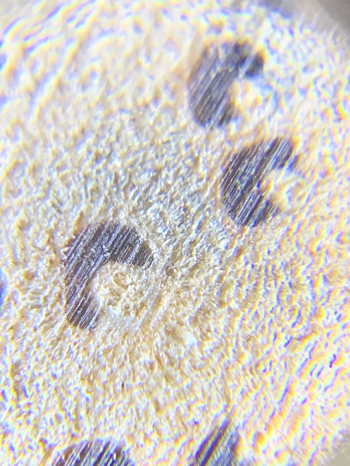

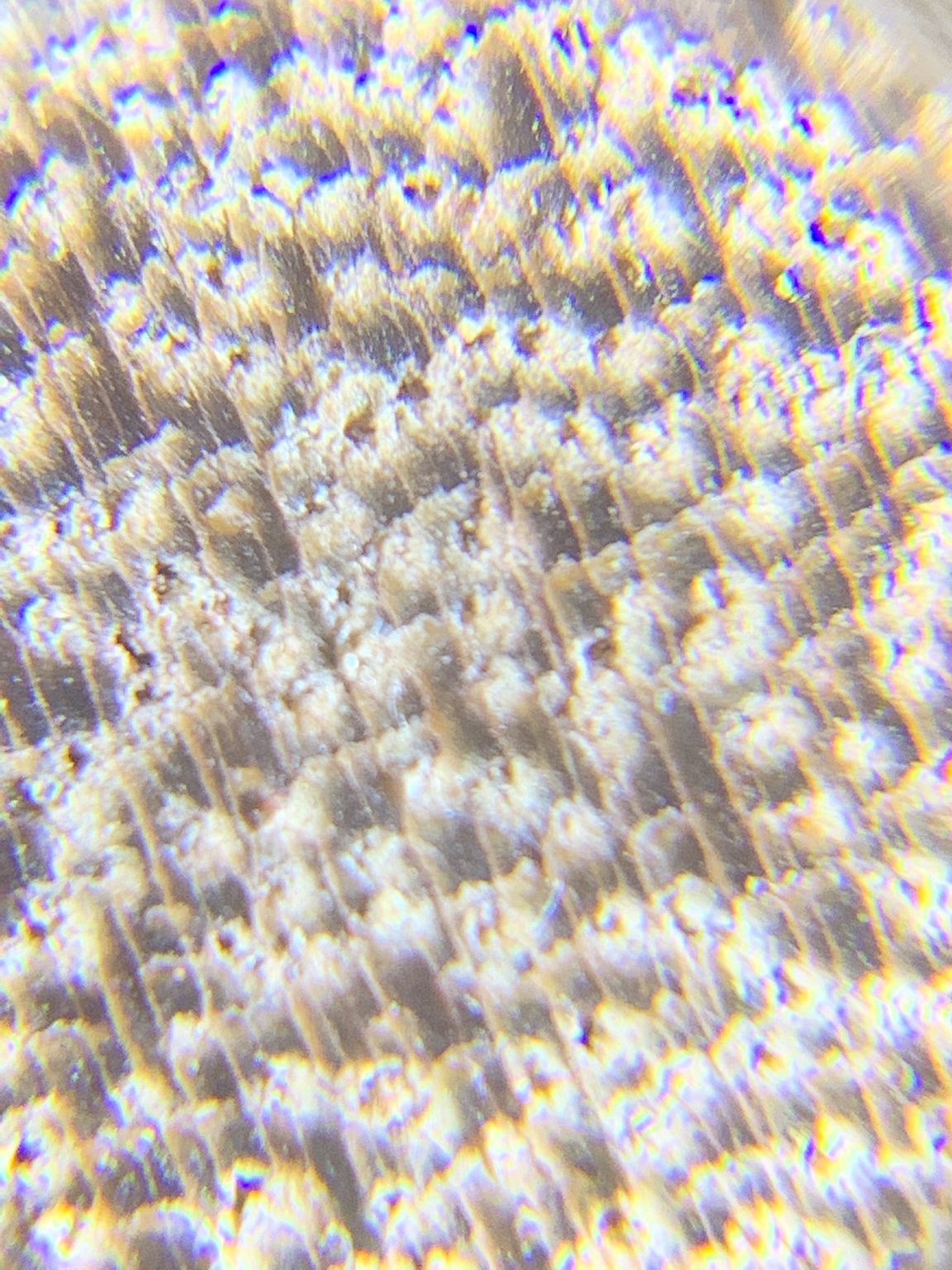

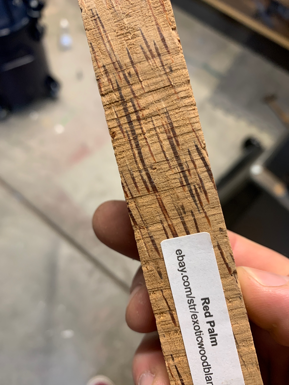

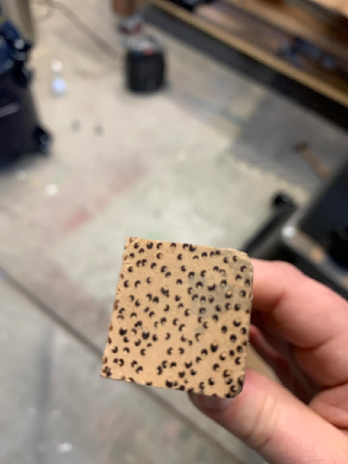

Fred nailed it for the end grain - certainly a Palm (look with a magnification glass, are there eyeballs, aliens looking back???). However, I would suggest you consider Red Palm. I have used both extensively, and suspect it is Red Palm vs Black Palm. In the thread below, skip to the bottom right side picture of the 'Alien' endgrain.
Palm is notorious for being a 'fussy' turn... Dense, but prone to chipping, in my opinion. I have used it for trim rings as well as full blanks. I liberally apply CA when turning, especially when close to the bushings and thin sections. Palm is a monocot; think of a bundle of straws vs annual growth rings. It will accept thin CA via the end grain very easily.

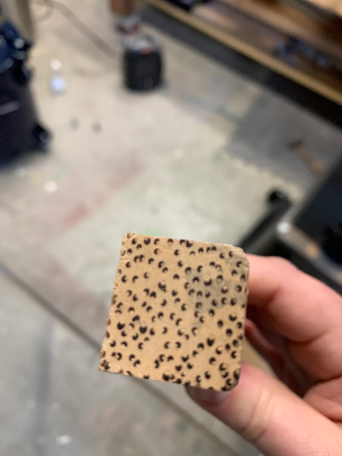

The top set of pictures does not look like palm to me. Palm, red or black have those dark "needed/spears" as in the red palm labeled blank. The top pictures that you have questions about do not have those needle/spear like striations. The top picture's end grain does not look like end grain on any of the palm that I have had. End grain on palm will have dark red or black circle like grains while the top picture has capillary holes in a dark grain background.
The endgrain looks Merbau to me, this wood has many colour variations and is certainly very heavy/dense.
Cheers
George
I think that this is more likely the wood type. Specifically, because the afzelia has "no significant smell or odor" on the database.
When cutting this block, it definitely has a sweet, peppery/spice scent to it.

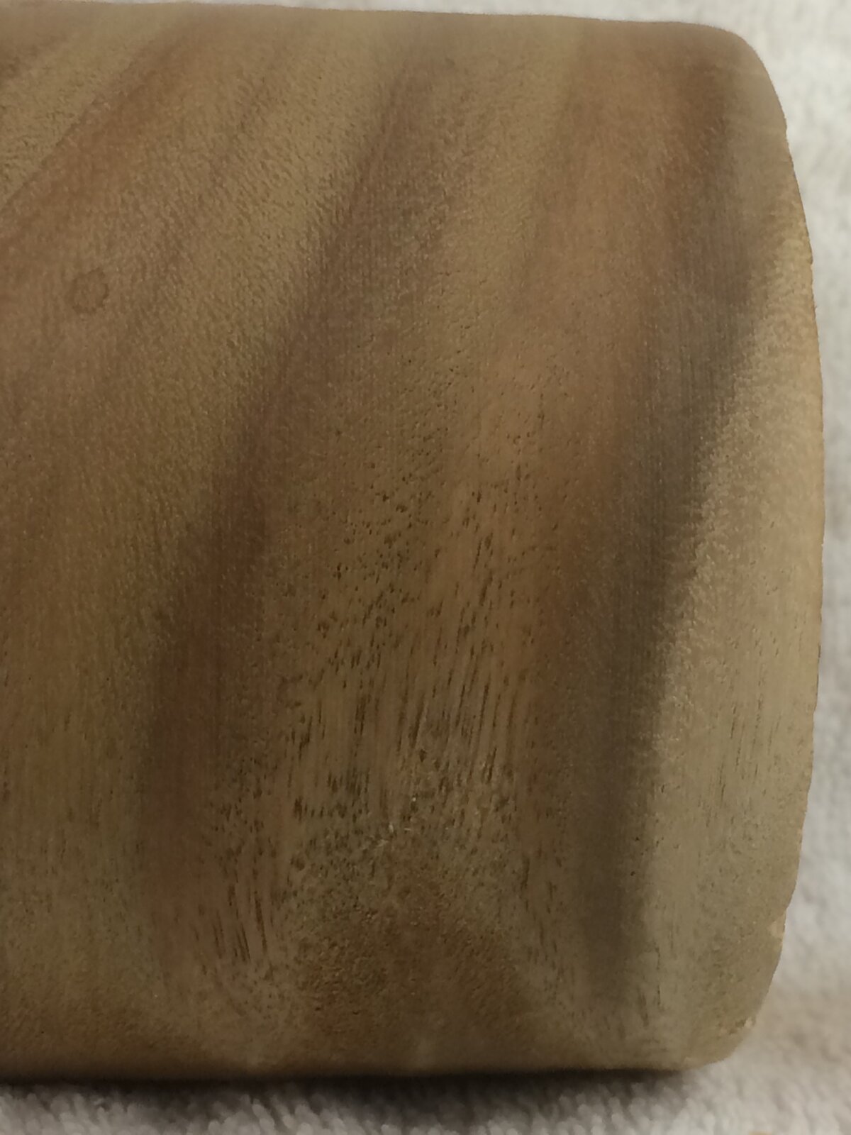

Well if sticking to that then how about this The problem is the color. Woods like cocabola and rosewoods smell like that but are darker in color.
https://www.wood-database.com/spanish-cedar/

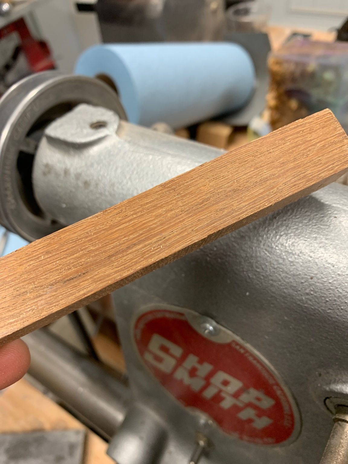

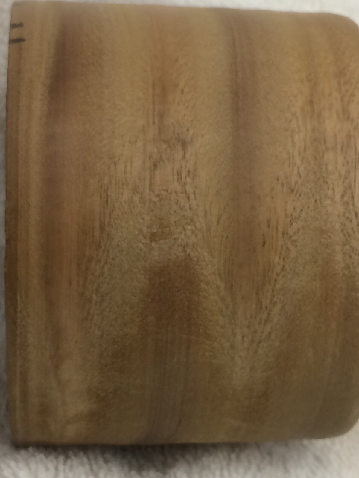

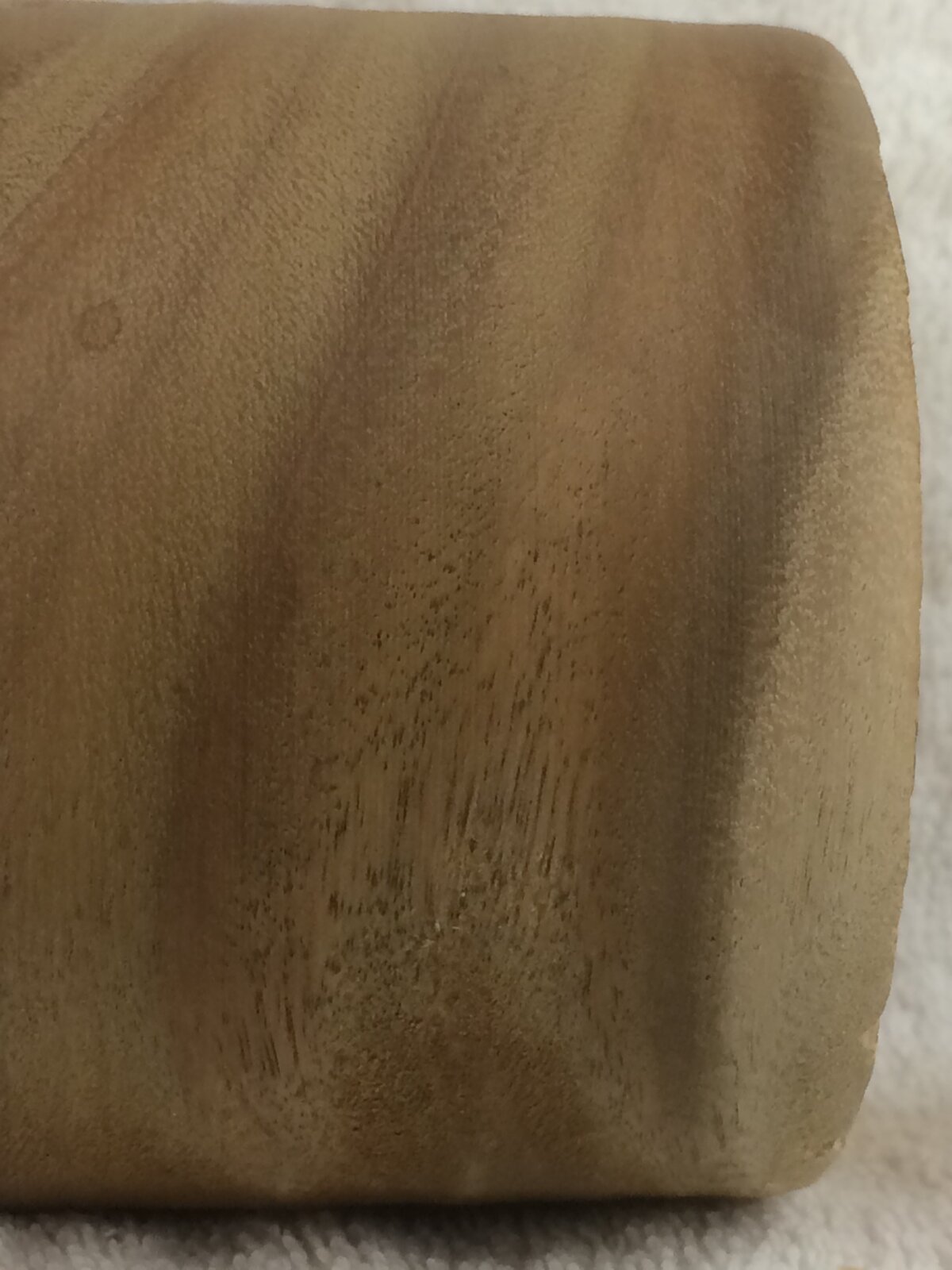

I'm thinking the color is off from the cedar. The smell isn't of cedar either. I think we are heading on the right track with Afzelia and Merbau. I'm thinking closer to Afzelia (Doussie)?
Matches closer to color to me.
