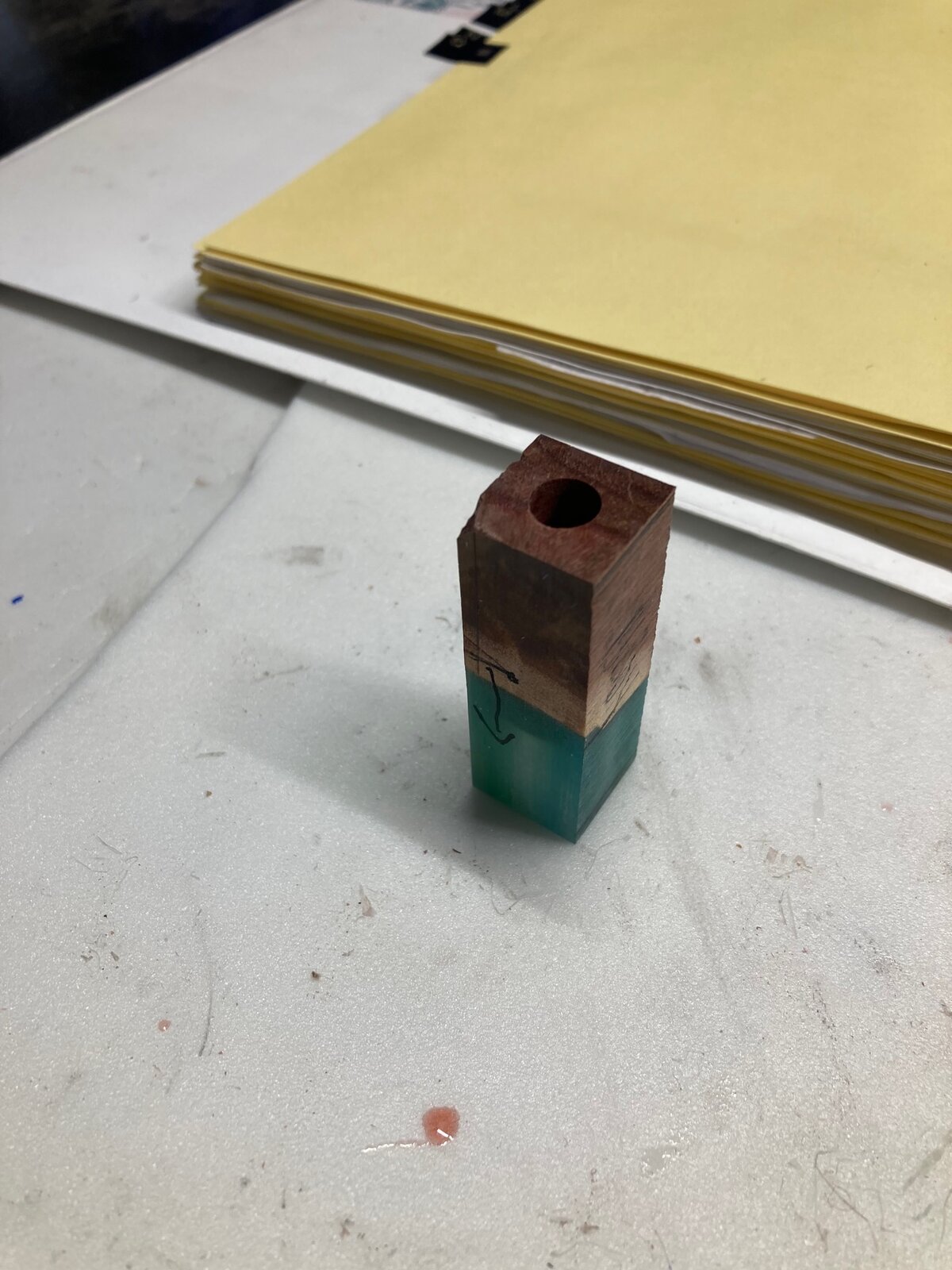

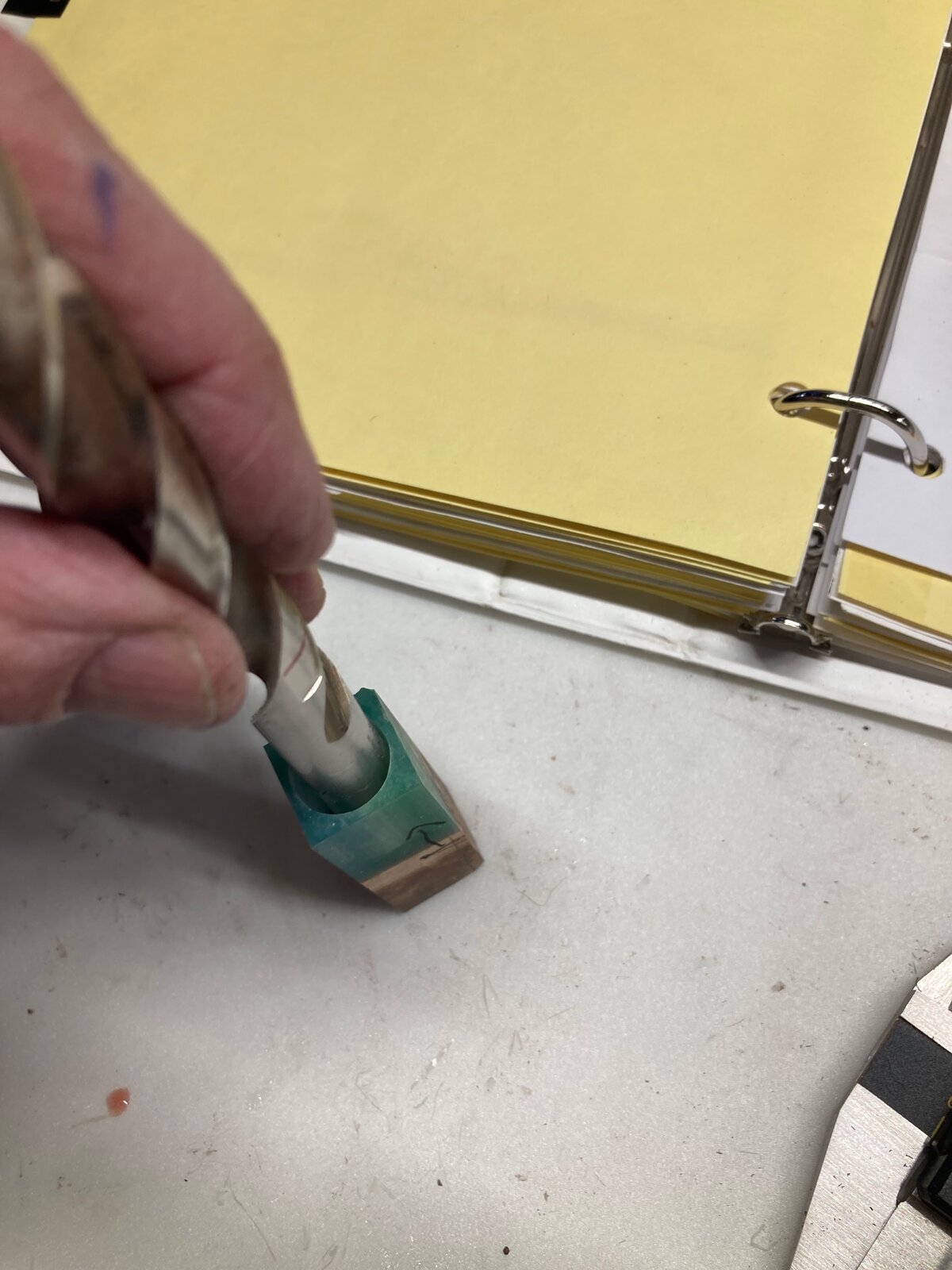

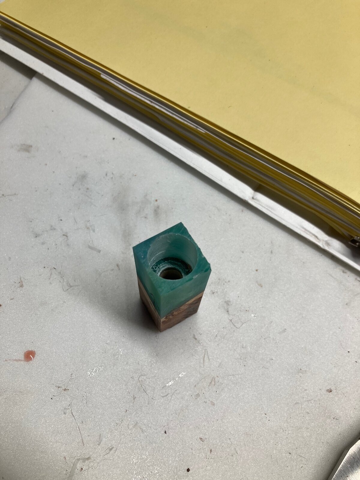

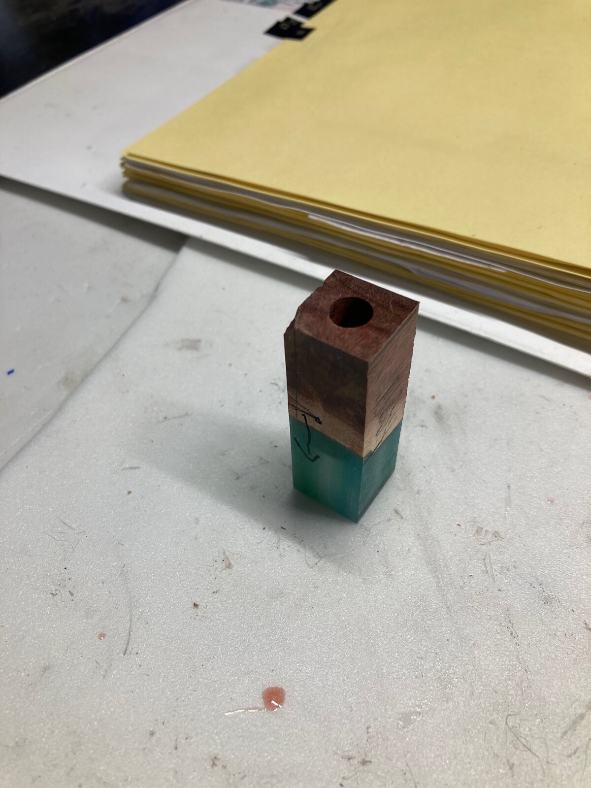

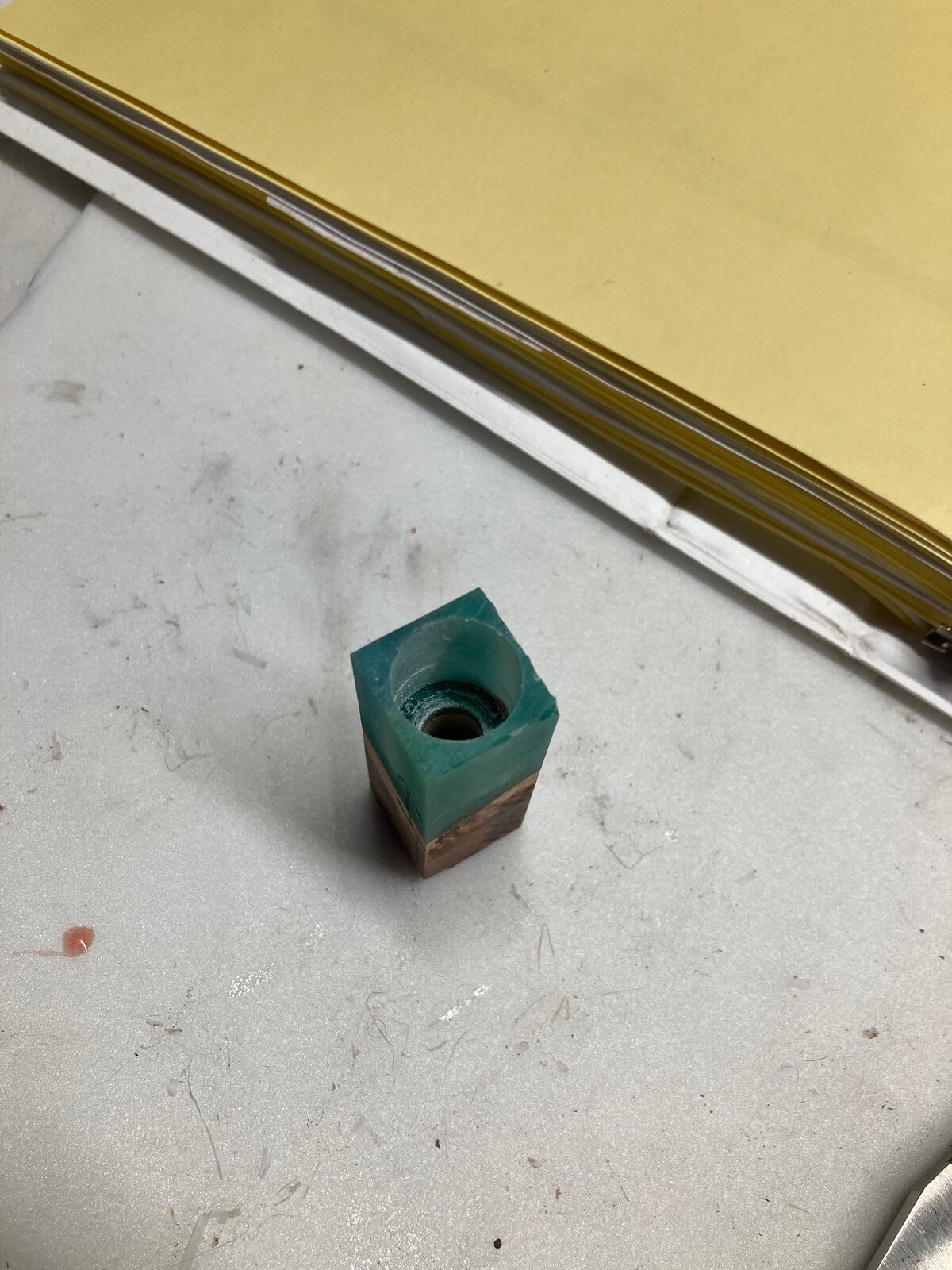

Today I needed to drill a large bore hold for an Olympian Elite 2 - the body blank uses a 31/64" bit. I decided to drill an 8mm pilot hole, just to guide the larger bit. I had no trouble drilling the smaller hole. You can see it came out centered and clean.

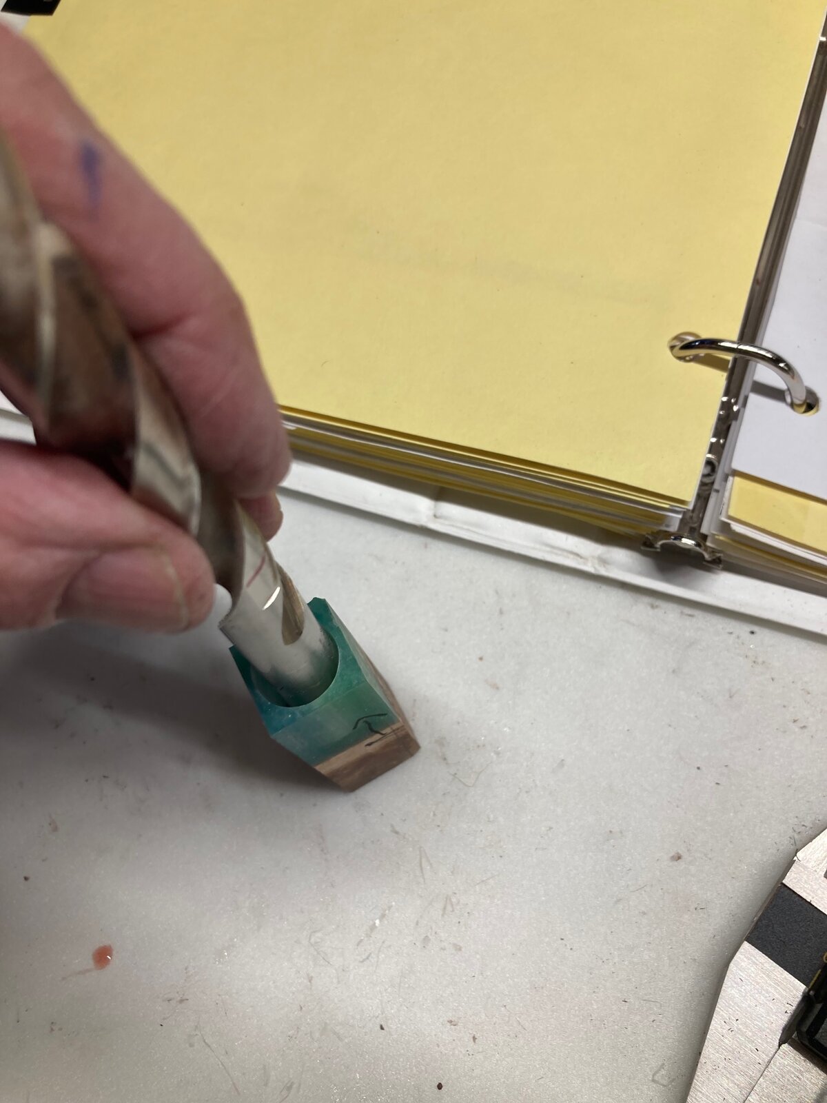

Then I chucked up the 31/64" bit (a PSI bit I have used for many pens, still sharp), and started drilling. About halfway, I had to stop. It was obvious that the hole was too large.

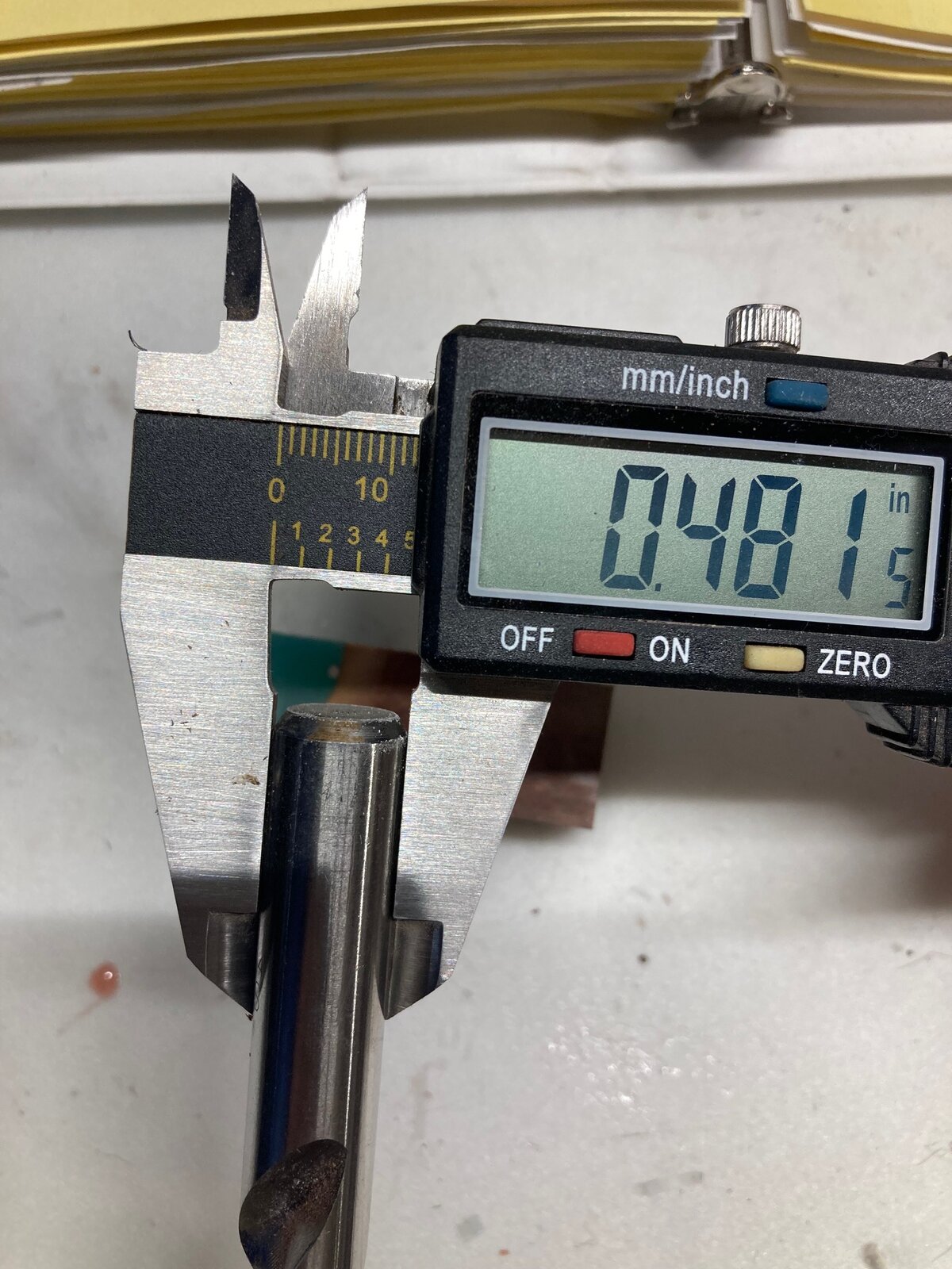

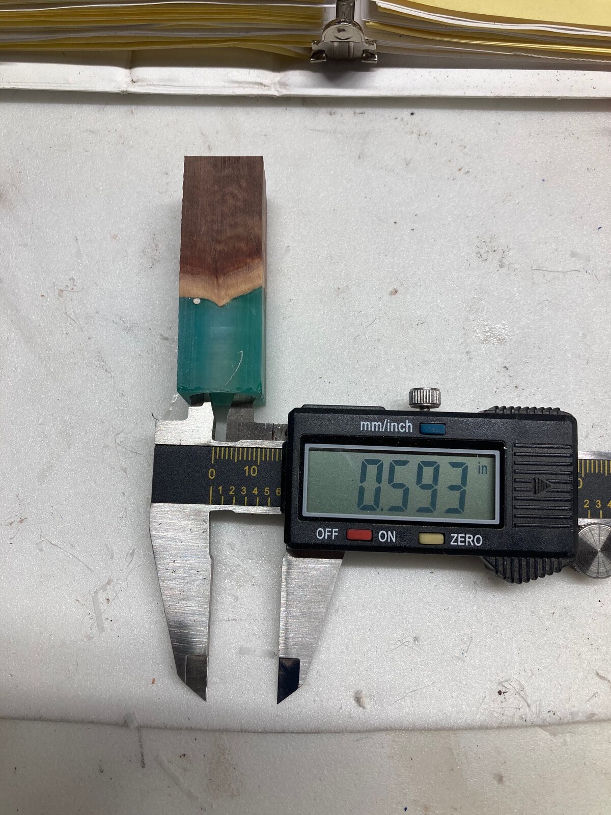

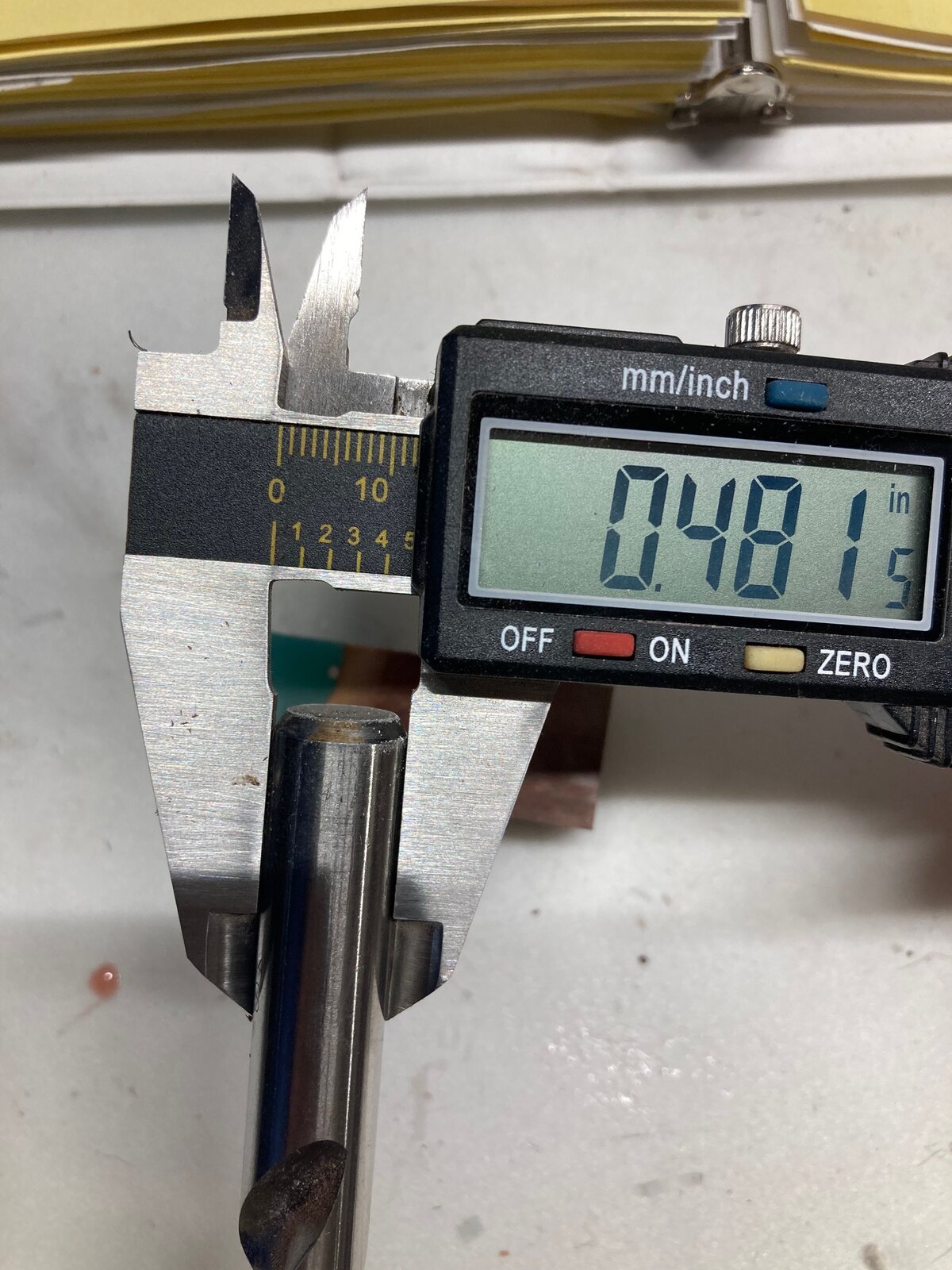

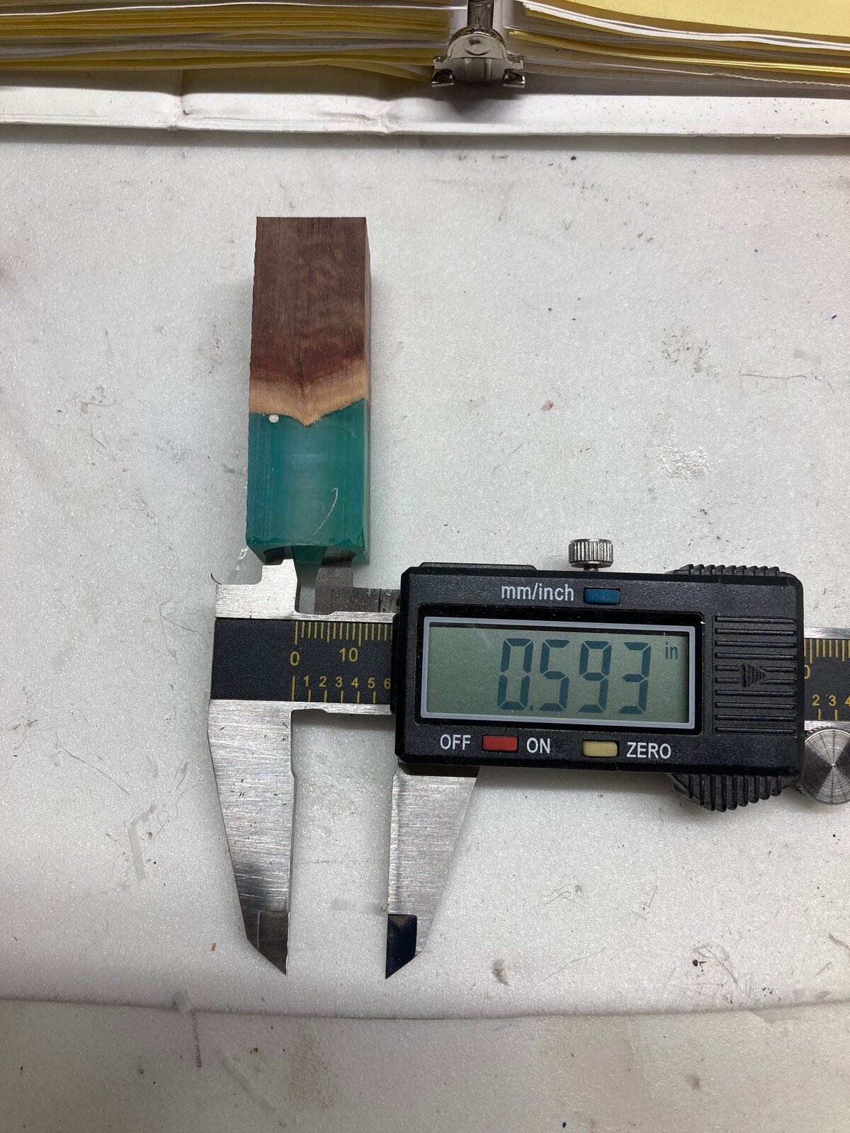

I measured the hole, and the bit - the hole was about .100" larger than the OD of the bit.

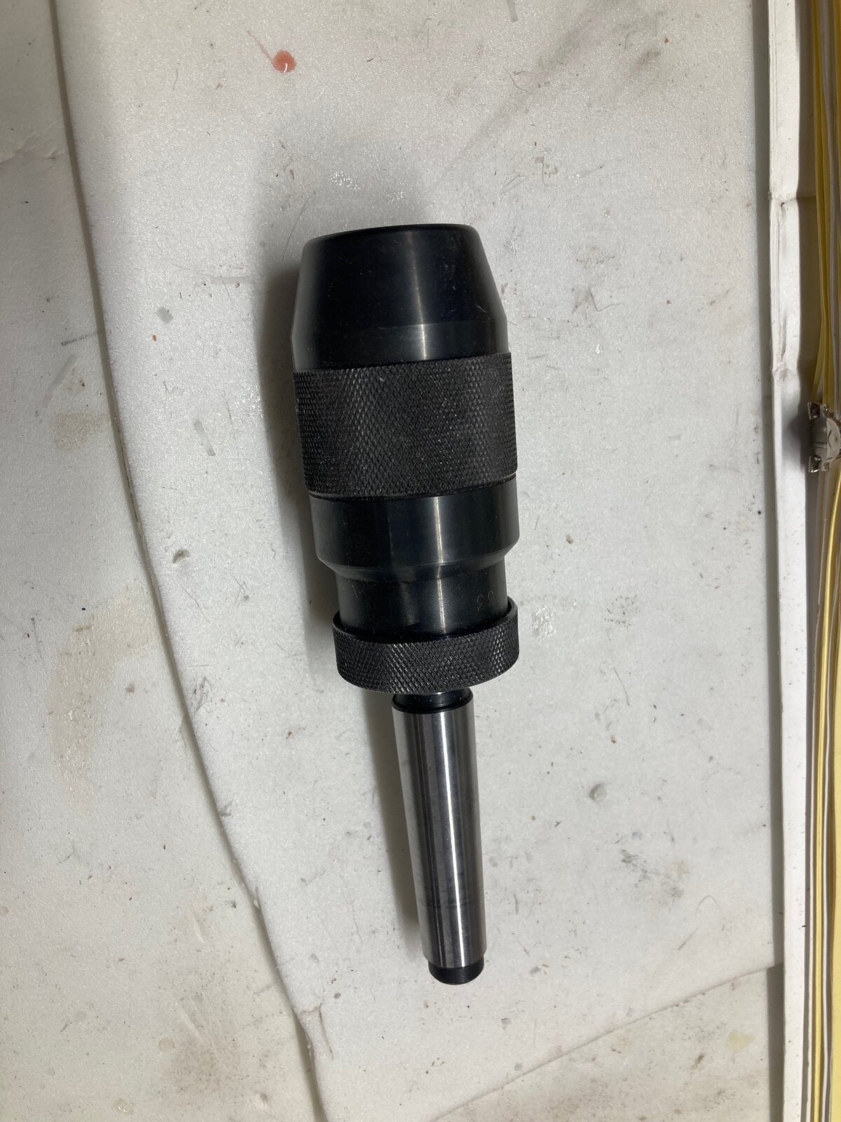

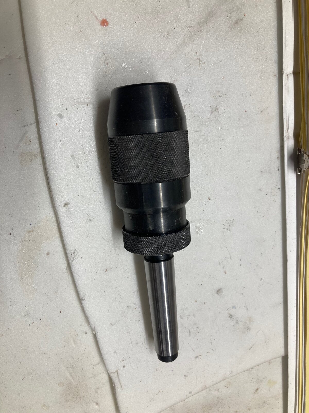

Here is the Keyless Drill Chuck I just got a couple weeks ago from PSI

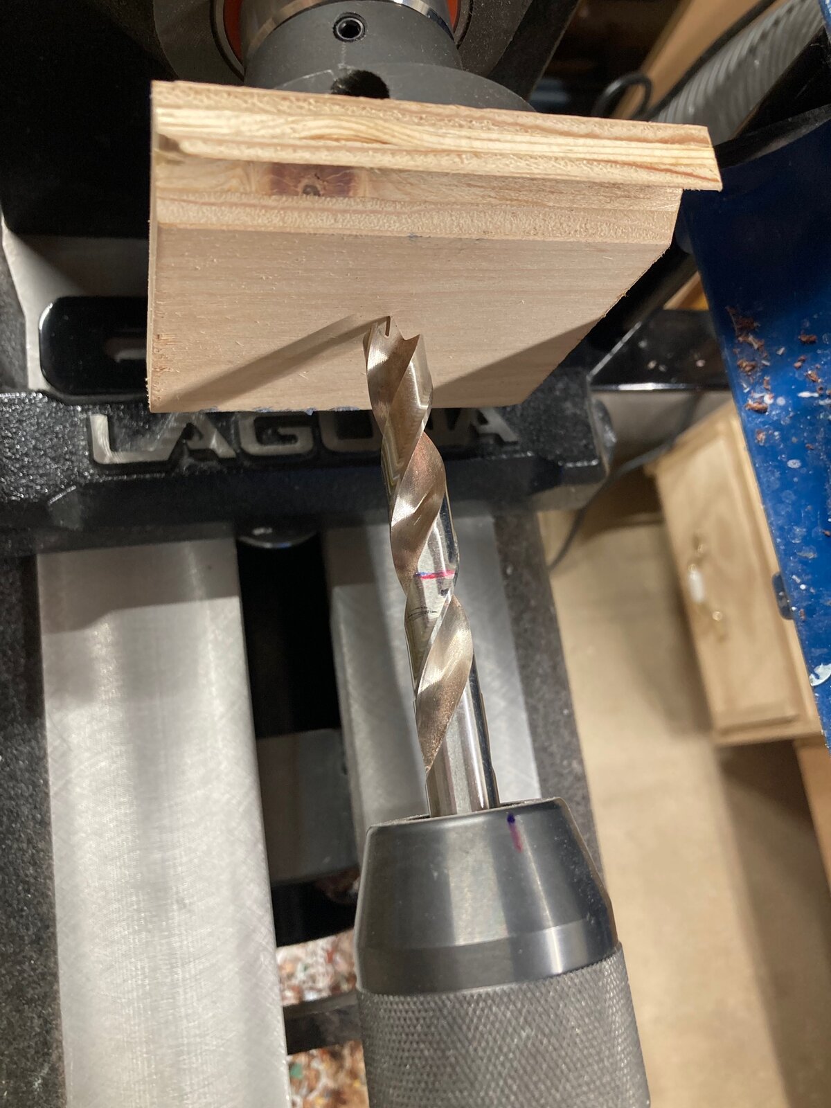

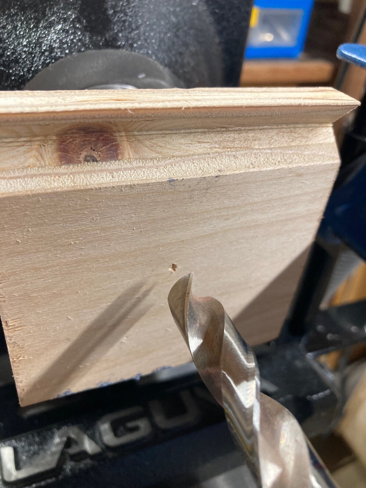

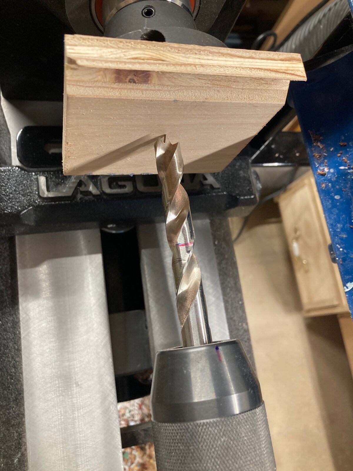

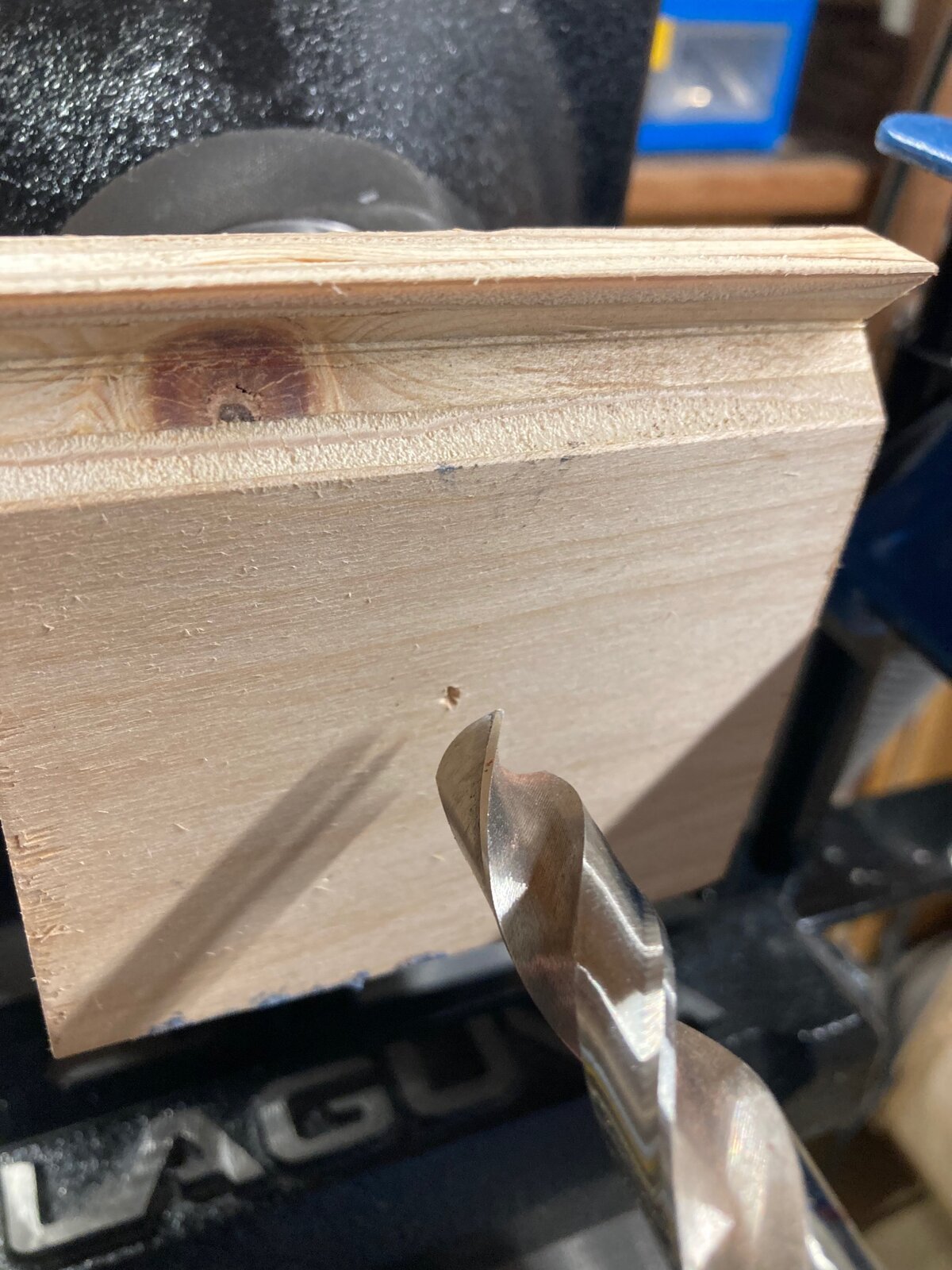

Well, I ran the test Vic Suggested.
This first picture shows the setup Vic Suggested. Note the reference mark on the top of the chuck, so I could approximate 90 degree rotation of the chuck.
The second photo shows the mark on the plywood from the bit, after 4 "pokes" from the drill bit, with a 90 degree rotation of the chuck between each poke.
As you can see, the mark is pretty small - the brad tip on the bit basically hit "home" all 4 times.
That said, this was only one test. But I can use this method to check my chuck each time I insert it into the tail stock, to see if it ever goes in crooked... Maybe it's user error, and I didn't always seat the chuck properly when installing it. I'll check the next couple time I set up and see if I learn anything.
