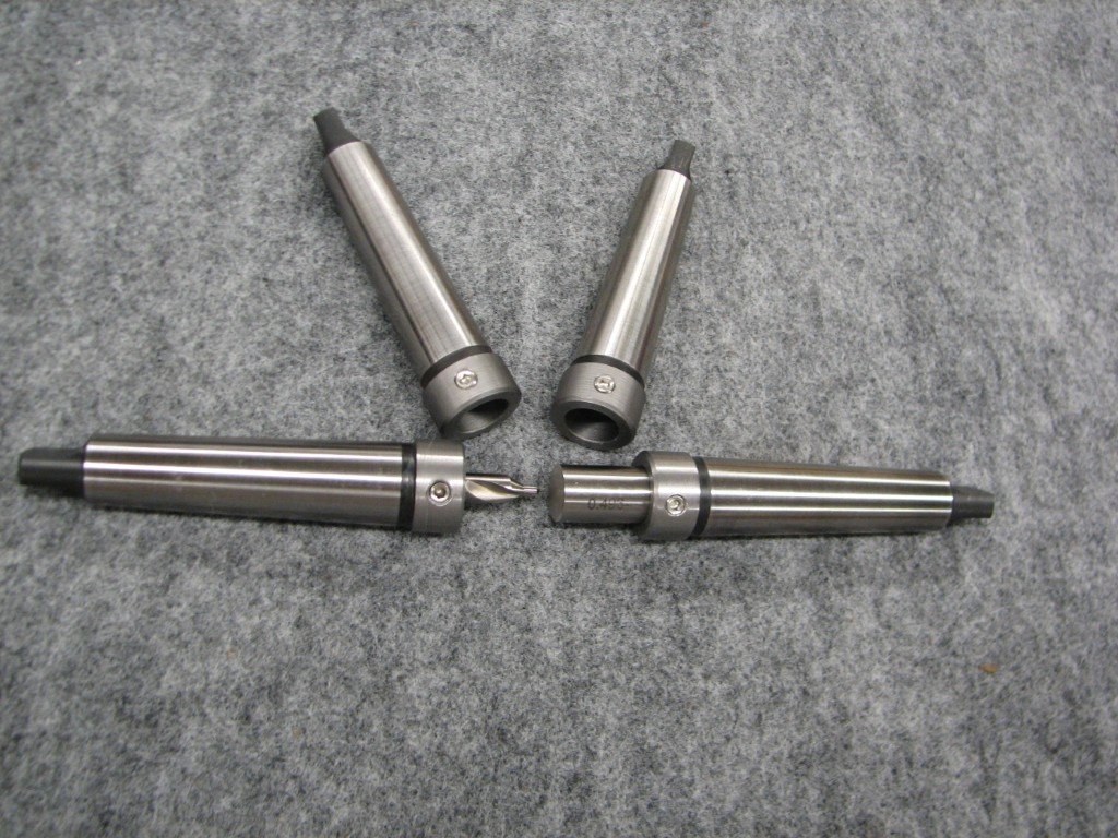

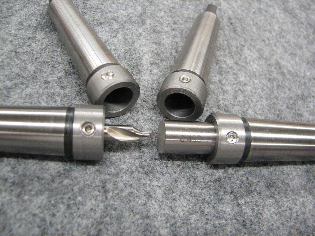

I have several customers who have been ordering what I call a "2MT Tool Holder" so I thought I might add it to my Vendors Catalog.
I need you to tell me if you think it would sell and if you think you would order them.
The arbors by themselves cost me $15 and I'm charging $25 each for the finished product, that's only $10 for my efforts which I think is more than fair.
The one on the left is for a #3 (1/4") center drill and the others are bored out to .496" for the Hinze Tenon Cutter.
I can make them any size but the max. diameter will be .5" and the max. depth will be 1.5".

Am I understanding correctly: you can bore out the part that holds the tool to any requested diameter & depth up to the limits you gave?
I am certain there are things I've been working around (such as holding things in a Jacobs chuck or collet chuck) that would be better done using one of these, and I can see having a center drill permanently mounted in one like your photo shows would be useful.
Correct Duncan, any diameter up to 1/2" and any depth up to 1.5".

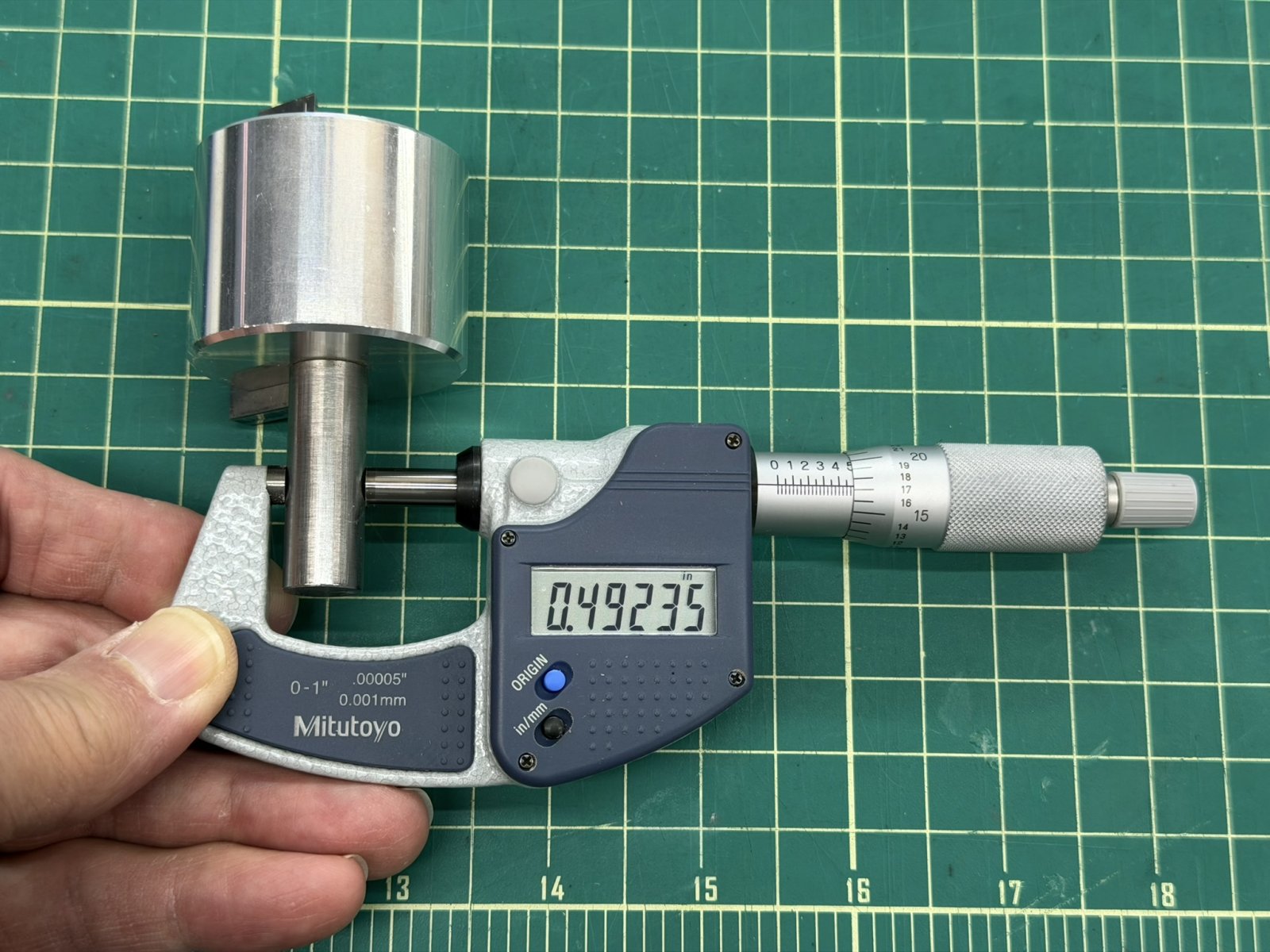

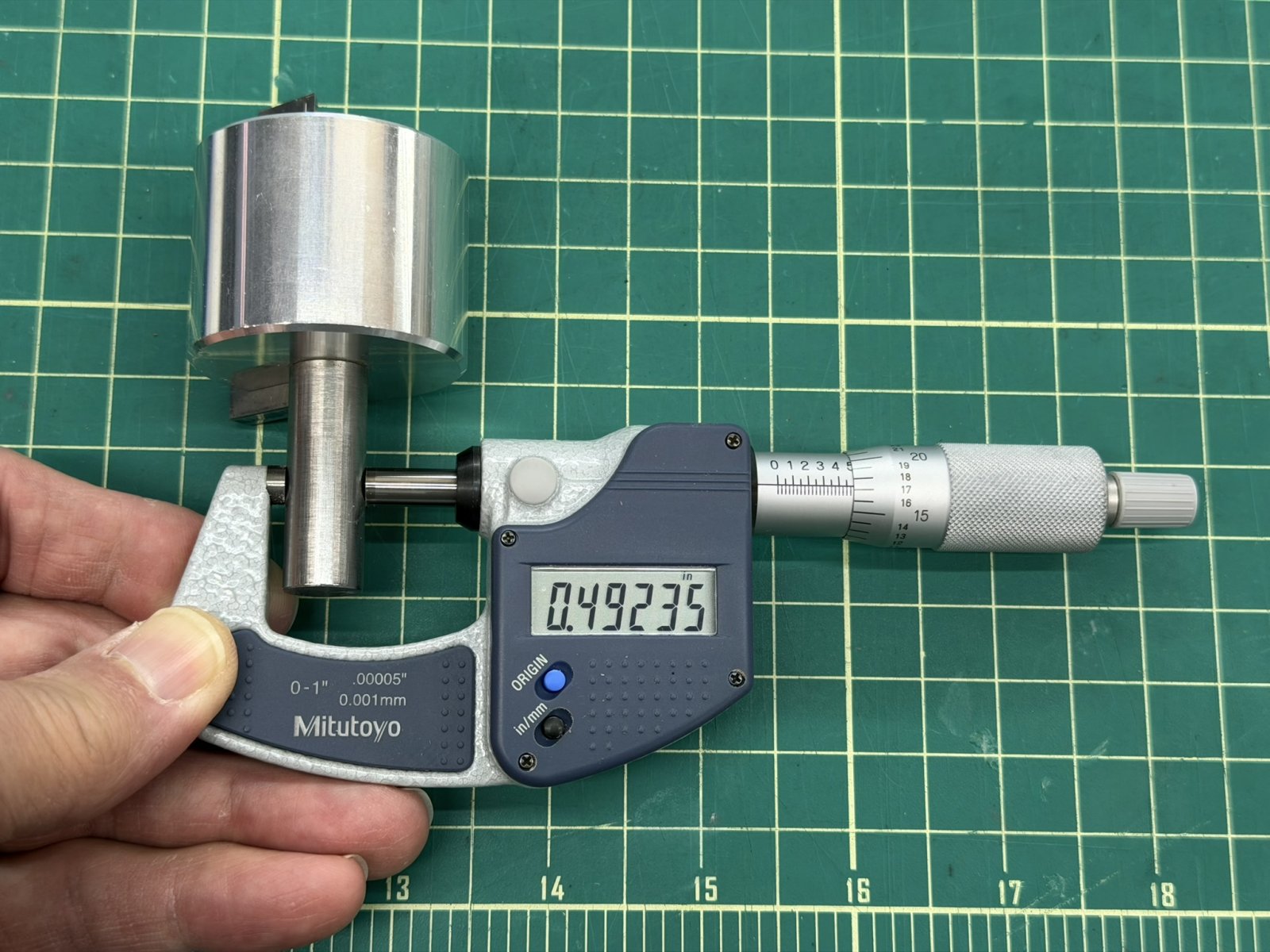

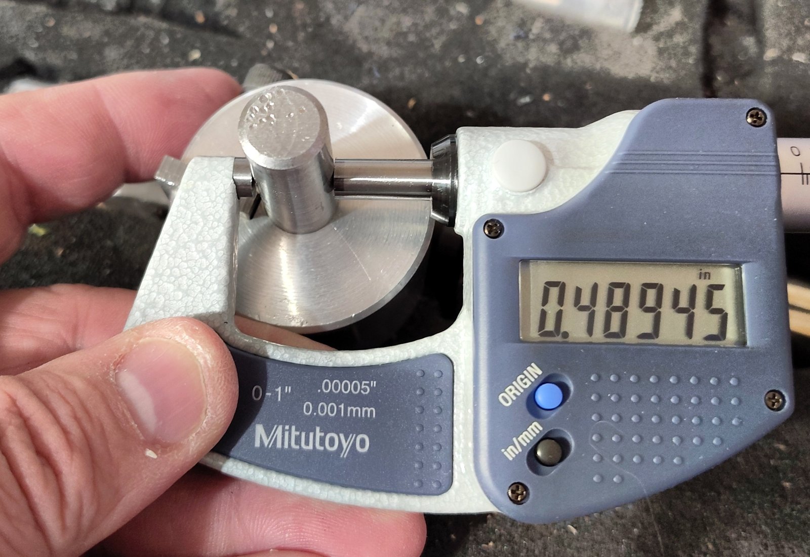

Do you have a micrometer, I'd like to get an accurate measurement of the shaft on the Hinze cutter, so far all my customers just had calipers. Calipers are fine for most things but I need a real precise measurement.

I think it is a great idea and if I wasn't mostly using my metal lathe now I would definitely get one for the Hinze Tenon Cutter.
If (when) I get into putting some sort of medallion in the cap or barrel finial, I could see wanting one or two for end mill holders.
Here is that measurement you are looking for. :)

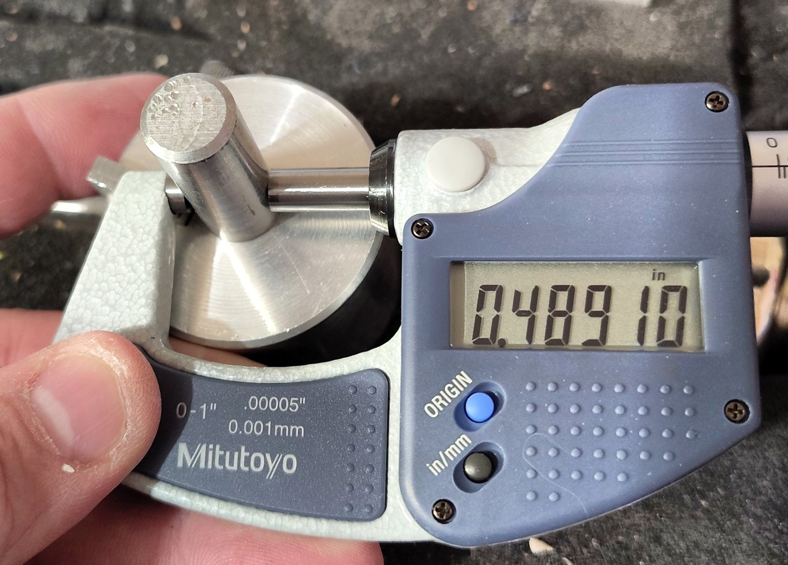

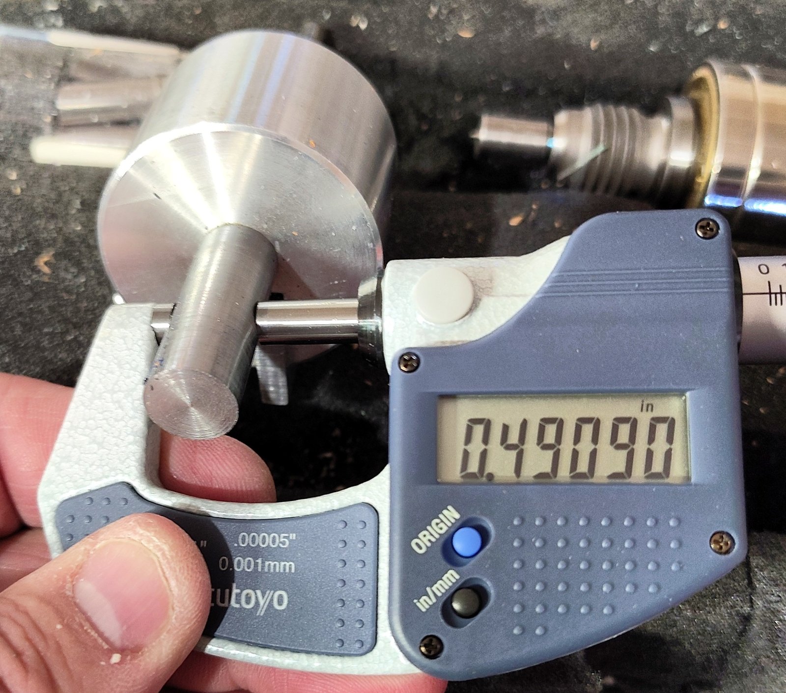

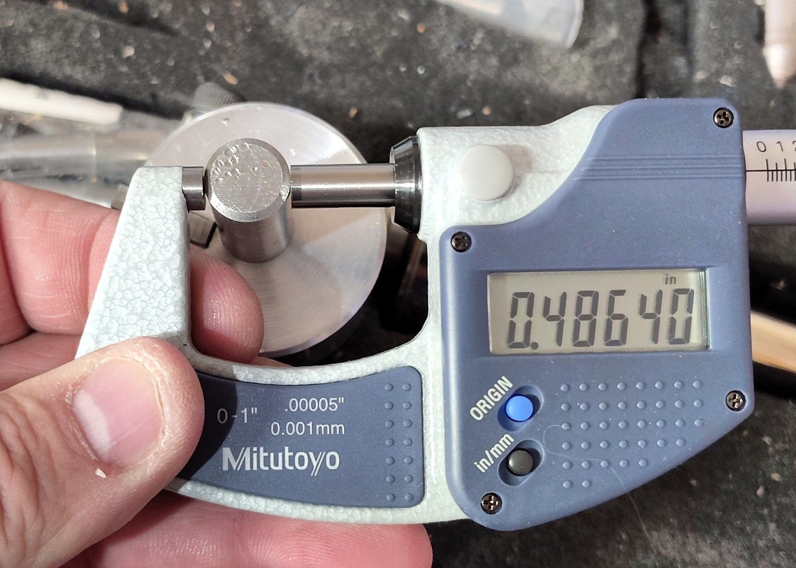

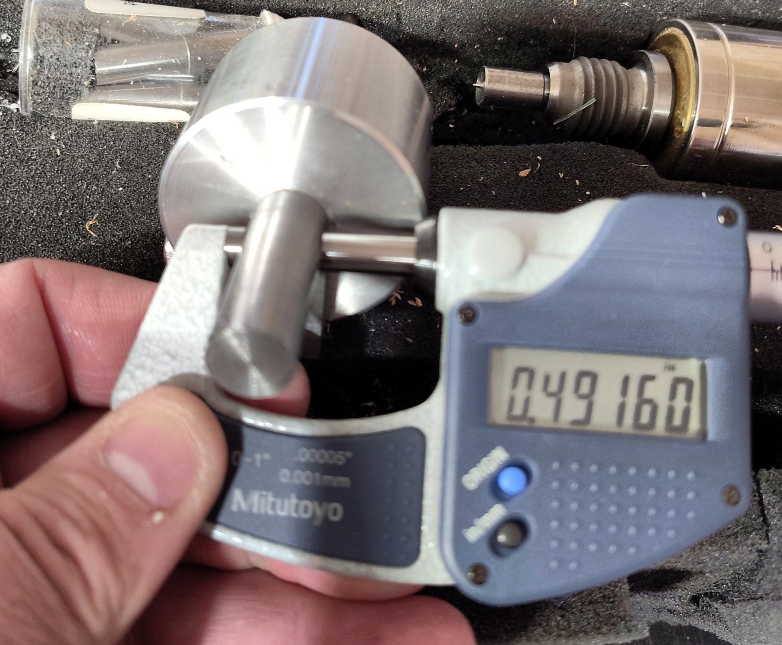

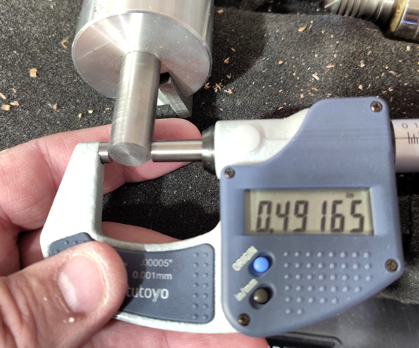

Morning Rick! I measured both of my hinze tendon cutters with a micrometer. (I have the same one pictured above).
They both measured differently.
I took three measurements on each: shaft base, middle and top.
