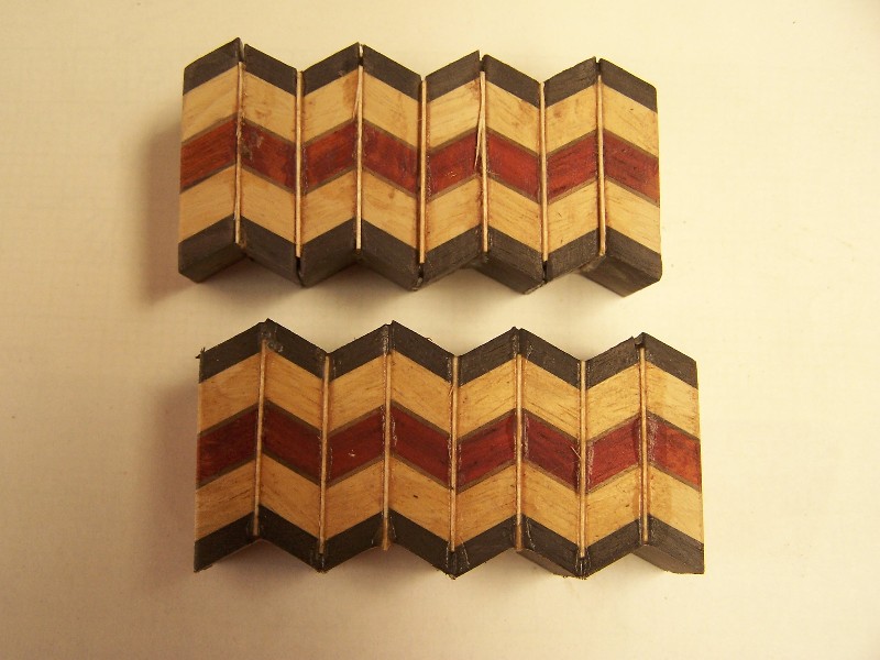

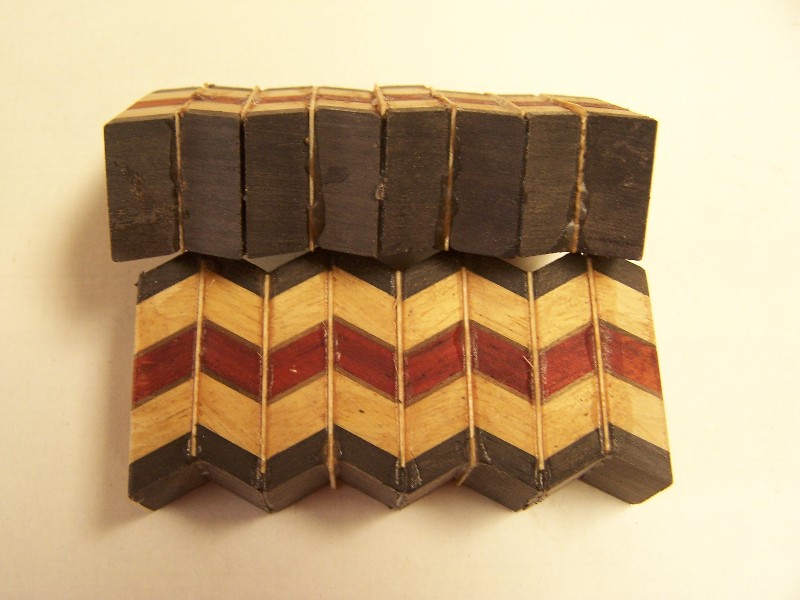

About 18 months to 2 years ago I tried to make some Black wood. I asked you guys and did a lot of reading about "Ebonising" but that seemed to revolve around ebonising after the shape was achieved, or just before the finish was applied.
I needed the wood to be totally black all the way through, so it could be worked and still remain black.
One of the things I was advised about was that Walnut wood was the best to ebonise because of the natural tannin in the wood.
In my first experiments, I used Queensland Walnut and soon realised that this wood is not Walnut at all, just a local name. So I purchased some Proper USA Walnut and cut it into strips of 3/16 and 1/4inch, I also decided to try some lovely creamy white Tasmanian Oak (Eucalyptus Regnans) just to see what would happen. The strips were put into a length of PVC pipe about 30inches long, Vinegar and dissolved steel wool was added and the pipes sealed for about a month/6 weeks.
By then I just couldn't wait any longer, every time I walked into my shed those pipes leapt out at me, so finally I opened them up and took out the black strips of wood.
I layed them out to dry and the following day cut a couple of them and found they were still the natural colour on the inside but very black on the outside. My heart sank with disappointment and the strips were set aside on the heap of scraps, until just before Christmas this year.
I decided to make another Segmented piece and needed some black wood. My first thought was to try and buy some, but then remembered the failed strips laying in the scrap heap. I dug one out and cut about 1inch off the end, then I cut the worst wobbly one in half.
YAHOO they were both completely black, as were all the others.:biggrin::biggrin::biggrin::biggrin:.

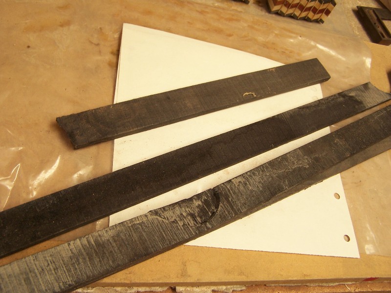

Here are a couple of photos.
Bob

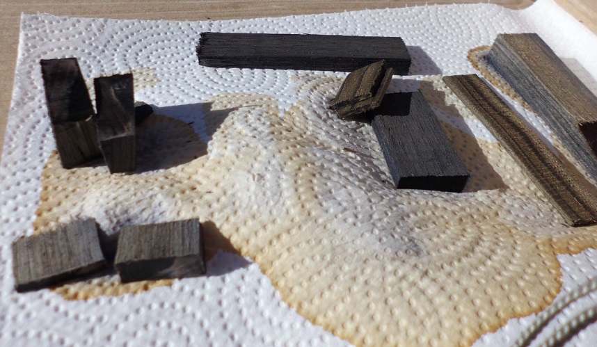

Started a trial last night ...
Took a small container full of ebonizing solution and I put in several odd shaped pieces of American Walnut as well as 2 small thin pieces of Eastern Redwood Cedar. I pulled a vacuum on the container with my Pump'n'Seal (I use this item regularly for vacuum marinating jerky... ) and forgot about it .... went to bed and just pulled the pieces out this morning.
Everything looks black on the outsides, waiting for them to dry before I start slicing anything open ... I'll cut 1 piece of each to see what they look like inside once they are dry today, and wait 2 weeks before I have another peek.

Two hours. About forty minutes vacuum time and then soaked for a little over an hour. These were dried first in a food dehydrator. They are now in the oven at 200 to force dry them as if I were stabilizing them. I'll cut one in a few hours to see what the center is like.
The towel is some sort of pale green color. They are about pen blank sized pieces I roughed out with a drawknife on my shave horse.
These are Walnut from my firewood pile.

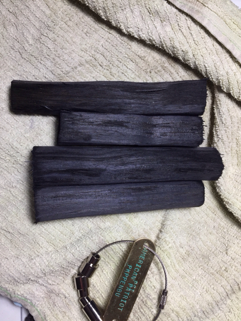

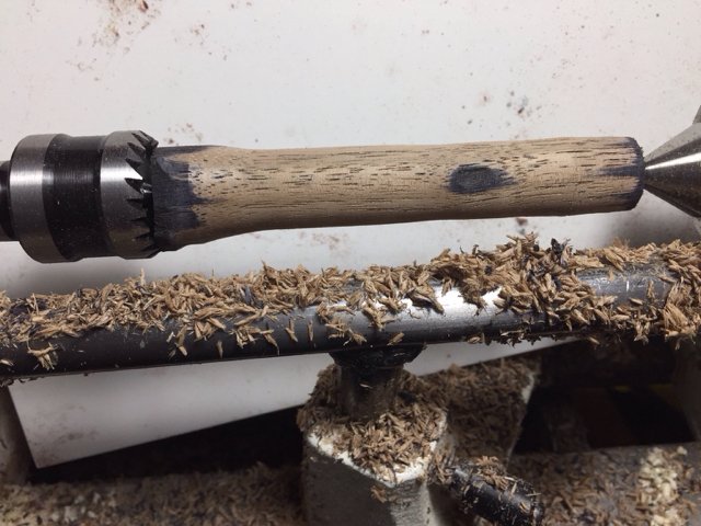

Here's what happened with my couple hour experiment.
This is really dense walnut from a very large old tree. It appears as though even under vacuum I got very little penetration. This wood is also rived or split with the grain rather than saw cut for maximum strength. I use it for chair parts, nice dense wood.

Yeah, that's about what I got first up, and that was after 4 - 6 weeks. I was so disheartened I left the pieces maybe 18 months, and they were black right through. I only soaked my strips, no pressure or vacuum.
Bob

Bob , don`t know if you have a stabilizing set-up or not , but I think maybe if you were to pull a good vacuum on the wood totally immersed in your solution for 4 hours or so until the bubbles stop , then release it and allow atmospheric pressure to force the liquid into the pores for a day , you might ? shorten the time frame from 2 years to a few months .
Mate, I wish I had a vacuum system.
Maybe next Christmas.
Bob
It won't pull a strong vacuum like a real vacuum system, but a foodsaver does a good job. I've used it with minwax stabilizer with considerable success. I have one that is only for the shop and another for the kitchen LOL. I use the canning jar attachment and submerge the pieces in the liquid then use the foodsaver to evacuate the jar. It seals with a regular canning jar lid.
