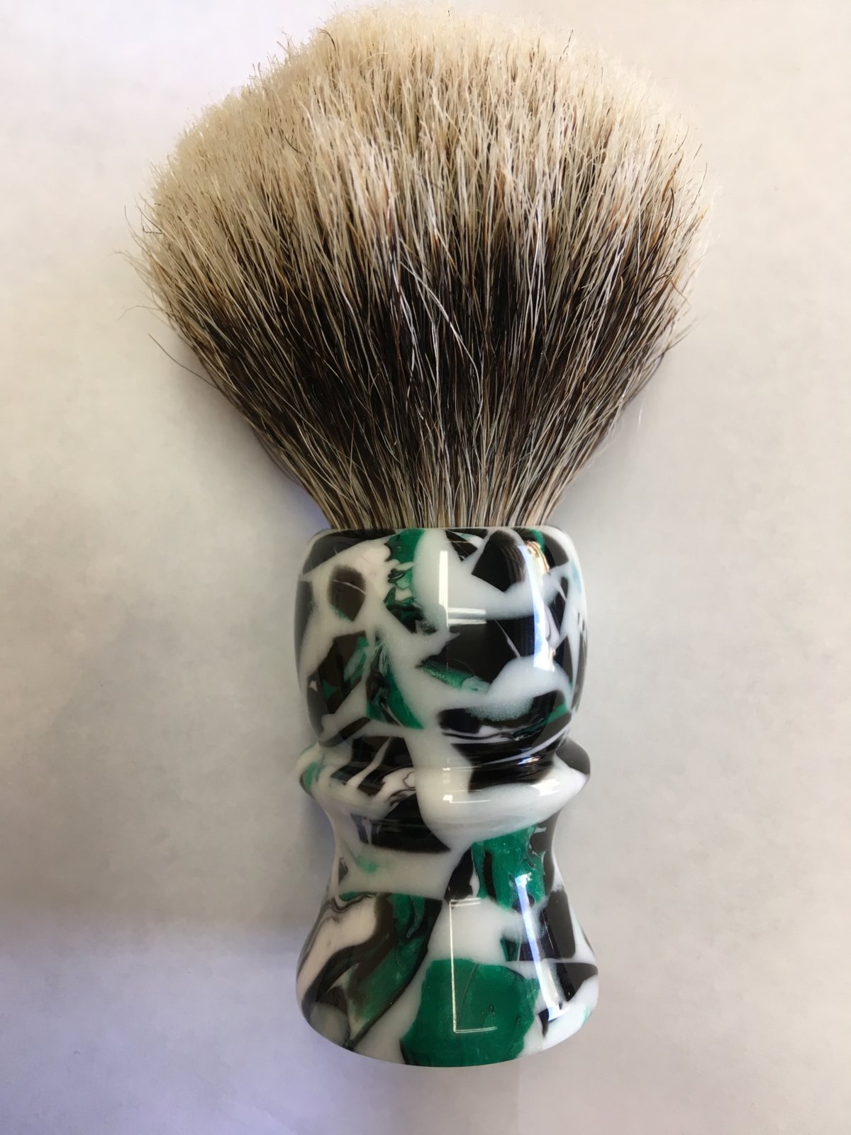

I put a blank in a plastic bag then busted it up with a 5lb sledge. After casting the pieces in white resin this is how it turned out. I think a blender would give similar results depend on how long you ground it up for.
