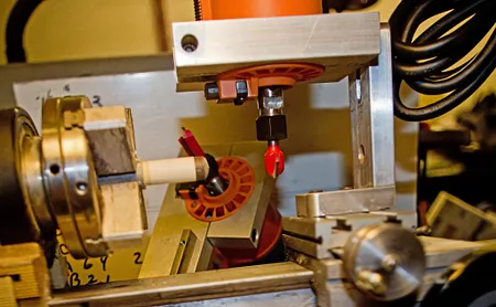

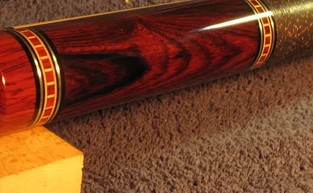

Mount a veneer trimmer on the tool post ( Live cutter ) use router bits or end mill cutting bits .
The end mills used to cut aluminum work good to.
Cutting wood ,, I use metal lathes with live cutters , I don't make any cuts that is not using a live cutter on the tool post .
I know several people who make veneer cutter mounts
Then get a indexer All this can be done with pretty much all metal or cue lathes
Could we get a better shot of the trimmer mount please. I might like to add it to my lathe.

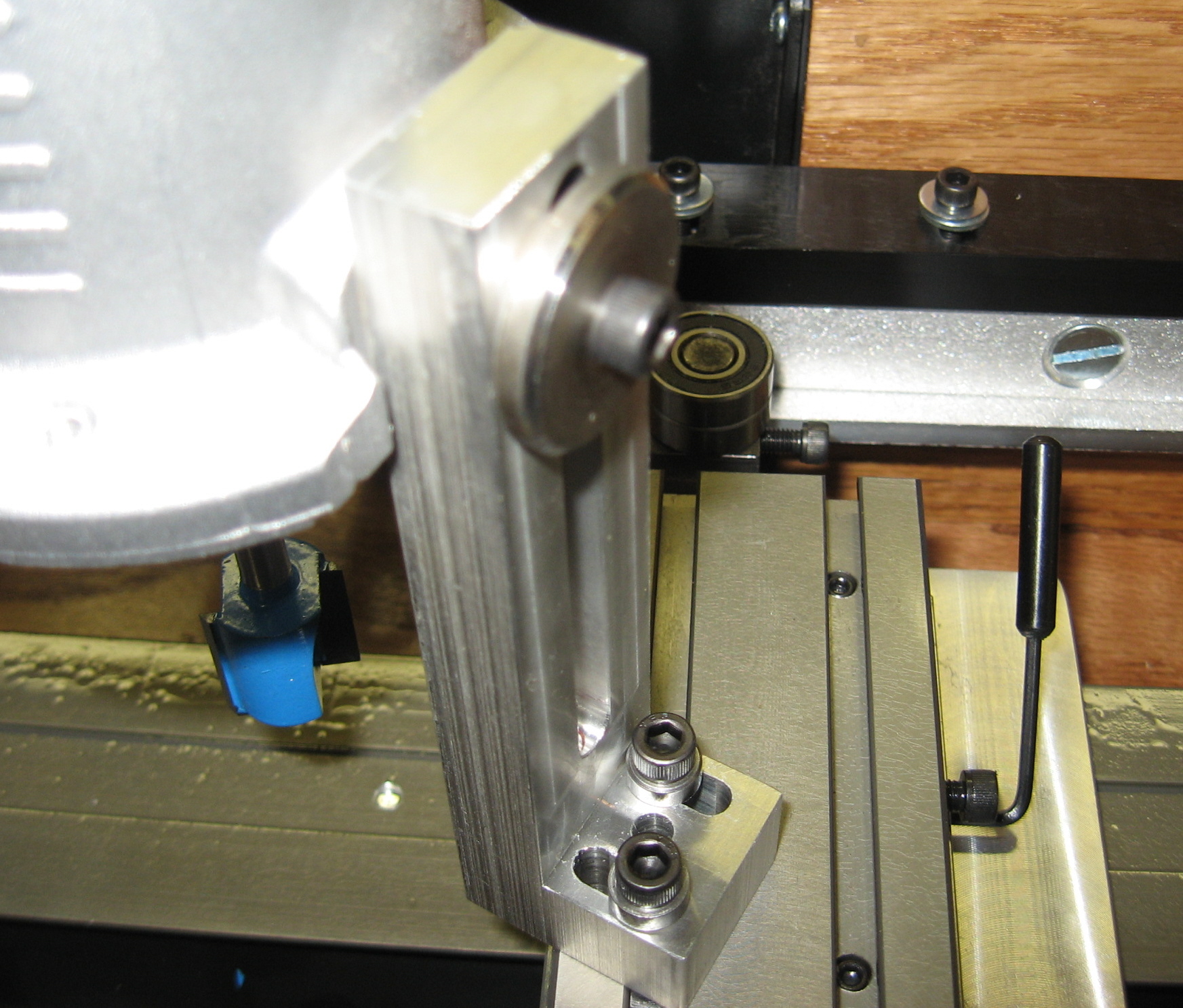

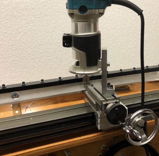

Which mounts you buy depends on the make of the veneer trimmer/router .
I like Ridgid but you can get Porta cable mounts to .
plus for making slotted trim rings need Dremel and a Dremel mount and a Indexer .
Indexer, the 24 holes drilled into the spindle pully
Grizzly will be different .
You should be able to make your own indexer
Make your own router mounts too .
Metal lathe is one of the only machines in the world that can make itself /
Mid American cue lathes .
Cue man billiards
Dremel mount but the dremel normally burns the slots .
Pipe inlay 12 slot trim rings
Cue inlay 24 slot with metal rings
