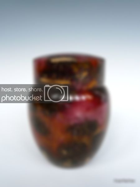

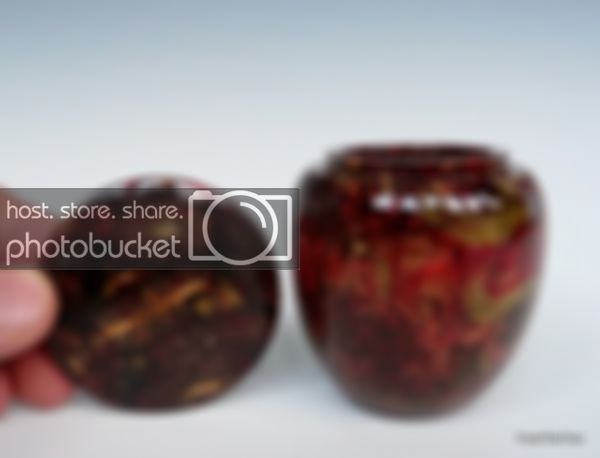

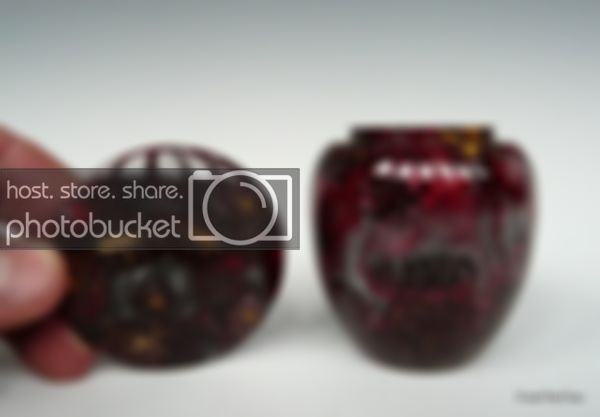

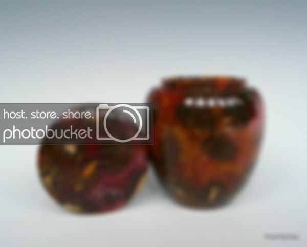

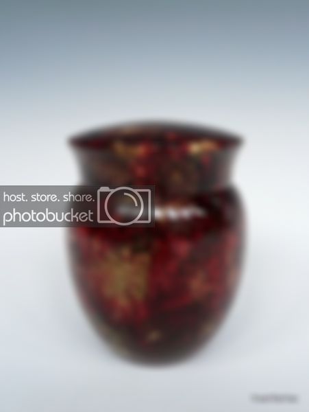

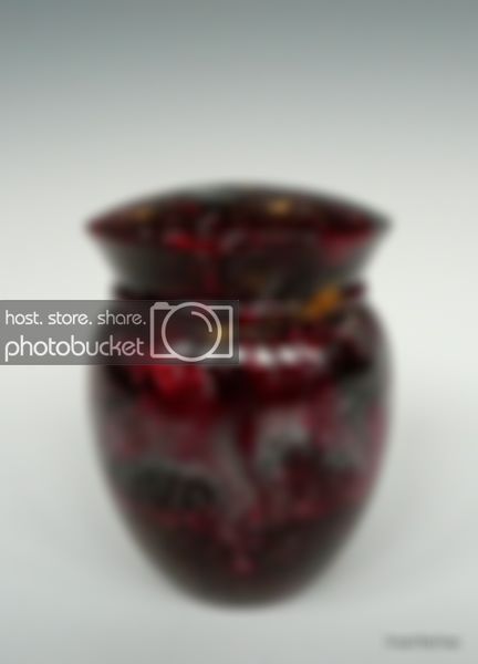

Hello folks
here are three new boxes
I cast the blanks last week and have turned these in my spare time over the past few days
the boxes are all around 60mm wide by 85mm tall
