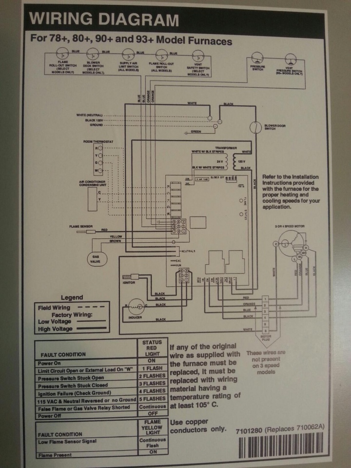

Okay, found the wiring diagram and FINALLY the legend. 4 flashes ignition failure, check ground. rps20150219_222236_467.jpg

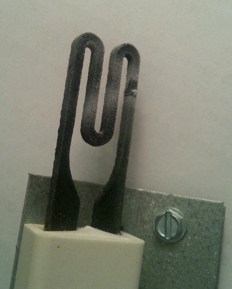

I got the igniter out and there is a crack in it. It doesn't heat up or glow, so I'm searching for a 24 hour parts place. No luck so far...

If it is the igniter, make sure you have as close to exact replacement as possible. The wrong igniter can cause explosion!!
